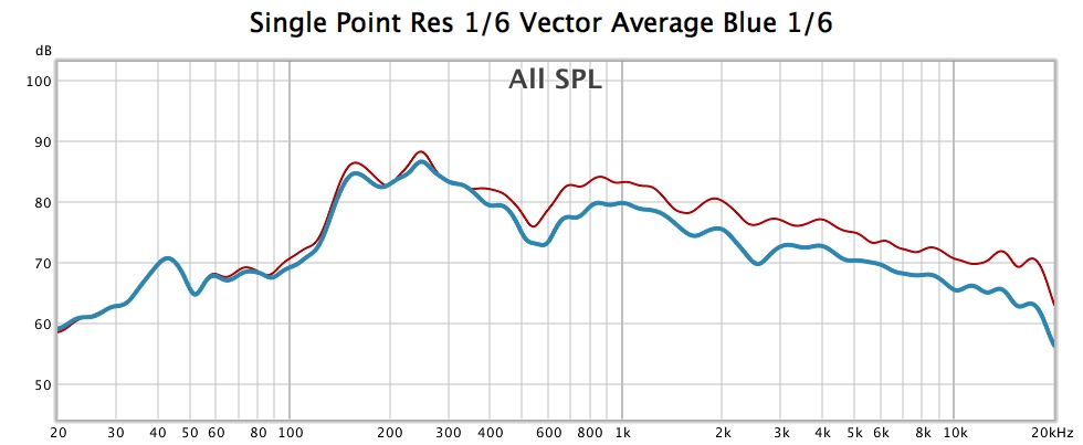

This is the difference between the two with 1/6 Octave smoothing, var smoothing will give greater resolution in the bass, FDW's have similar trends to the smoothed graphs.
What it says to me is that the room adds sound above transition fairly evenly and some of the dips are filled in by the reflections, others are created. It's another way of looking at the data to see if you can get an answer on where to target processing.
I like that you don't need as much smoothing to see the general trend of the graph.
These were taken in an untreated room so they are a worst case scenario.

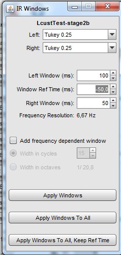

In order to see the pré ringing quickly I often use a gating window in REW that zooms in on everything before the peak, something like this:
(I probably have mentioned this before)
Don't use any smoothing (not even 1/48 octave) or FDW's.

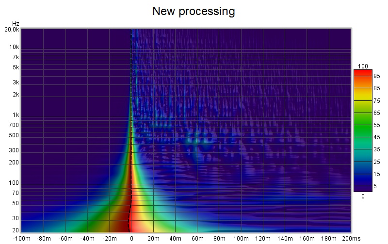

By the way, this train of thought was inspired by published wavelets from nc535. Keep posting your results guys, lets advance our results together!

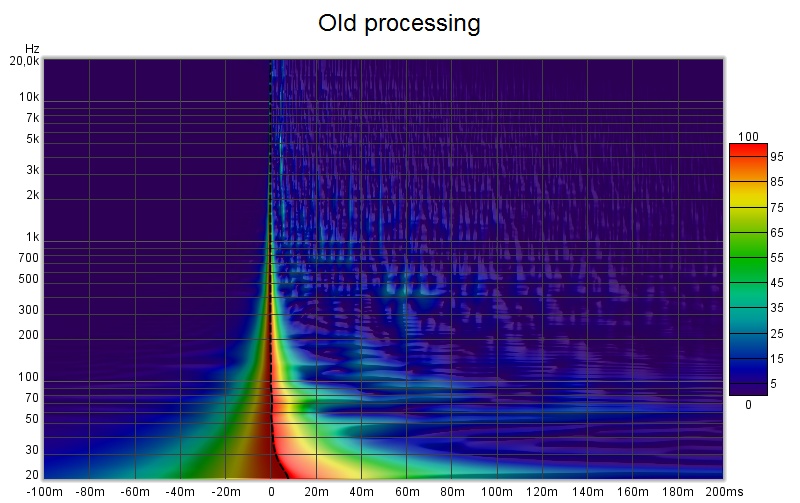

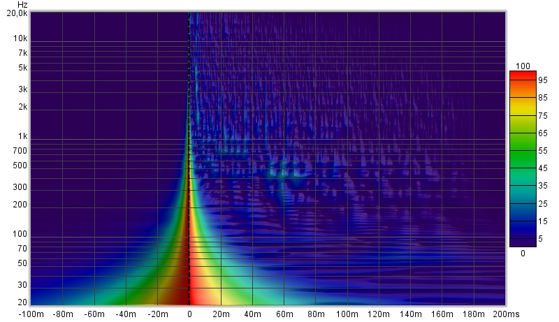

Pictures are worth more than words I guess, lets see a comparison:
Don't mind the differences in phase, curvature etc... that's still to be solved. The second graph is extending flat all the way to 10 Hz, that still needs fixing.
Look at the deep purple/blue sea to the left of the peak instead. That's where the mayor differences are.

Here's the final shape of the flat target (flat out to at least 10 Hz). It won't ever be run like this, it is just the first step of separating the processing from the target EQ.
This way it becomes easier to EQ to a target/room curve with IIR PEQ. Similar to EQ-ing a driver flat and then applying the crossover 😉.
I've spend lots of time to find the way to do it while minimising the pré ringing compared to earlier attempts.
Next step is to do the same with an averaged multipoint measurement. I'll first try it out on earlier (averaged) measurements,

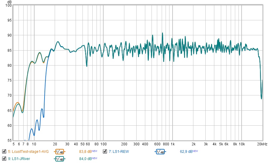

I'll compare the DRC predictions with convolution in REW (A * B) and JRiver virtual run through and pick one to go with. Both REW and JRiver will need the mic compensation applied.
I've just done this test. The FR curve of DRC (predicted) and JRiver with Mic compensation are more or less identical. REW's (A * B) result only differs below 20 Hz.
The interesting part is, REW and JRiver agree on phase timing, while DRC's prediction slightly differs from that.
This leads me to my conclusion that I'll continue to use (and trust in) JRiver's virtual runs. The differences are small, it won't change things much, but when optimising things you've got to pick one or the other anyway. The JRiver way is the slowest and most time consuming for me to use, but I'll take it anyway.
Much of the work I've done so far will still be mostly valid for the JRiver runs (like the RePhase edits etc.)
