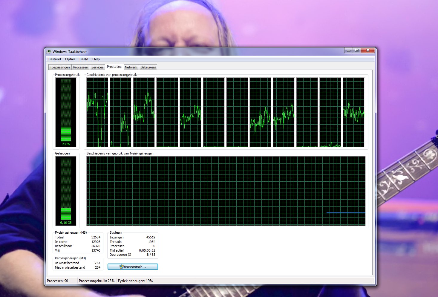

I took my time installing the new Workstation, making sure I get the performance I want from it. Pretty happy with this setup thus far.
23% processor while running 6 channels of audio + DSP and MadVR for video rendering. Clear to see why I opted for more cores .
More than enough memory available for other tasks. Overkill, just the way I like it.
Next up is installing all other apps I need, like Autodesk Inventor etc. then on to loop-back tests.

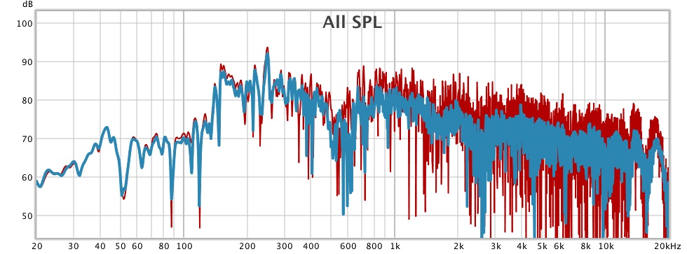

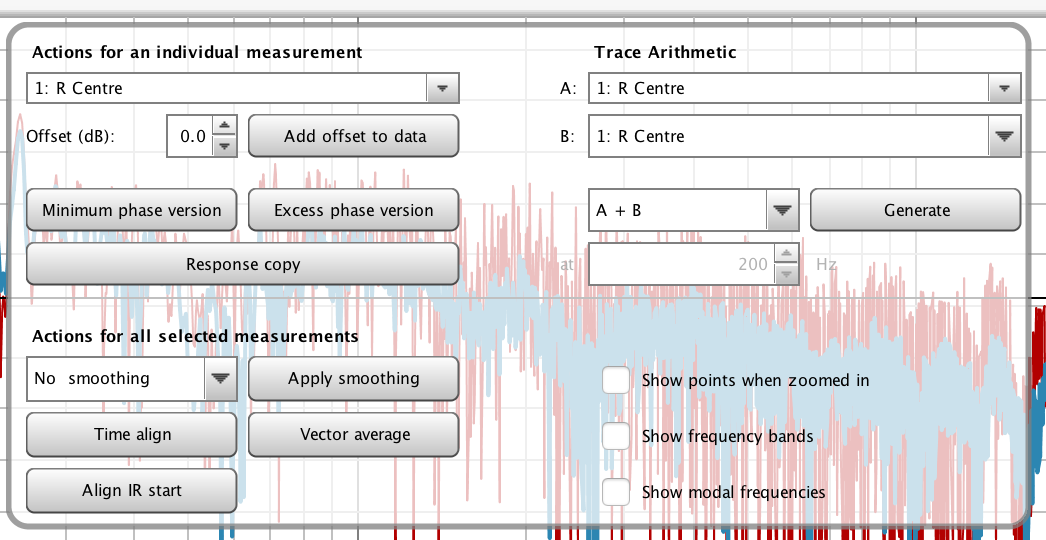

Vector averaging gives you both in one go, take as many measurements as you like hit time align then vector average in REW
Here is the difference between a single measurement and 9 vector averaged you can see the room contribution above transition has been reduced quite significantly.

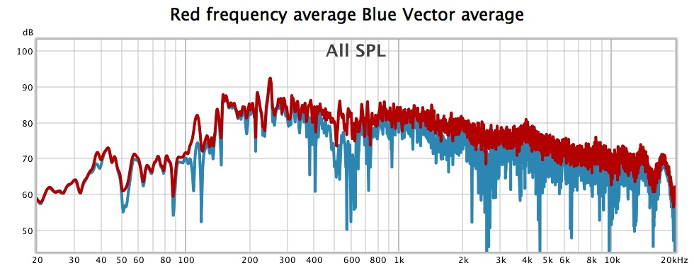

This is the difference between a frequency average in red and a vector average in blue, the bass doesn't follow the single so well and the high frequencies remain higher due to room contribution remaining steady.
I found different vertical measurements to be a waste of time with the arrays due to the directivity of them in this plane, i'm sure for a standard speaker it makes more sense.

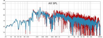

Yes, averages work great to reduce room effects compared to single point measurements. But I'm less interested in that as a goal. I want to use the averages to sort out the speaker's specific behaviour. Reduce the effects of combing dips and diffraction. The room is dealt with the best I can do in a normal living room. Early reflections have been reduced quite a bit. But we have this huge number of drivers that combine at the ear. This in itself sums a little different at each microphone position, way less than most would assume, but it's there. By averaging around the ear positions, going in every direction and not in a fixed distance pattern I want to sort out and smooth the dips created by the combing and/or diffraction effects. So even differences in the vertical plane are of interest to me, be it only small distances (less than the center to center distance or slightly more).
The pattern that will remain after those averages will be the base for processing and limits the number of narrow boost peaks normally originating from a spot specific measurement.

Our posts crossed over so the graphs were aimed at nc535. As your room treatment and listening position are set you'll only need to take those measurements once. Taking 25 odd measurements takes quite some time and is pretty tedious, so I tried to find the most useful measurements as I was likely to have to repeat the process again. Vertical much less difference than horizontal, if you didn't put too much time into mic placement you would likely get a reasonable spread of vertical spacing anyway
