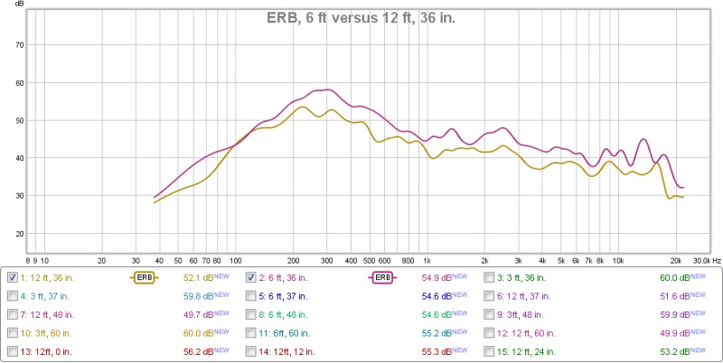

I'm at 2.8 meter distance from each array (mic measurement position). The arrays are 2.8 meter apart. The actual listening position varies if I sit upright on the edge of the couch (mic position) or have a more relax position.
In critical mode I'm sitting upright where the mic is, leaning back (meaning closer to back wall) I do get a bit more bass, just a hair.
All the stuff like "2x height of towers away" does not really fly with floor to ceiling full range speakers i.m.h.o.
I'm in the near field for my listening spot, or at least I consider it like that. Especially if we apply the theory of "mirror images of floor and ceiling" like Don Keele.
Don't judge the the center to center spacing of the drivers only without also thinking a bit further. In this case the driver to ear distance is at least as important with all drivers playing the same material. I do not think a pure cylindrical wave front exists in these arrays as in the pure theoretical versions. Yet the drop of with increasing distance comes quite close to following the 3 dB/double distance rule of thumb.
Look at ra7's 3 ft, 6 ft and 12 ft measurements to see how 3 ft is way to close and the response gets better on the top end by increasing the listening distance to the arrays. There's already a world of difference between 3 ft and 6 ft.
He also proved moving up and down at the listening spot has little to no ill effects. This one is impressive though, comparing 6 ft to 12 ft and having the two only vary a few dB here and there (these are raw measurements):
(image and measurement from ra7's corner arrays)
That image shows there's merit to using full range floor to ceiling line arrays at a relatively short listening distance (6 ft or 1.8 meter). Getting further away is moving the comb effect further up in frequency.
"In essence, the low frequencies "roll-off" quicker then the highs at longer distances."
This statement is reversed, high frequencies drop much faster with distance. In-room not a real issue but this is always something you have to deal with with outdoor live events.

If you want to cut some low end, try this:
Load your corrected response into REW and (using the EQ) set the LF cutoff to 20hz. Now, tune a PEQ to 20hz with a Q of .71 and -3db gain. The bottom end will now be non-resonant, and at medium to high SPL you should still have some nice presence at 20hz (now the -6db point). I do this at 35hz for my system and run this "low end target filter" in a separate convolver. If you can only use one convovler, then of course you'll have to convolve the REW filter with the DRC filter.
