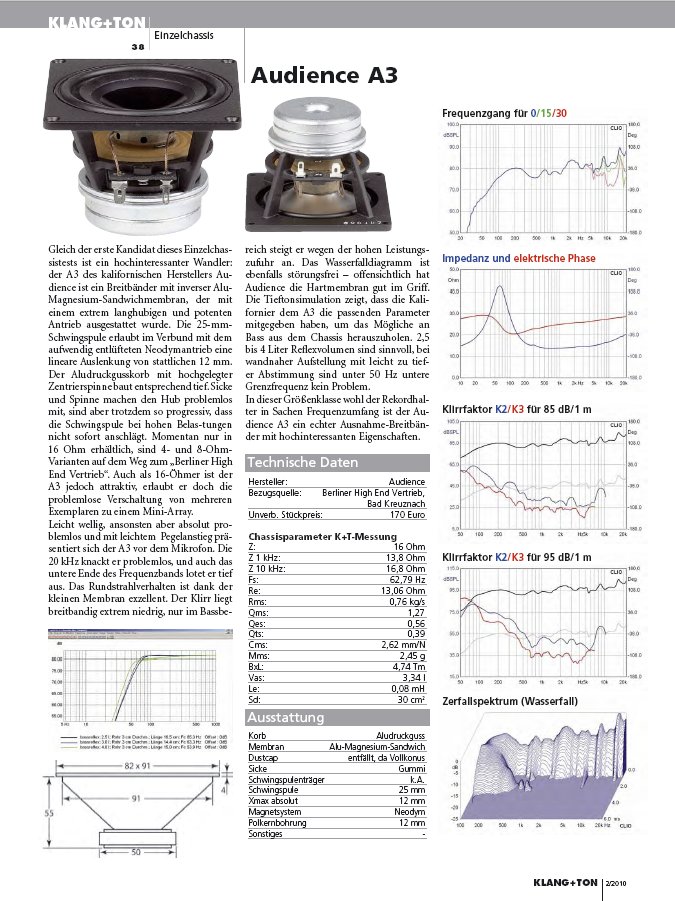

If I had the time to do it right now I would build Ron some new drivers with much more excursion so he could have his cake and eat it to on the low end.
I think I would love that! Sort of like the Audience A3 mini-monster drivers with 12 mm x-max 😱.
attachment.php
Too bad their distortion graphs don't really show they are worth their hefty price tag. I believe you can't buy them anymore anyway.

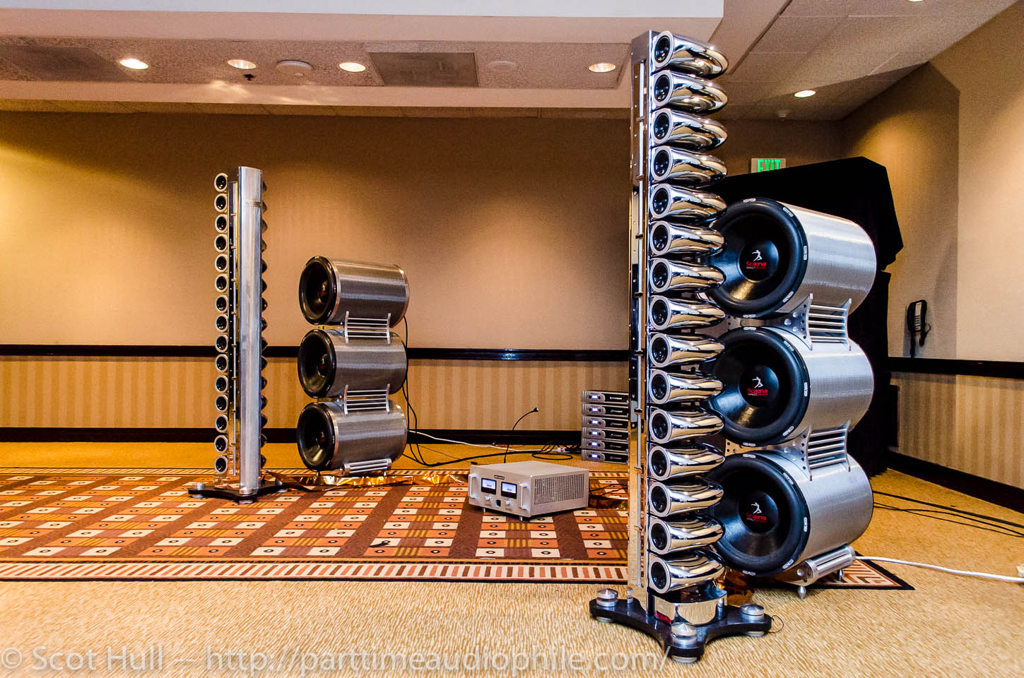

Peter,
I'm sure you are familiar with the Scaena line arrays.
attachment.php
Did you ever try to cross over like they did? If I recall correctly they don't have any crossover on the woofer line's top end and use a single cap for the tweeter line. At least that's what stuck in my mind. They do cross a lot higher than 2 KHz, they let the woofers top end roll of by itself (if I'm remembering that correctly). They do use processing on the big bass units.

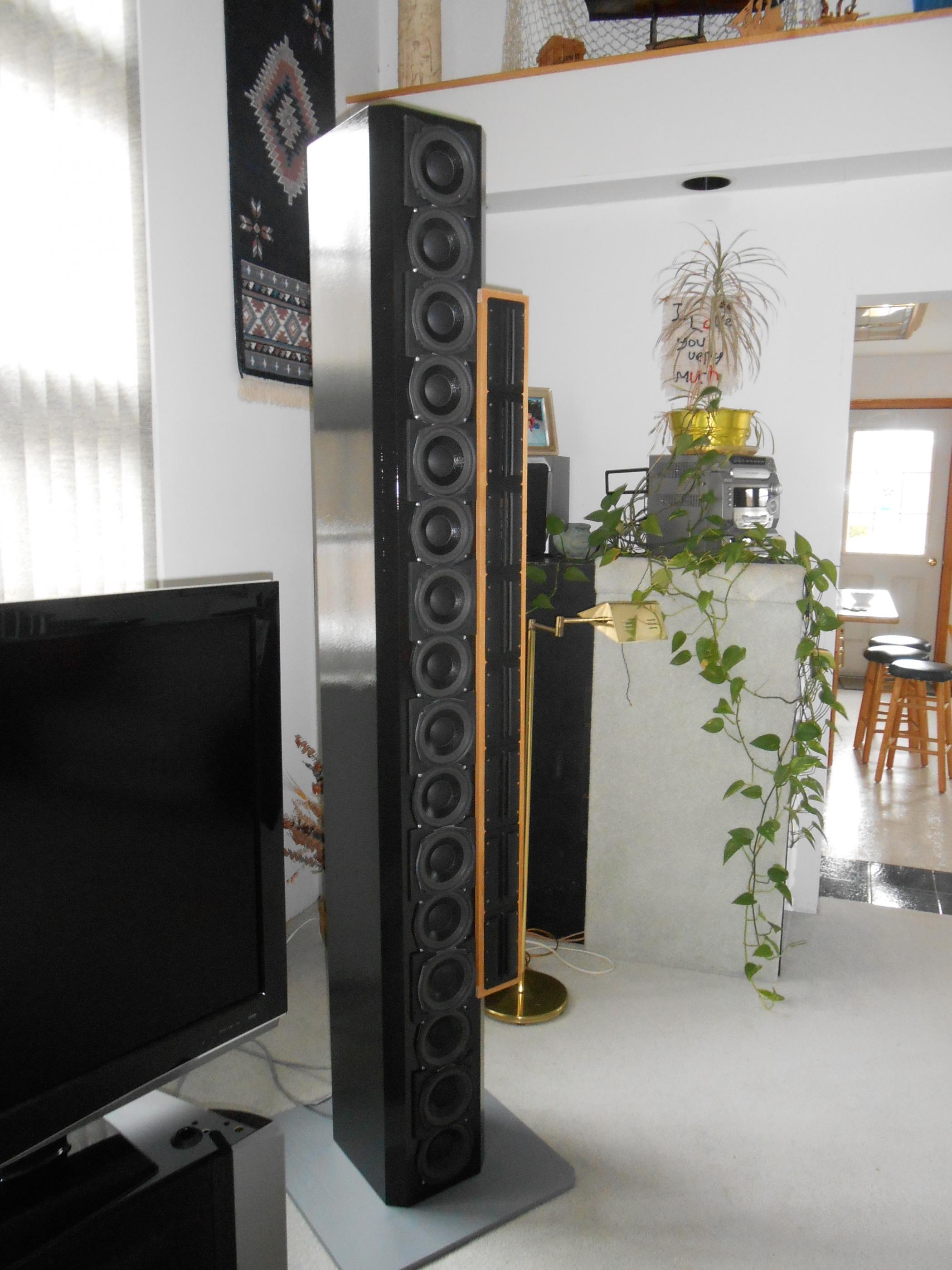

My first conclusion; Yikes! That exit looks blocked!
My thoughts regarding allowing my bass cabinets to roll off at the top end on their own; Would that not create all kinds of interference patterns in the 150 to 1000 Hz range?
I am afraid to admit the some 'high level' sessions have resulted in having to raise my bass to mid crossover point to 150 Hz. The 18 inch RCF Bass drivers still have some significant output at 1 k. Now that I think about it, a steeper crossover would allow me to lower that crossover point. My mid drivers were relatively inexpensive; consequently, they have an X max of only 3.6 mm and 35 Watts RMS. The mids are being driven by a Phase Linear 700B. I have had to replace several drivers before raising my X-over point. Damage was a result of over-excursion, rather than thermal overload.

Hi Ron;
Thanks for your patience, and pardon me, I have not read through this extensive thread, but I intend to!
At the risk of testing your patience further, the above diagram showing the distance to the drivers increasing, above and below the horizontal, would this only be the case (radiation path) when drivers are operating as individual point sources? I would have thought that in line array mode, the wave front propagates as one cylindrical front and therefore cancellation between drivers at centre and extremes is not an issue.
Yes, I am concerned that a crossover (point) particularly at the critical 2 kHz range is introducing a number of issues. In use, I have not pin-pointed any issues with nodes on the side to side plane. Admittedly, they may be masked by bigger issues. This is another motivation to consider a steeper crossover.
I think I will relax my "cancellation" issues before I burn any more bridges! You are obviously a huge line array knowledge resource, so again, I apologized for the jagged leading edge of my learning curve,
Thanks, Peter

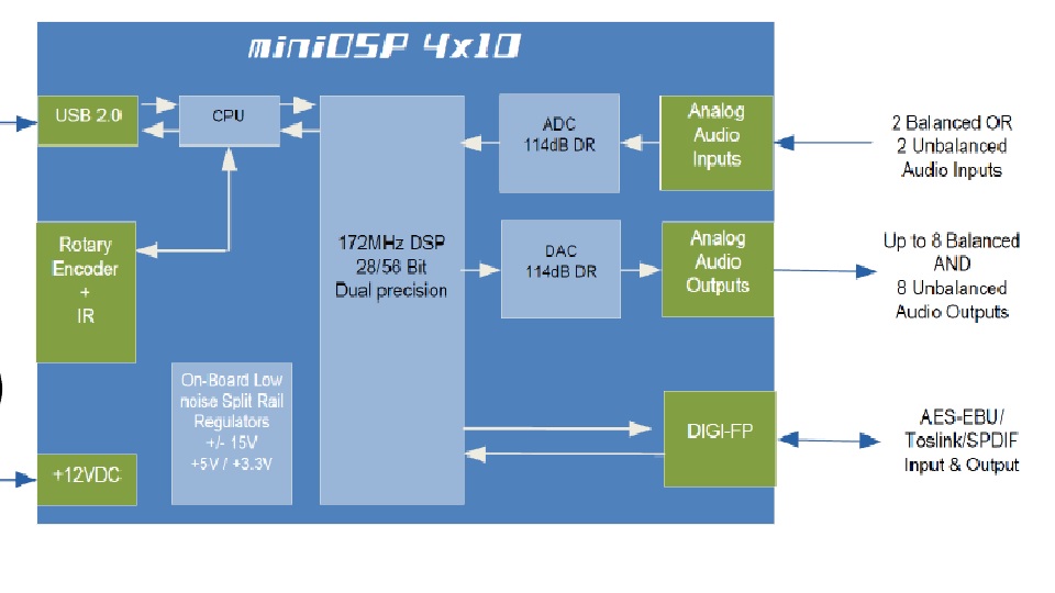

At one point, I purchased a rather expensive 'digital' equalizer (Rane DEQ-60L). After someone pointed out that a digital source (CD) was going from D to A to D and then A again, I retired this unit and went back to an older analogue EQ.
I am considering the miniDSP 4x10 HD, but have not researched it. At first glance, it seems like the ideal solution.
But don't the miniDSP products also go D/A/D/A as well?
Best way to avoid all those D/A conversion is to use a computer and an app like JRiver or Audirvana. Let's all those DSP filters apply on the digital side, before analogue conversion. Connect that to a nice DAC and it will sound great.
I am in way over my head here but from my interpretation of the signal path block diagram; Could I not connect my CD player (digital output) or my laptop (via usb) to the DSP. Please correct me but it appears to me to go through only one D to A conversion, right at the outputs.
Thanks, Peter
If you are using a laptop, you don't need the miniDSP. JRiver will do anything that the miniDSP will do (and much more). At $50, it's a better bargain than the $500 unit you are looking for.
With the Mini DSP product You are considering, You can hook up your CD and DVD players using the SPDIF or Tolink (optical) inputs. If I recall, the USB input is for data only, it is what You use to upload your DSP filters (cross-overs, EQ, delay, etc) to the 172 MHz DSP processor. So You can not stream audio from your lap top to this USB input. But You can use your laptop to create your filters to upload to the miniDSP.
If You connect your CD player's digital ouptut, You would only have one D to A conversion at the outputs. :up:
