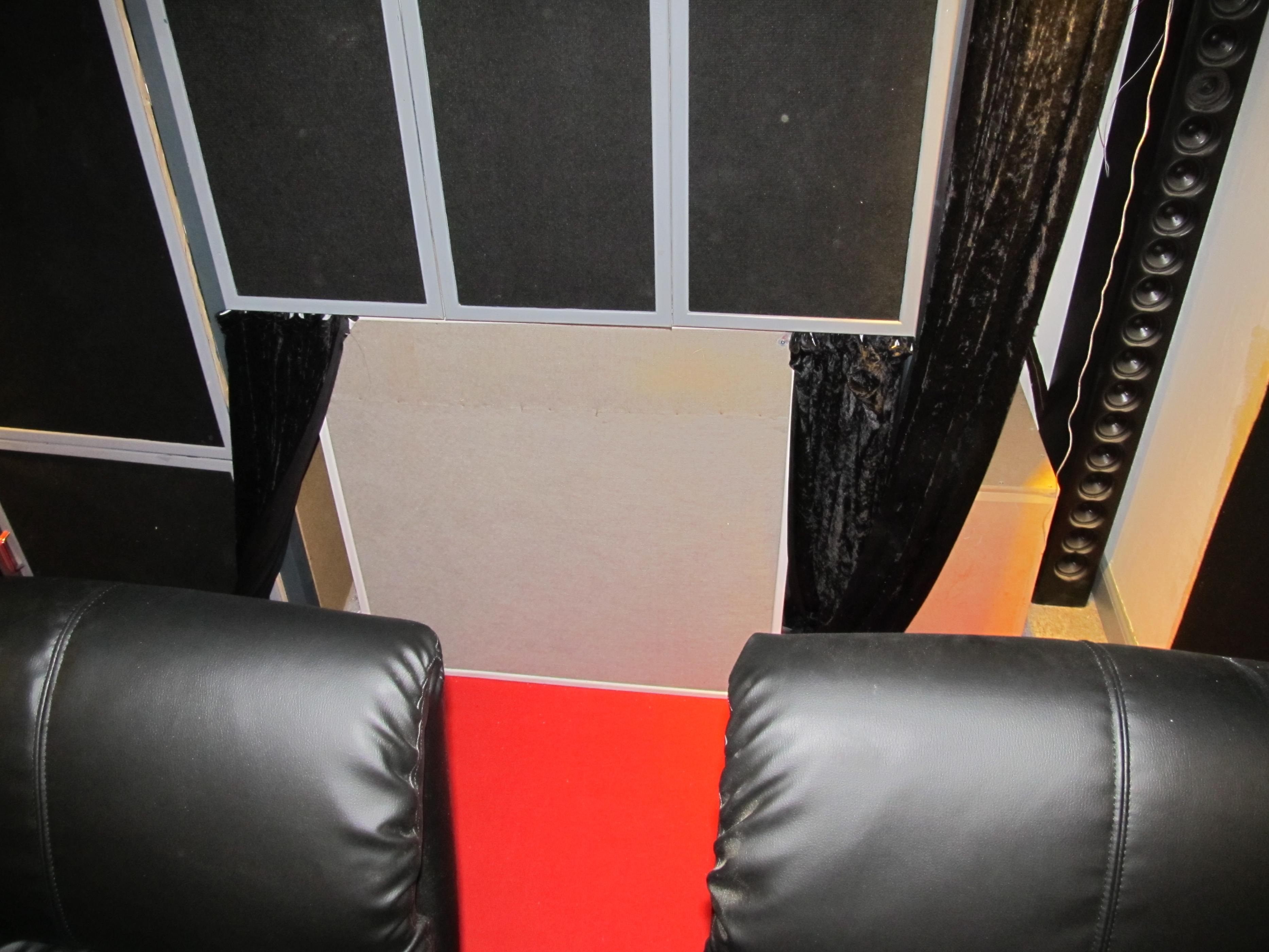

Both the sub in the ht room and in my stereo are firing into a corner.
You can see the sub in the first picture. It is the gray box. I use the arrays as rear speakers as the front speakers are hidden behind the audio transparent screen

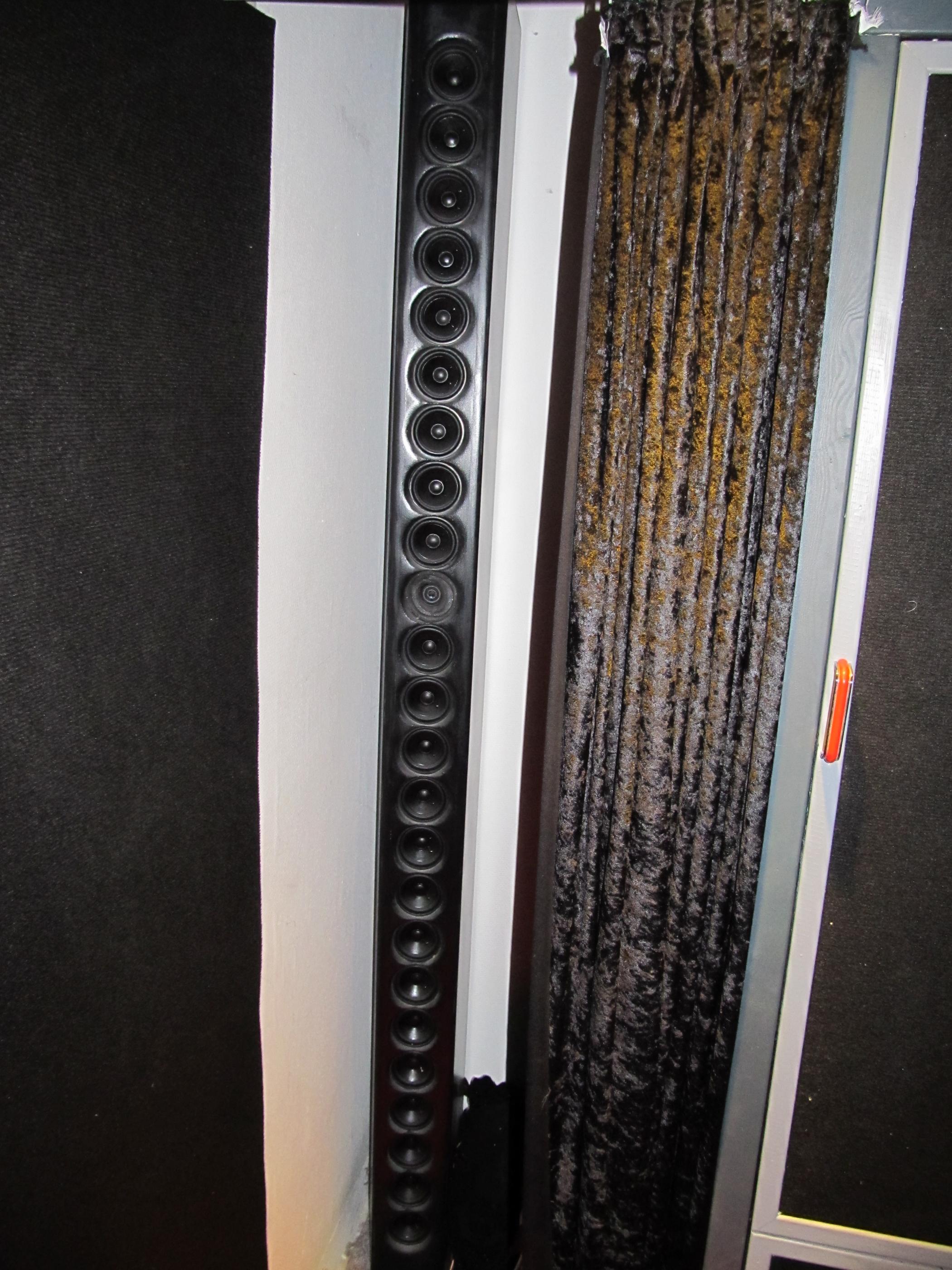

The arrays have similar Sd area of a 15+" sub, but spread that out over a large area from floor to ceiling. This evens out the bass response out in the room. You'd probably need multiple subs to achieve something remotely similar. I do expect to see those differences in an APL plot. It will probably show a more scattered result if you look at one or 2 subs in an APL plot unless you have a well behaved/treated room.
