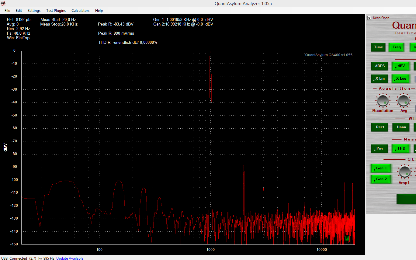

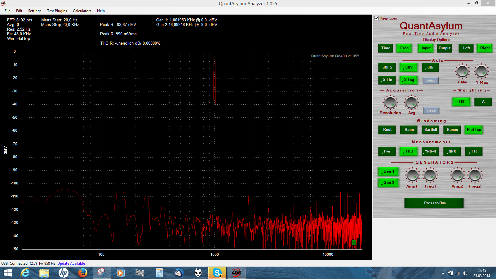

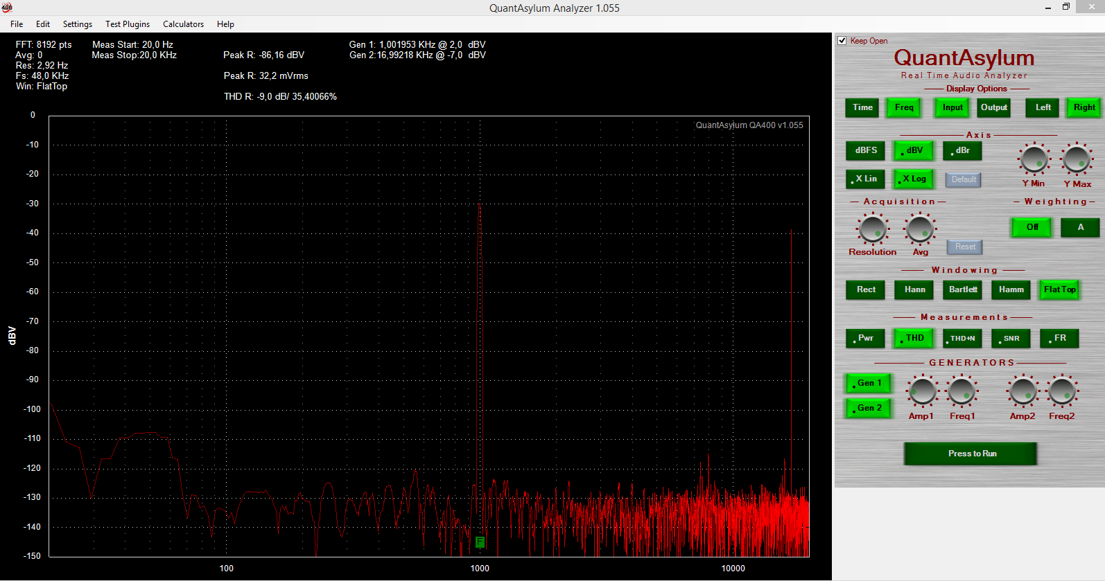

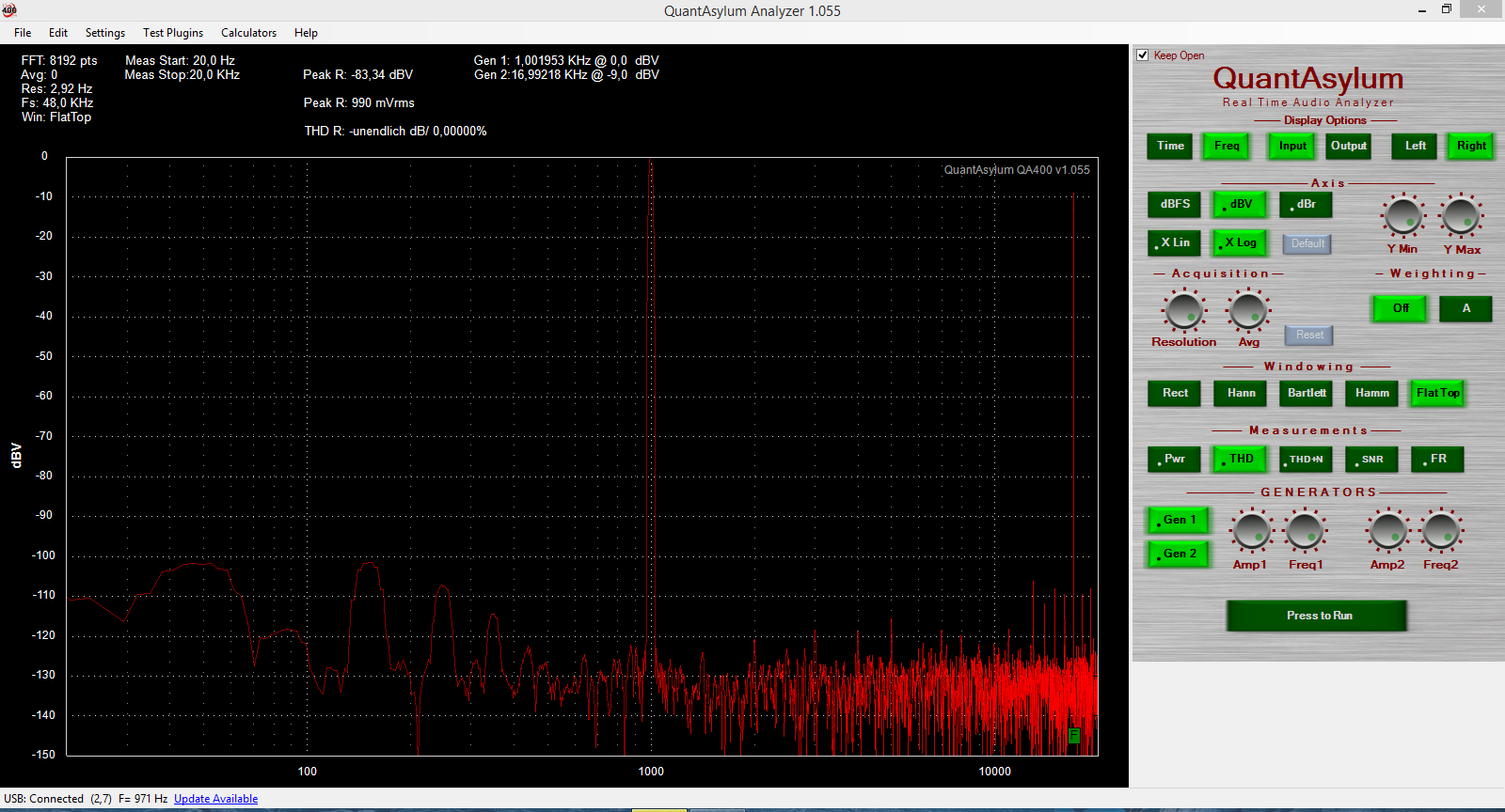

The buffer can be trimmed for minuscule distortion.
The distortion cancelation can be even so high that i suppress 2nd harmonic in my analyser !
The best copy of the input signal is at 250 Ohm ( rather high, there was 1 56 Ohm before,
i only tested higher values but i will also try to lower the 56 Ohm ).
The best cancelation of the analyzer happens at 470 Ohm.
From left to right :
Kean buff without distortion trim, with analyzer cancelation, best copy of the input signal.
