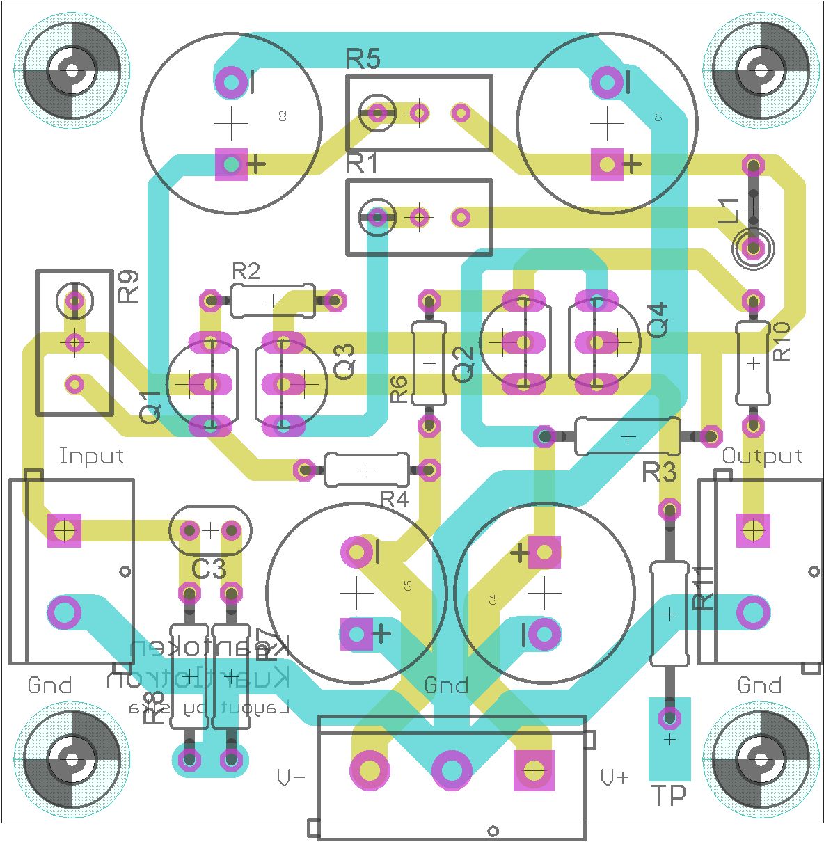

I did not find the time to research why my build needs such a high value cancelation resistor but i solved another problem that bugged me since i build the first version :

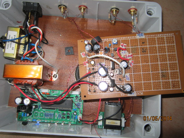

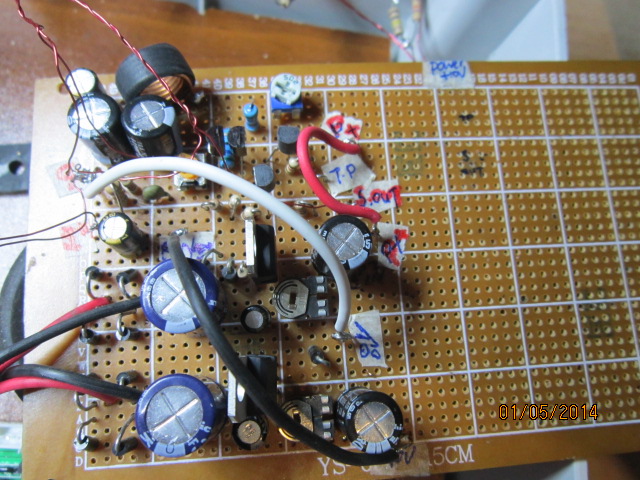

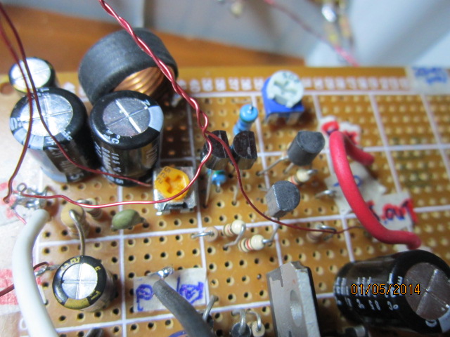

I build one channel with point to point. in fact this is the secong build point to point and both have very similiar problems.

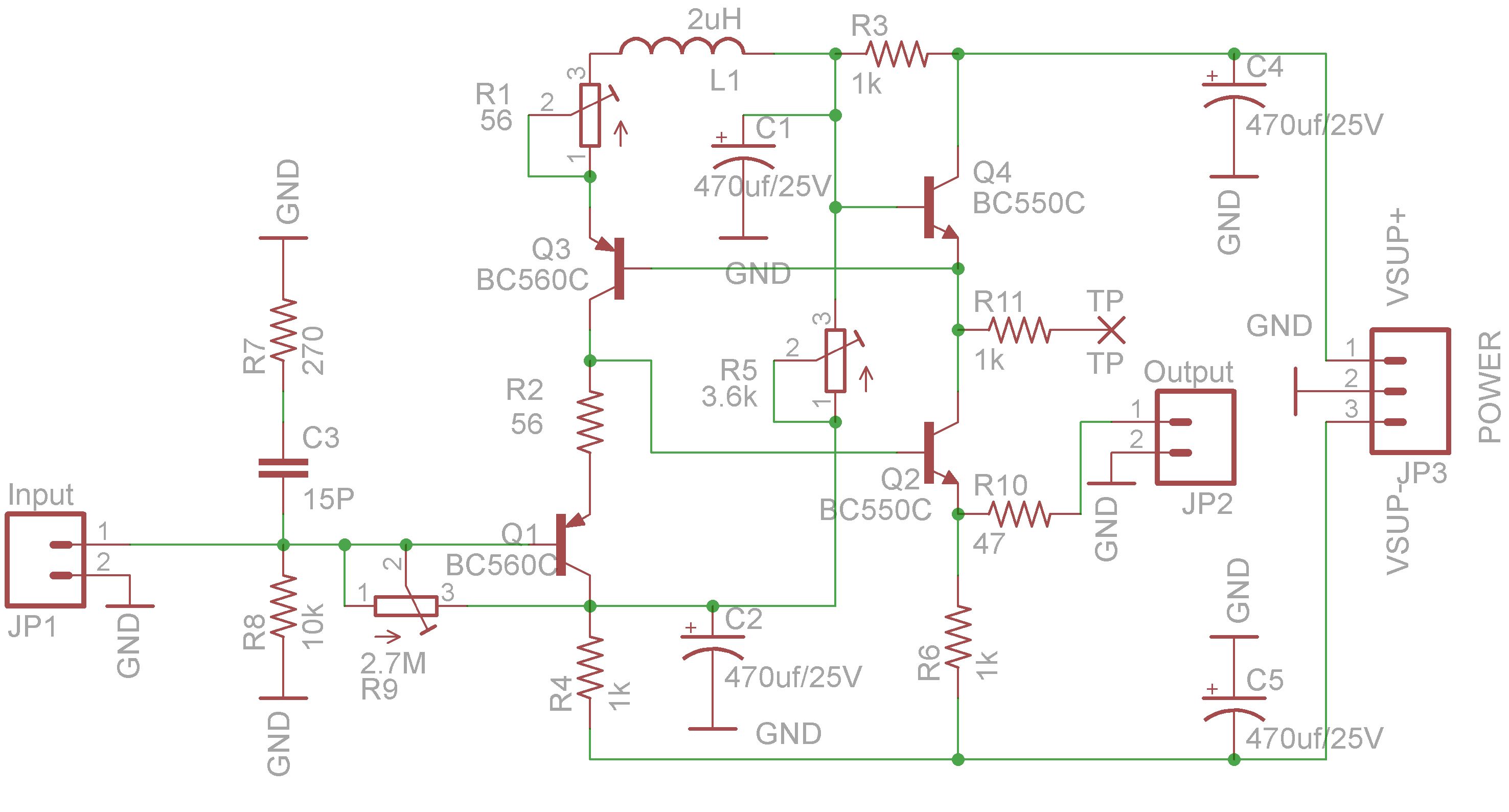

the circuit is from the keantokean blog page as stated in the beginning of the thread.
There is a constant hump that increases with volume and changes when the input leads and volume control are touched.
Power supply is with 2 LM 317. output V is +/- 10V.
Transistors are BC 550 c and 560c. Different brand . R1 , R2 are both 56 R.
Vbe at Q3 is 61Mv. Vbe at Q4 is 68 Mv. Tp measure 5 v after trimming.
Output offset is 6 mv .
Hearing through the humming, the sound is very good and no obvious distortion.
Any suggestions to solve the humming sound.??
Anyway to troubleshoot without analayser. ??
Do i need a gate stopper at Q1?
could be the Inductor --wrong spec ?? . i salvage this from somewhere and is this value critical ?? the previous version is self wound ---15 turns over a AA battery .
I am building this to power a class D amp with an input impedance of about 10 K. This amp has too much gain and hence i have a voltage divider before the volume control. The remote for the volume is bought from ebay .
please excuse for an untidy build.
cheers
kp93300
