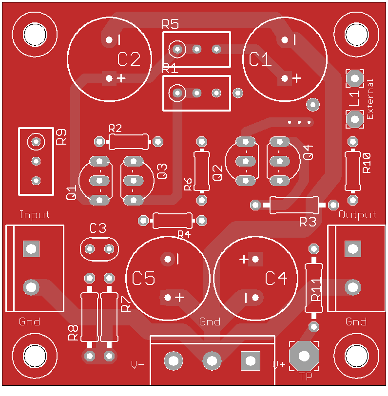

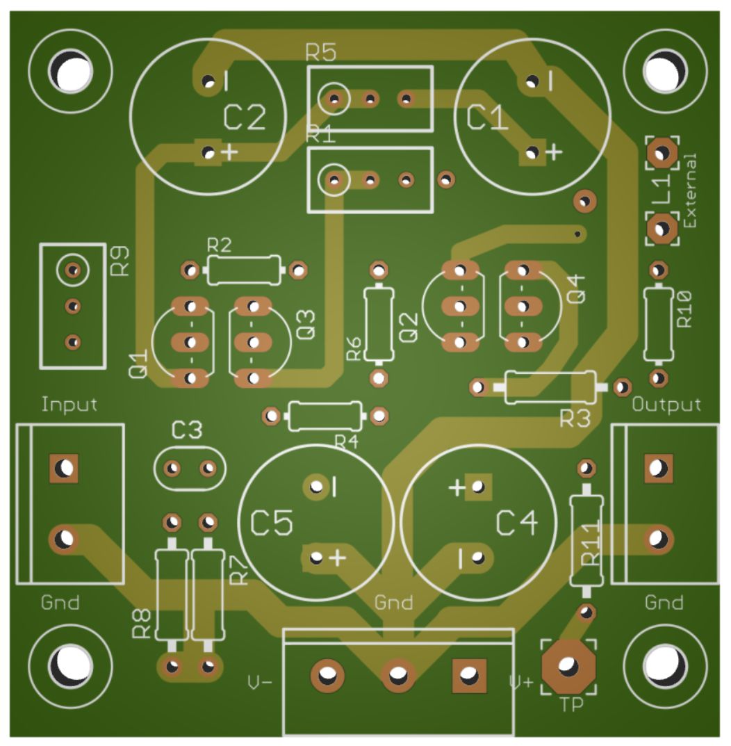

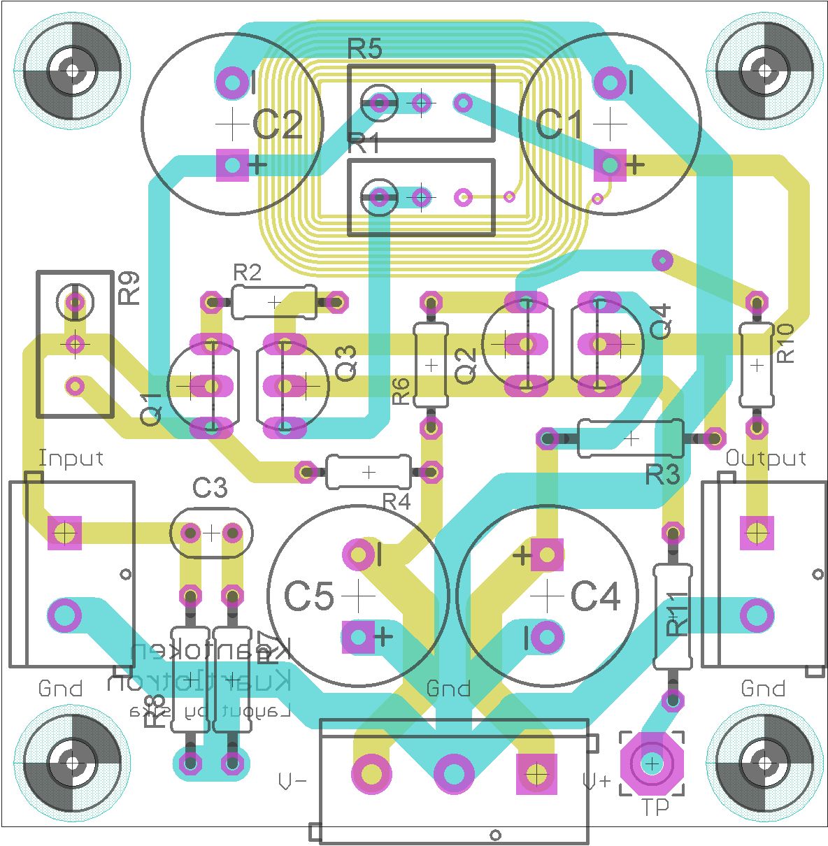

For convenient build, can you do L1 with PCB traces?Only cosmetic changes, if there are no compalints I'll post this to dirty tommorow...
Yes I can 😉

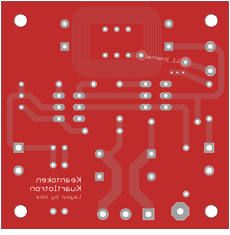

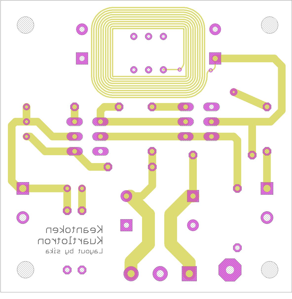

Anybody knows how much uH is this inductor?
Calculation is for 20x20mm=2.9uH and ours is 20x16mm, so I believe we are not very far from 2uH.
Please someone check this independently.
Calculator link: Planar spiral coil inductor calculator
the number of Turns and the Area enclosed within the "coil" are the two major factors affecting the inductance value............Anybody knows how much uH is this inductor?
I am not familiar with the calculation, nor the flat type of inductor, so this is off the top of my head:
The area inside the 20 by 16mm coil is similar to a 18 by 18mm coil.
If you input 18mm into the "square" calculator you should get a close approximation to what the calculator designer would expect.
A wire coil has inductance that depends on Turns and the effective diameter of the "wire group".
If the coil is not circular, i.e. it is puled out into an oval, or into rectangle, then the inductance drops. This drop would be because the non circular shape encloses a smaller Loop Area.
That is the same effect as your 18x18, compared to 20x16.
Does any of that make sense?

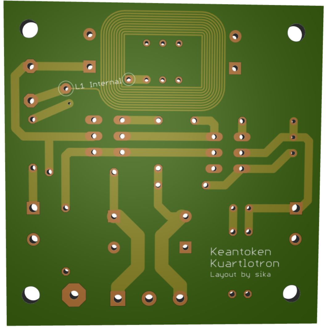

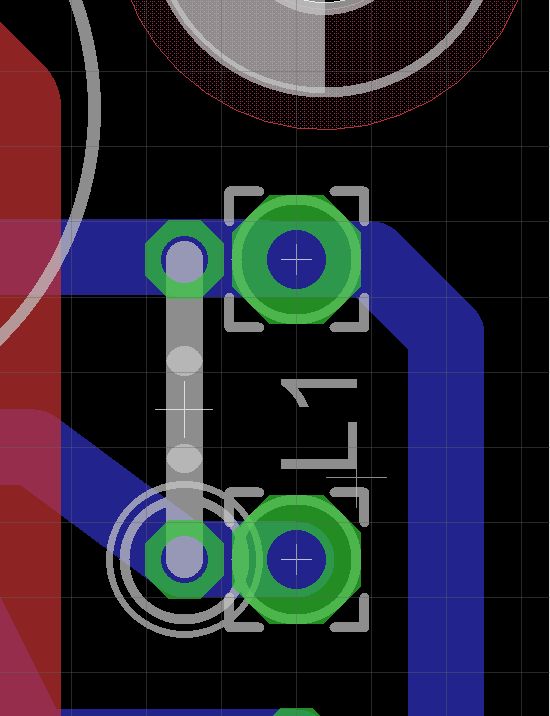

For flexibility I decided to put it this way:
* added pads for external L1 conected serial with internal L1.
This way you can use internal, external or both L1, just short one you dont want to use.
If nobody complaints this version is final.
Many thanks Kean.
Andrew, it makes perfect sense to me, but I really dont have knowledge to be sure, so I added "backup" plan with external L1, this way if internal is OK all is good, if not you can use external L1.
Go ahead.
Many thanks Kean.

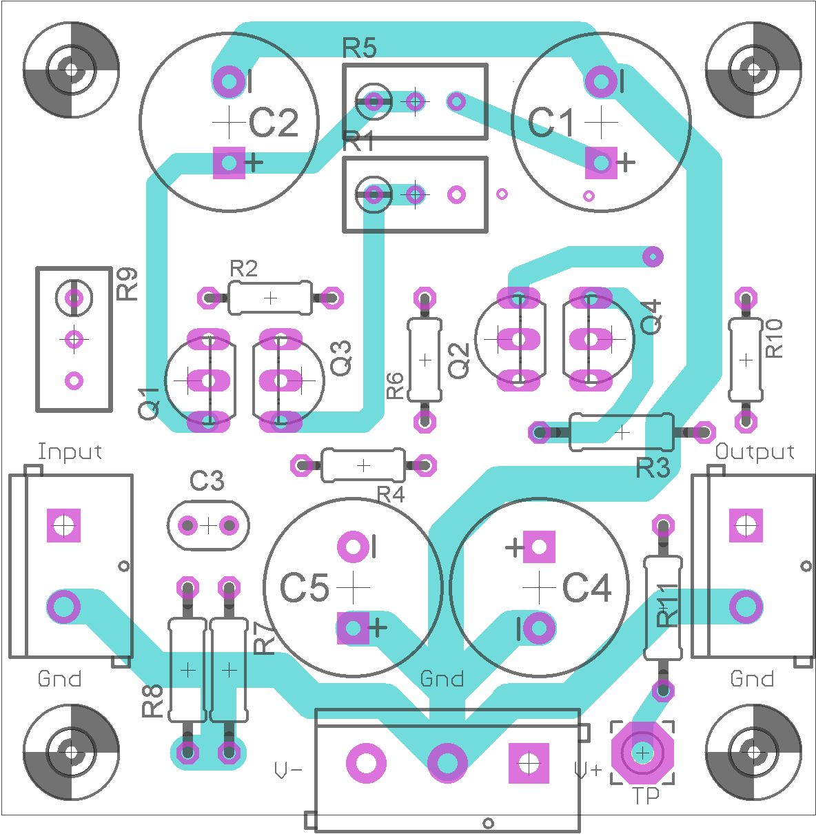

Work in progress, more or less finished...
Kean, please take a look & comment
I'll continue tomorrow, must to go...
