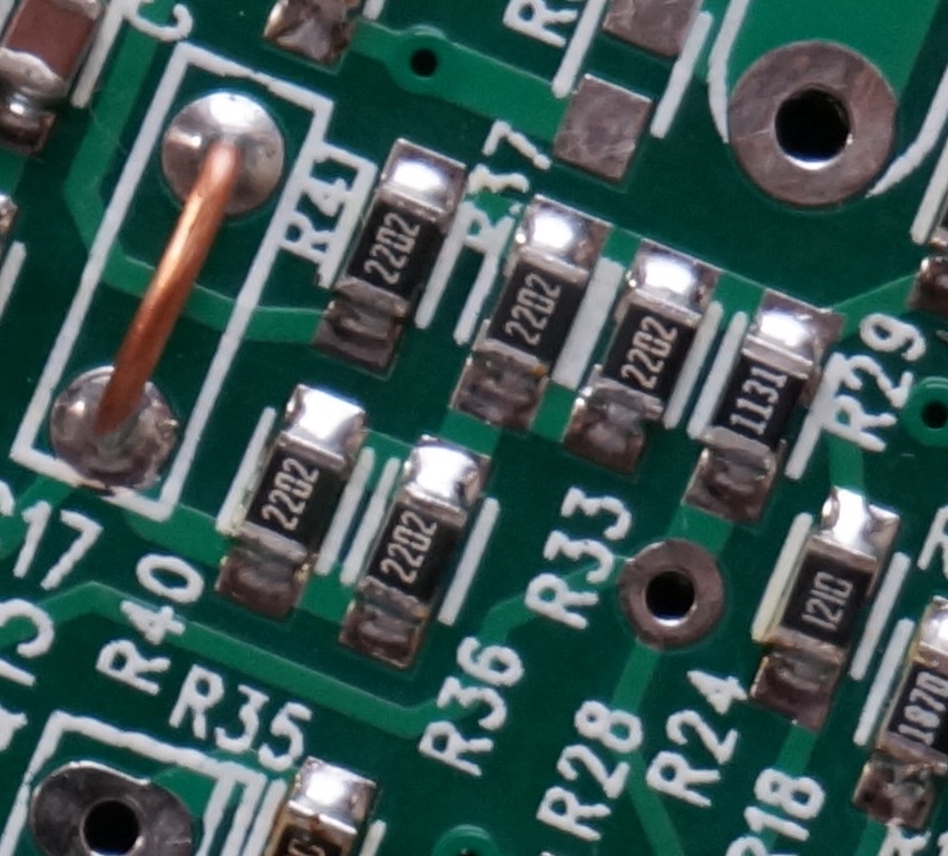

Looks R3 & C2 are mounted end to end.
The gap between the two is very narrow, too narrow to get a soldering tip in there.
The first smd to be soldered will be easy., but after it is in place the second will be difficult to solder since you cannot get in to heat the solder pad.
There are others where access to the solder pad is very narrow

Hi Andrew, thanks for the comment and the concern.
I guess you did not realize the 0805 decal I'm using has enlarged land specifically designed for hand soldering. The narrowest end-to-end in my layout is 0.64mm between R12 and R13. I could reduce that to 0.25mm by placing the component even closer and there is still not a problem soldering parts by hand. The attached picture is from my other project hopefully it explains better. The narrowest spot in that picture is 0.65mm.

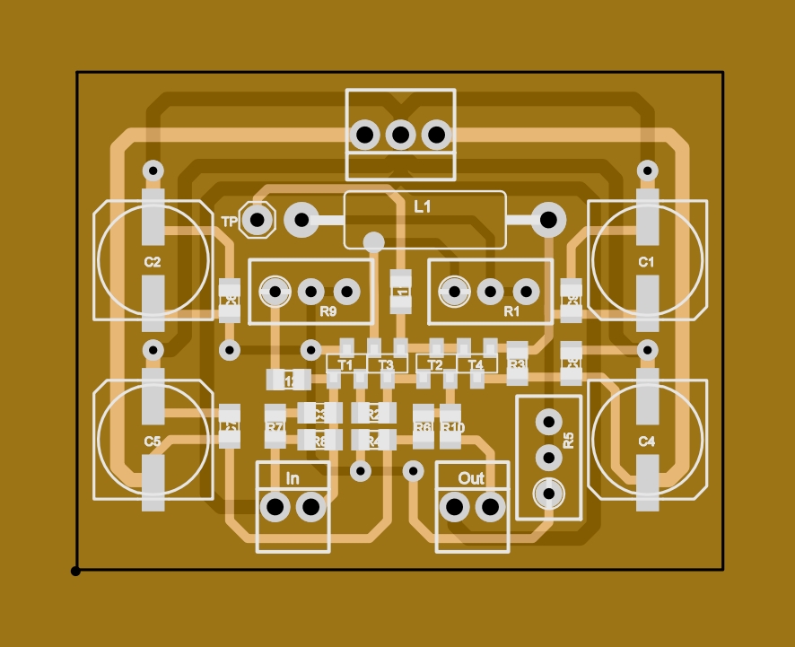

Congratulations!This is my attempted layout using SMD dual transistors, that wont likely go obsolete any time soon. SMD Rs and Cs are 0805 size, quite easy to handle, and a perfect starter size. The 0805 soldering land in this layout has slightly longer pads and was specifically designed for easy hand soldering.

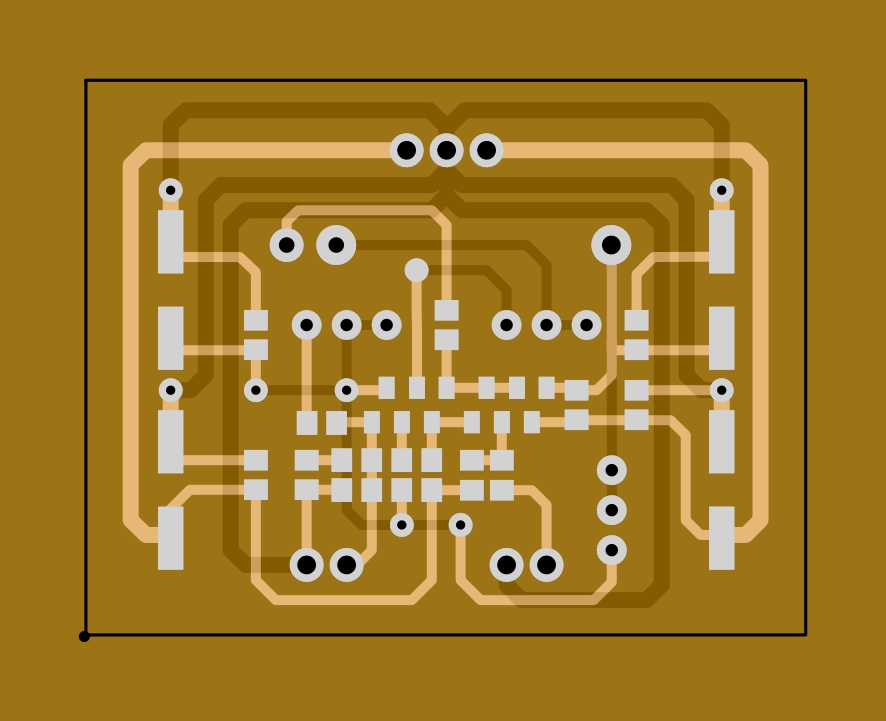

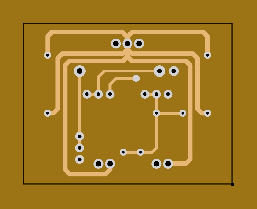

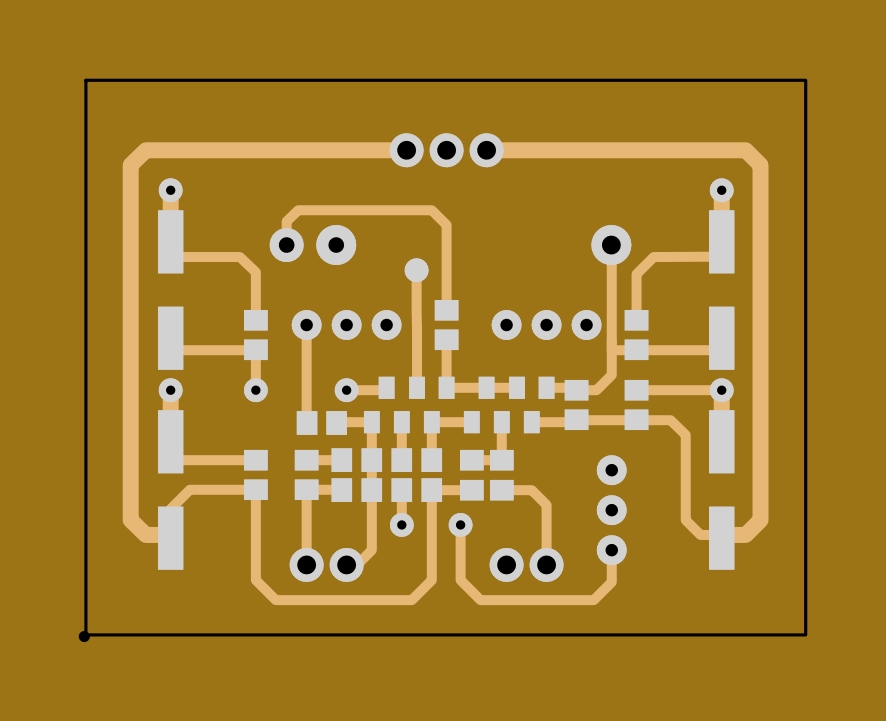

Hello everyone!
I 've never worked with SMD components but I'll try to see if my first test works. I designed a layout for Kuartlotron with BC850 and BC860.
If you think I'm going straight into the wall, tell it!
