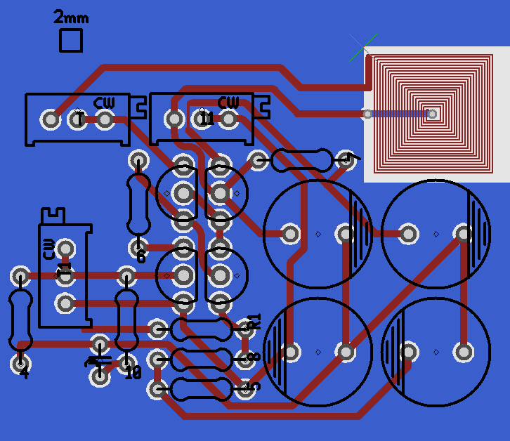

Kean, I don't really get why using a printed inductor that takes a chunk in the layout. I tried to simulate the performance in Spice on different inductor parameters, and it seems the buffer is quite tolerant to the parasitic of the inductor. I had a 2-ohm series resistance, 47pF parallel capacitance, and a 10K parallel resistence to make it a really crappy inductor, and the THD at 20KHz and 100KHz remained unchanged. Do you think we could then get away with a hand-wound multi-turn inductor with fine magnetic wire around a 1/4w, 100k resistor as a bobbin? Or maybe an off-the-shelf inductor?
You're right, almost any inductor will do. The important frequencies are in the MHz region. I've used a 1.6uH ferrite bead and it was fine. I will add a solder bridge so the inductor is optional in case you want to use your own. Or I may eliminate the inductor entirely, but I don't see why a self-wound inductor would be superior.

The layout is still materializing, slowly...
I'll buy it!
That looks easy to work with. That spacing on the inductor Vias might be tight. I think two SMD pads are nice for solder bridge. One can also insert a tiny piece of wire into solder bridge if it's tough. That way it's easy to remove as opposed to vias. Vias, round, also are hard to if not impossible to bridge.
Also, it looks like you haven't bypassed inductor.
You could make R8=100k. The reason it's 10k is for DC setups since I was asked for a DC version. However this might make your volume pot uneven.

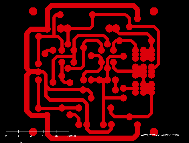

You can not use a file viewer for sending them.
Simply put the files(bottom layer, bottom soldermask, top silkscreeen, board outline and drills) in a zip file folder and attach them like you did in post 405.
I don't know what program you used to create the board, but most usually have a option under "file" where you can export Gerbers. At least Sprint-Layout does.
