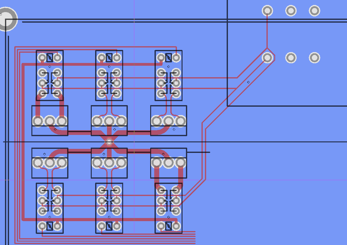

Here is my first stab at the relay section. Experience certainly serves here. I had to trial and error it until I found a routing that wouldn't break the ground plane. Just quick and messy so far.

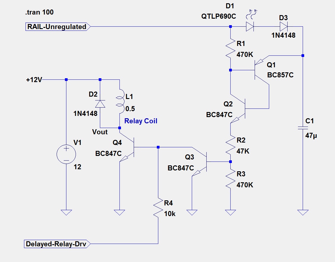

If it hasn't been proposed, here is a simple Kwikmute circuit that can work with a delayed power-on relay driver and offers de-energizing the mute relay whenever the supply rail sags by 2V or greater. It will also hold the relay off for a few seconds (about 10 seconds as in the simulated setup) once activated. I think a muting against power off or power failure is needed for a preamp in order to prevent any uncertain or erratic signals that might be generated from reaching the power amps.

The description you give sounds great.
Is L1 .5 henries?
Thank you🙂
Keantoken is right. The inductance value is irrelevant here because L1 is a relay coil, we look much more seriously at its resistance at DC than at its inductance.
I don't have a relay coil symbol/model in my LTspice library so I substituted with an inductor. If you had opened the .asc file I attached you'd found L1 has 220R series resistance in its property setting.
I'm far more distracted than busy... that .asc can be opened in LTspice as a schematic ready for simulation and/or tweaking. That means a PC is in order unless LTspice came in cellphone version that I'm unaware of. Cellphones that do not do .asc can still open that .asc, as it is indeed an ASCII file, by renaming it to txt. Then it is not hard to search and find in it a text string starting with L1 with Rser=220 included.😉
