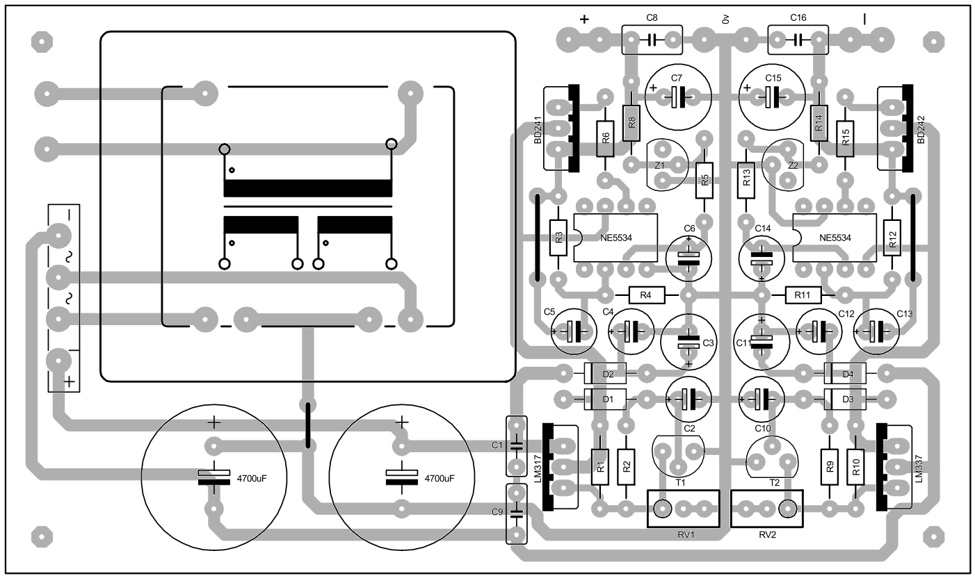

for my phono preamp I did a Borbely-Sulzer supply with soft start and it works fine but is a bit too complicated I think for a little editing as Kuartlotron.
Regard's!

Please give more details.Where we can find schematic and pcb to built this?
I gathered everything I found on the subject and I designed a circuit that adjusts the output voltage and includes a soft start with more or less delay.
I have drawn two circuits (with a transformer on the circuit board and another without transformer).
This power supply is very stable and quiet but is rather complex.
I can offer my circuits but I would have drawn a diagram with some explanations for some points.

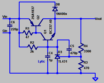

Nevermind, I remembered the TL431 incorrectly. The output impedance is larger than would be for a KM. It is still useful, but needs boosted to get low output impedance. I can combine it with the KM to get a very accurate voltage regulator.
A center tap is just a midpoint. In power amps it is necessary because there may be very uneven current draw from the rails and the center tap can absorb the difference. There are no other magical qualities of center taps that I know of. I do know they they allow a third path of current from the rectifiers which can cause uneven rectifier currents and thus intermodulation with the rectifier pulses.
Salas' regulator is very good, it would not be a bad choice at all! The Jung/Didden supereg is also very good and if you wanted the ultimate performance then it might be a good idea to build both and do a listening text. I think the supereg gets lower output impedance, based on the Linear Audio article of some time ago.
Here's what I'm thinking.
If you were really worried I suppose you could do two 1uf electrolytic caps?
With the rejection of noise, and low impedance of the KM setup, I'm not sure this is the place to worry about noise so much as the power source to it. Although I won't argue other regulators mentioned here have some outstanding graphs...
Speaking from experience with the use of the KM in this configuration, it undeniable works well even if I don't have graphs of it in a shootout of regulators.
Yet I'm really curious about what JP might mention.
I have built several of the Salas DCB1 buffers, and the lower the impedance of the supply the better they sound. Salas says this himself and that's why he recommends "hotrodding". The best proof is in the listening, if someone tries it and says the regulator does not make a difference then I'd tend to believe them, but so far no one has tried it. I can only say that it makes a worthwhile difference with the DCB1, and it might be the same case with this buffer.
First thing in audio to make things better is to use good if not excellent power supplies. Simple. Also a simple schematic, good power supplies do not need to be more complex than average ones. Salas shunt supplies are fine (but they're not small or cheap). So are the newer LDO regs with astonishing low noise numbers. If you are into low component count, low board space and low noise the newer LDO's might be just what the doctor ordered but then no K multiplier necessary....Uh oh...
