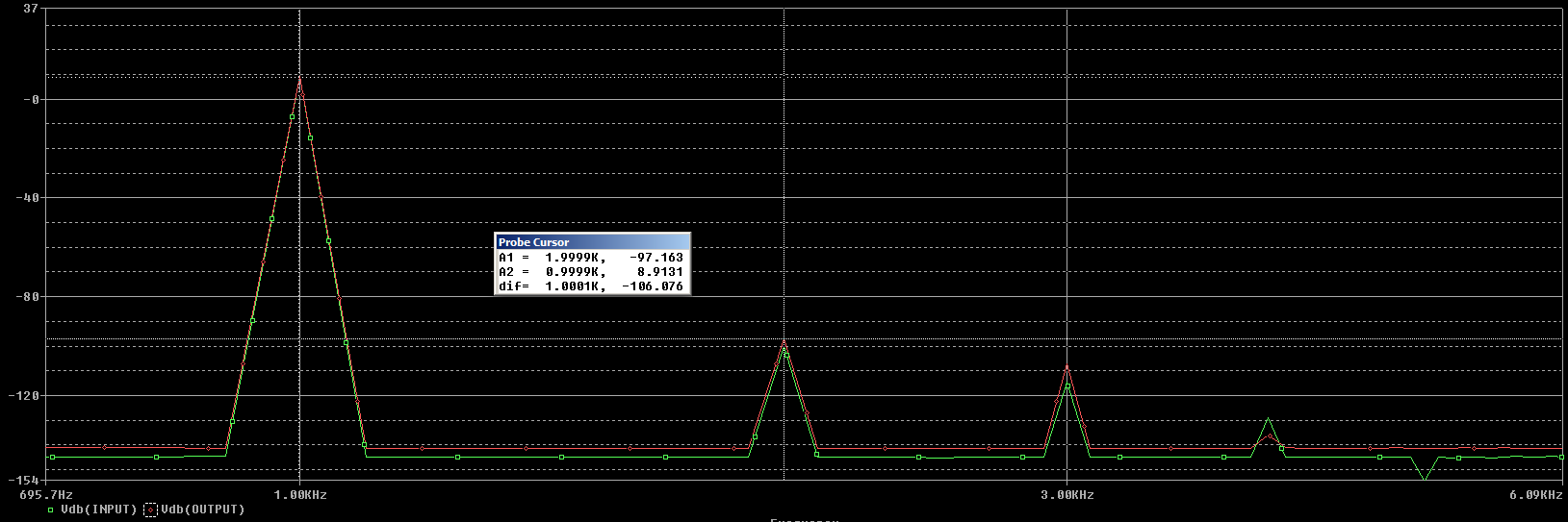

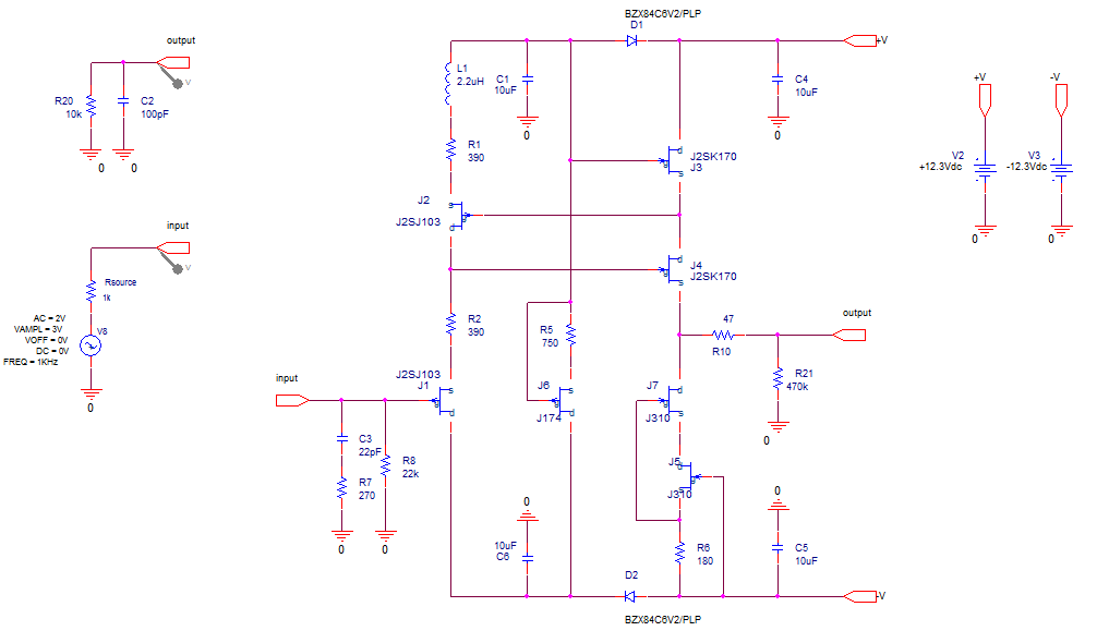

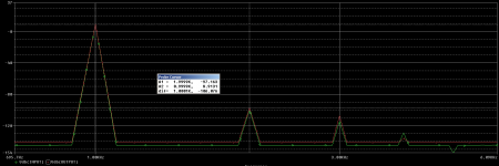

Hi
I transfered BJT to JFET
acting very good on sims...
cheers
Hi Zoran. The Jfet models in SPICE are usually not very accurate and there are some built-in flaws. I'm sure a Jfet version would operate in real life, but probably not like the simulator predicts. Go a ahead and try it if you want, I'll be curious about the results.
Note that in your simulation the only output load is 470k. This is unrealistic. Try 22k or 5k.

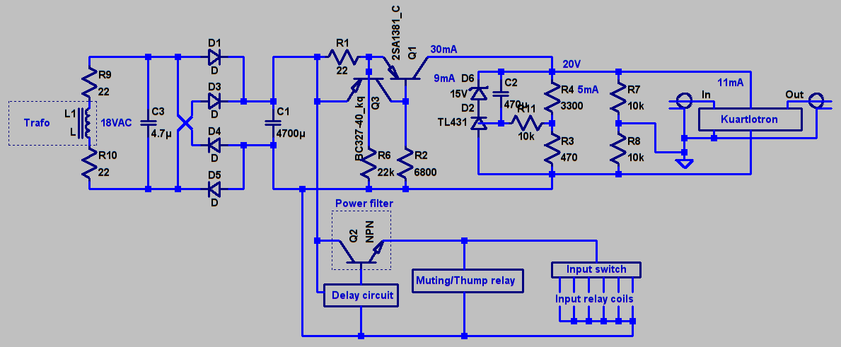

I'm thinking the power supply will use a virtual ground, no need for a center tapped trafo. The power will be a TL431 shunt regulator. This will be the simplest option and do very well. It does not have to be this way however.
Yes Ken, right...
I spot that some values should be adjusted in real circuits. Mostly parts that controlling the currents (Rs). Usually lower values are real, so the initial values of biasing will give lower Io probably. But I will test.
I put the 470K at the output of the unit, but real load is at the output connector (upper on the sch), and this is 10K *or more precise (10K parallel with 470K, bit lower than 10K) and about 100pF of cable capacitances.
with that fixed values of zener diodes of 6.2V, power supply value should be adjusted for zero V offset @ output

I use omishra's power supply which is based on LM317/337. It works quite well. I like the fact that output voltage is adjustable with trim pots.

If you are asking me:
1. It could be interchangeable with DCB1/Mezmerize but it is not really necessary
2. In case of point 1 being true: yes
3. See DCB1/Mezmerize schematic. I attached the muting circuit to this post.
4. IMO stereo board with shared PSU but separate supplies won't break the bank. The no doubt approach.
5. Why virtual GND when center tapped transformers are standard ?
6. Why TL431 when it can be better ? I spotted a 15V Zener diode. We can do better than that and also more compact. SMD ultra low noise regs + cheap 2 x 8V transformer....
7. I don't see much decoupling in the schematic. Doesn't it need decoupling caps ?
8. Volume control is missing. Adding pads for a potentiometer would be nice. Any other volume control could be soldered to those.
9. Both balanced and unbalanced versions could be designed.
10. I would use standard telecom relays when shorting to GND, they have gold plated contacts anyway. A low power mini version would be nice. It is better to short to GND as the contacts would be out of the signal path as opposed to contacts in series with the outputs. Mesmerize first had series contacts but this was changed in later board revisions.
* 2 x 8V transformer would give way more voltage with this load. It has to be tested but with LDO regs I think it will work out OK. A 2 x 9V will work for sure.
Tamura PL5.0-16-130B is 7.80 $ at Digikey. It could be a lighter type, this one is 5VA. DPC-16-260B10 also seems OK. Some want 120VA types as this is audio but IMO small is beautiful 🙂
Power draw is 11 mA per channel so 22 mA. Add a dim glowing power LED (2.5 mA) and 2 signal relays for muting and one input chosen. The much liked G6H-2-100-DC12 draw 12 mA at 12V.... So power draw is minimal. Add CRC filtering or CLC filtering for removing RF and/or other garbage. I use common mode coils a lot. They work good.
