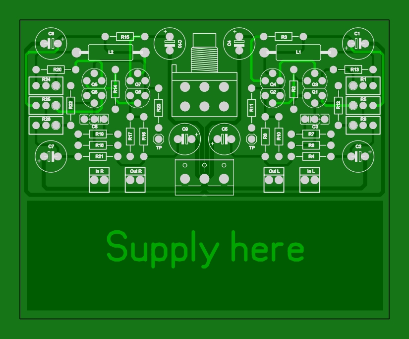

I started an implementation for a version with two channels of Kuartlotron (without power on the card Firstly) with standard components.
Before going further, do you think that this provision is interesting?
But as keantoken working to propose a layout, should I continue?
Regard's!

I can't see the reason for a one version pcb only😉
You must continue working🙂

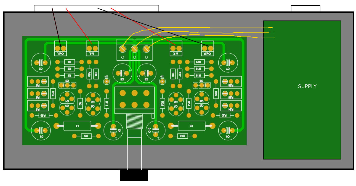

Looks good but please reroute inputs to one side and outputs to the other side. Think how it will be wired in a case and where the RCA input- and output plugs will be located. In 99% of cases inputs are at one side and outputs at the other side. Tidy wiring adds to the final result. You don't want cross wiring of inputs and outputs. Please add pads for Alps RK27 (minimum standard for quality volume control), input- and output caps and a muting relay just like Mezmerize has as you will need it. Adding pads for a a simple PSU (rectifier diodes + RC filters + LM317/337) will give you the opportunity to use it before you will be drawing a spectacular symmetrical low noise PSU 🙂 If you leave the connector block you will be able to wire the new PSU later on. I would also add a simple RC filter at the inputs to filter out HF/RF. The point with high bandwidth is.... you know what I mean.

Do as you like but that is cross wiring. They taught me to keep inputs grouped together, same with outputs.
I think that a 3D connection topology can solve this. x / y for signals and z for power feeding. This means all power feed taken off the board and just injected where needed from z direction. This is also good as fields from power feed is orthogonal to signal carrying lines.

Eh ? I never saw the Matrix. On second thoughts: I think I understand what you mean. It can also be done by turning the active parts of the design 180 degrees, leave the potentiometer where it is now and make the board somewhat larger. Then regroup inputs brotherly together and flip them to the other side of the board. This board just needs SMD parts 🙂 ... and a PSU... :devilr:

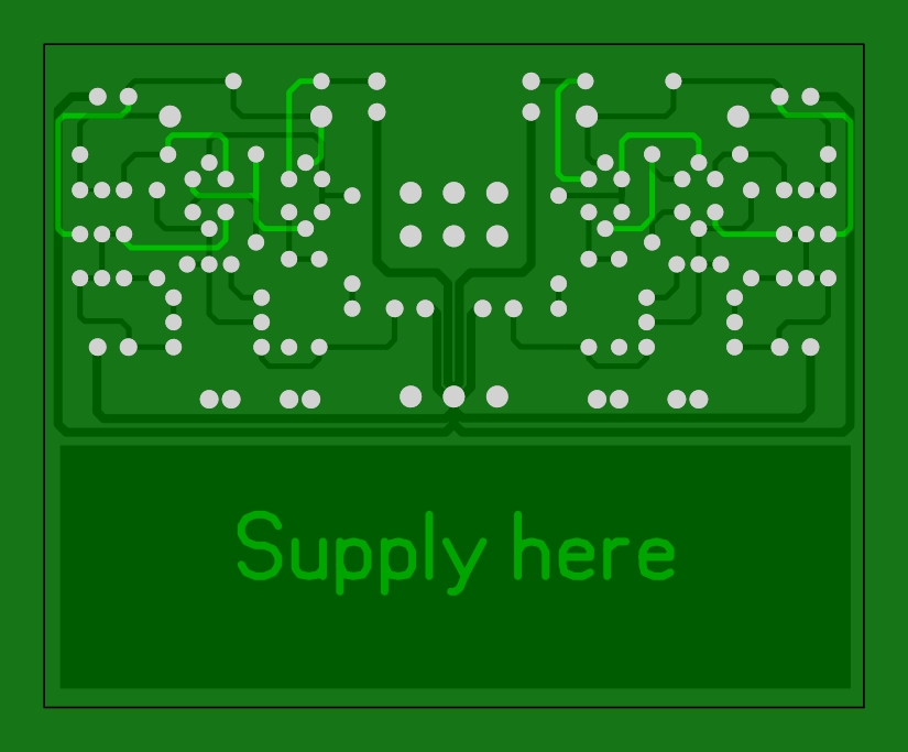

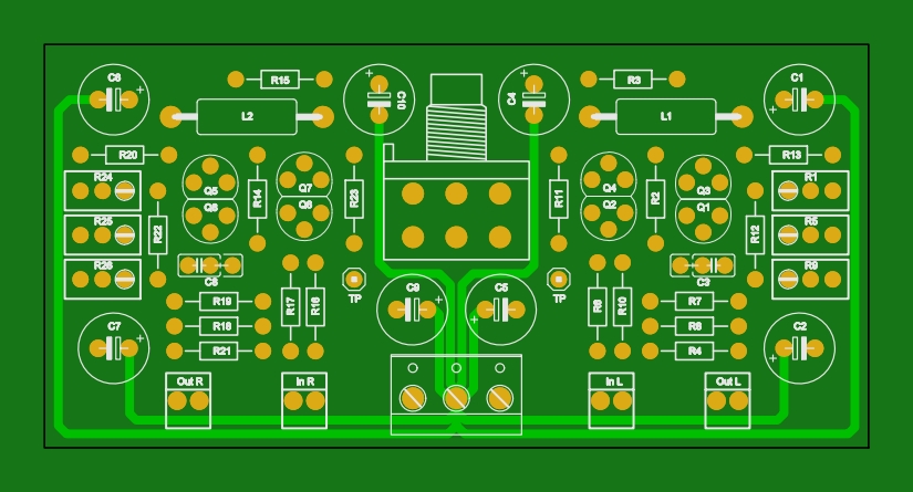

Hello everyone!
This is what I offer and I think keep this provision of components, but a double-sided circuit is required.
Now I will:
- Move the RCA by following your proposals.
- Import a supply.
Regard's!
