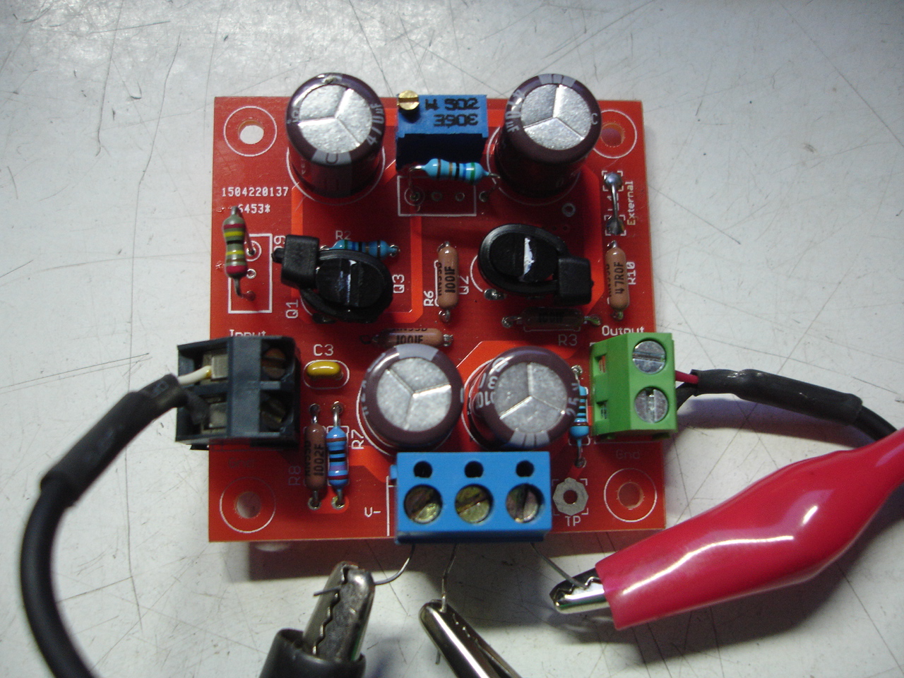

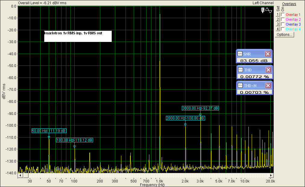

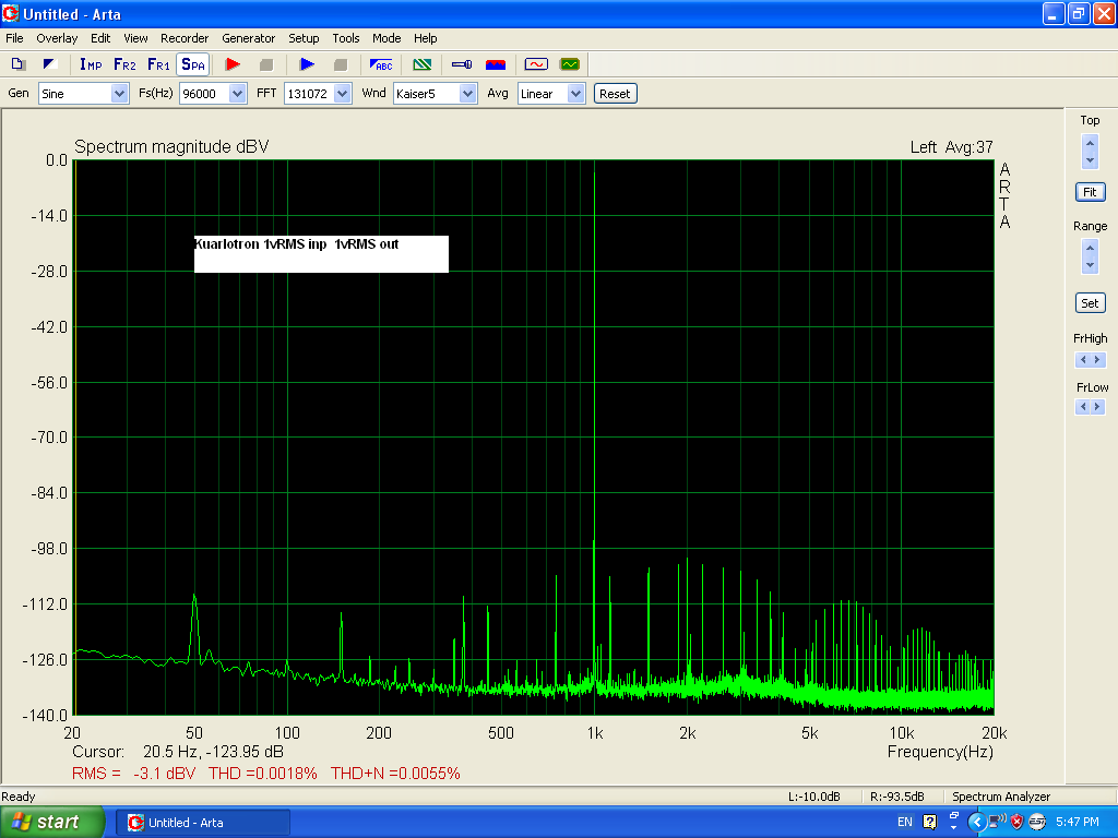

I did the usual checks and adjustments (0.012 - 0.014 mV DC offset). This time there is absolutely no hum or hiss. I'll need some burn in as I'm experimenting with a thicker solid core internal wiring (20 gauge, Teflon insulation).

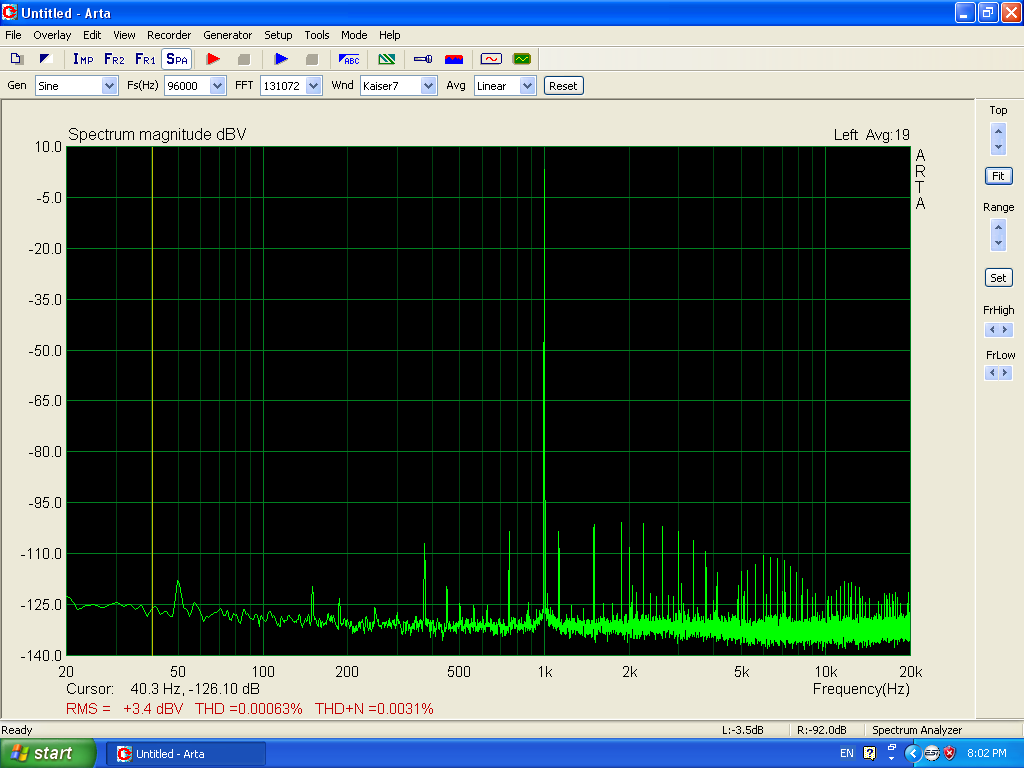

Another software based test.
Can you list the exact parts you used? Is this before trimming?
Is this for me?
Look all transistors bc550c,bc560c by fairchild.

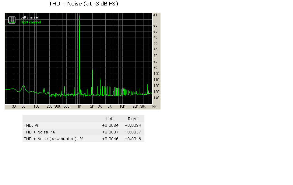

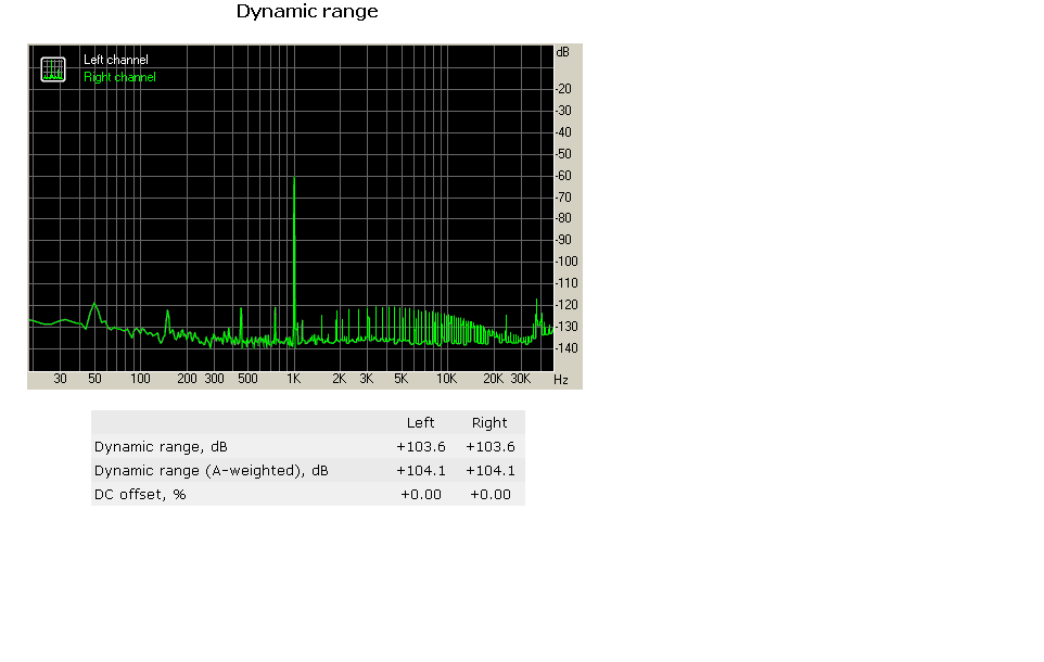

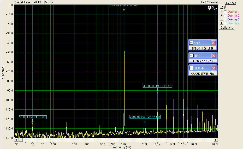

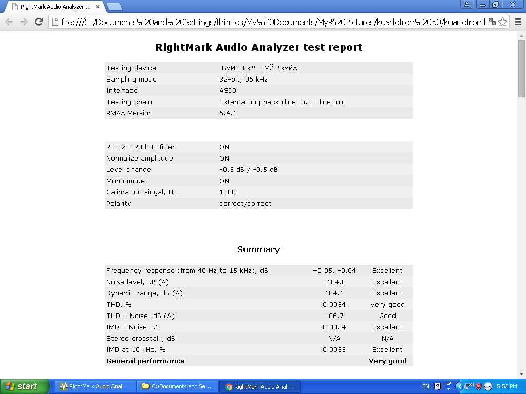

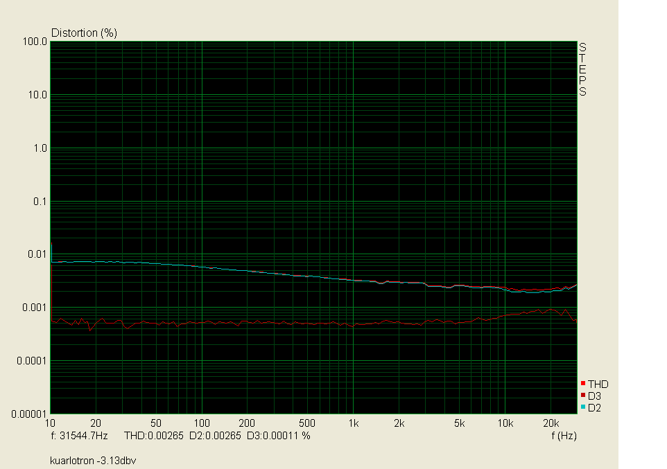

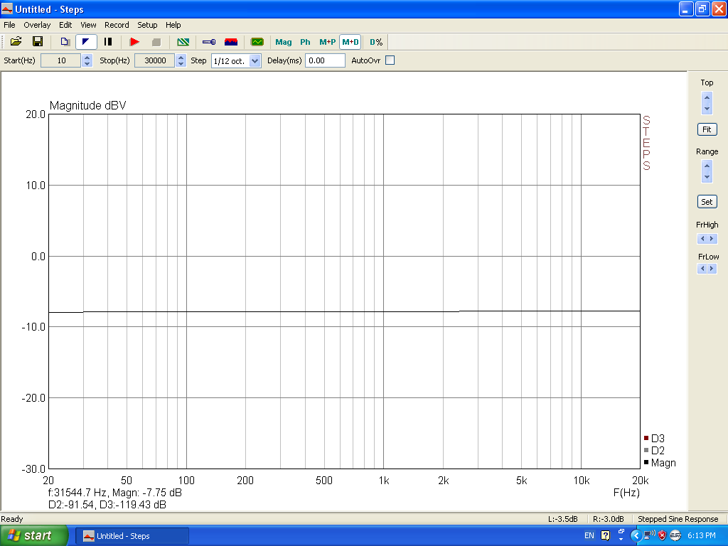

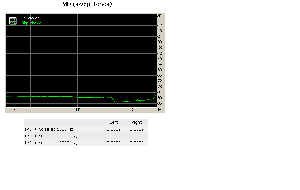

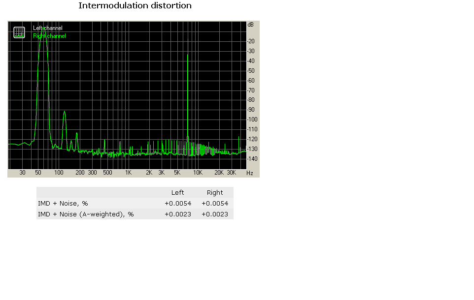

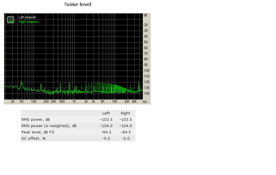

Farther test using Right Mark audio analyzer
