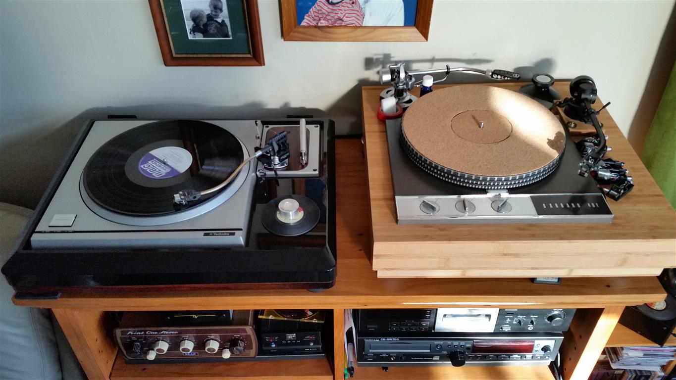

Well,all up and running.Have tried to upload a photo,might have happened.
Yep.looks like it did.
The SP10 sounds great even with the SME on it.Have 2 Shure V15/3's, so have one in the FR and one in the SME.Just swapped the SAS stylus over to compare setups.Close,but the bass is tighter and cleaner on the SP10.

Glad to see it up and running! Great to hear the comments about the differences.

Brianco..I'm not too worried about "thinner" as I don't like too much bass,and I have various cartridges to play with! As they all sound different (slightly) I'm sure they're not perfect neither!
Mainly find my Garrott P77 SAS the easiest to listen to,and that's a little fuller sounding than the Shure V15/3. And that will probably change once I move the 64fx to the SP10.
Must say I'm enjoying the V15/3 on the SP10/SME3 though!
Had to add a couple of mats to get the VTA right with the SME hard down..Might have to make a thinner armboard for the 64fx.
Also one of the feet has had it, so will have to find something else.
