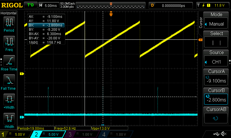

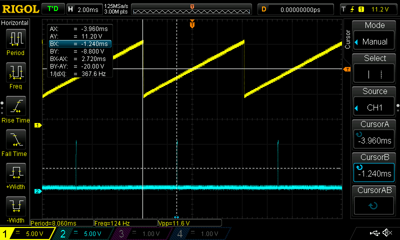

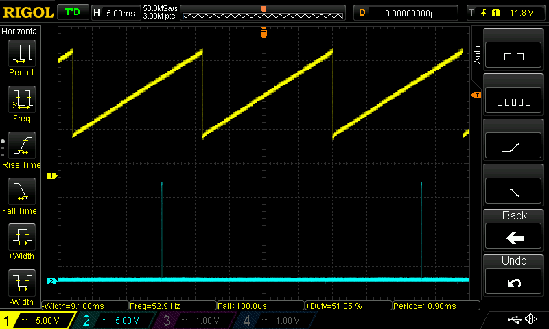

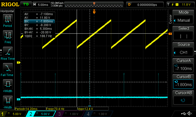

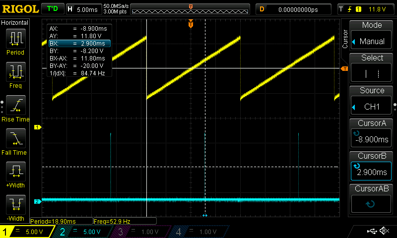

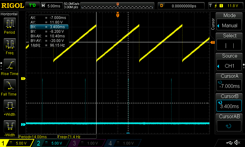

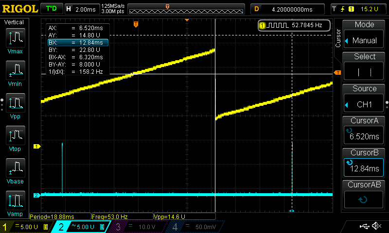

33 should be 6.3ms +/- 0.2ms, and you're at 11.8ms. There is no adjustment for 45 - you just need to confirm it's 4.7ms +/- 1.3ms after 33 has been set. 78 should be 2.7ms +/- 0.1ms - looks like you're good on that one.
So, for 33 move cursor B such that AX-BX = 6.300ms, or close as you can get it. Then, adjust VR101 until the pulse on channel 2 lines up with cursor B. Then confirm 45 is right.
Thanks Dave. It was more opportunity knocks rather than following the advice given here. The lower board required some extensive work as PCB tracks were burnt and lifted, whilst resolving that I went through the supply to give a clean bill of health. From the get go I'm getting 5.04V and 32.44V respectively so I'll just tweak these a touch and take it from there.
