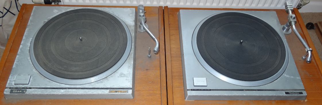

Hi Folks,
Good to join you all on this thread.
I've been fortunate enough to be able to rescue this pair from a certain journey to the scrapheap.
In rather sorry condition, cosmetically poor and very tatty (one being worse than the other) but essentially sound, important thing is they both appear to spin up. Come with issues though - one which won't select 45rpm, one with brake issues and start/stop switch issues, both with strobe issues.
Both ex-broadcast SP10-MKII's which have been built into purpose-made mdf enclosures (although both falling apart) with cue and remote stop/start for the radio studio (original sh10-e psu's still in place inside the cabinet). What looks like the remains of two peizo pu-402 tonearms (minus the extra counterbalance on each).
Complete strip and rebuild on the cards i think with a planned re-cap in the mix aswell. Plenty of issues to sort and this will likely be a long journey so I will be needing to lean on some expert help from fellow experts along the way, but looking forward to the challenge to hopefully end up with a decent record spinner!
BTW - the model labels both are "SP10MKII-XGE" - does anyone have a copy of the service manual for that specific model? The only ones i can find on vinyl engine website seem to be for the M, MC, EG or XGF - not XGE. I could do with the right one so that the settings when i come to re-cap are done right.

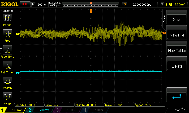

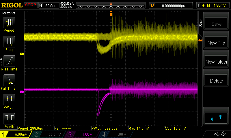

Still trying to set the speed correctly on my sp10, have an oscilloscope now but.... the wave forms aren't correct and there jumping around all over the place, could anyone suggest where to look?
Both the labels on both SP10's underneath are both "SP10MKII-XGE" - is that of special significance ie does it represent a special model of the SP10 (ie broadcast?)?
Does anyone have a copy of the service manual for that specific model? The only ones i can find on vinyl engine website seem to be for the M, MC, EG or XGF - not XGE. I could do with the right one so that the settings to check, when i come to re-cap, are done to the right tolerances (incase they differ between models)
Thanks.
Chris.
See pic below for how it's connected, the probes grounds are connected to the star ground at the back of the player.
Just a quick question on the rigol scopes regarding the 10x setting, does this need to be set on the scope as well?
I believe all the broadcast models are based on the MKII. Does it use the SH-10E power supply? Any extra cable coming out of the motor chassis?
Both were being powered by normal sh-10e psu's hidden in the plinths they were in. No extra cables other than the 4-pin xlr and remote start cable.
I have seen mention of SP10P-MKII-XGE which sounds like the broadcast specific models but not just XGE..
Chris
Chris
I think XGE is a region code, like M (North America) and MC (Canada) are. Sounds like you've a standard MKII. A P version would have a different power supply and an extra cord from the motor. Perhaps Mr. Cawley will chime in as I'm sure he has more specific knowledge on this, but I'm pretty sure it's a standard MKII.
Ok set it up properly now, wave forms still not right, any ideas?
Setting the scope for 5v/div and 5ms/div is a good start, or you could probably hit the Auto button and it'll find the triangle wave on its own. If you've never used a scope before a good way to learn quick is to use the built-in signal on the metal loop at the bottom right of the unit. Hook your probe to that and hit Auto and you should see a square wave. Once there you can play around with the controls to get familiar.
