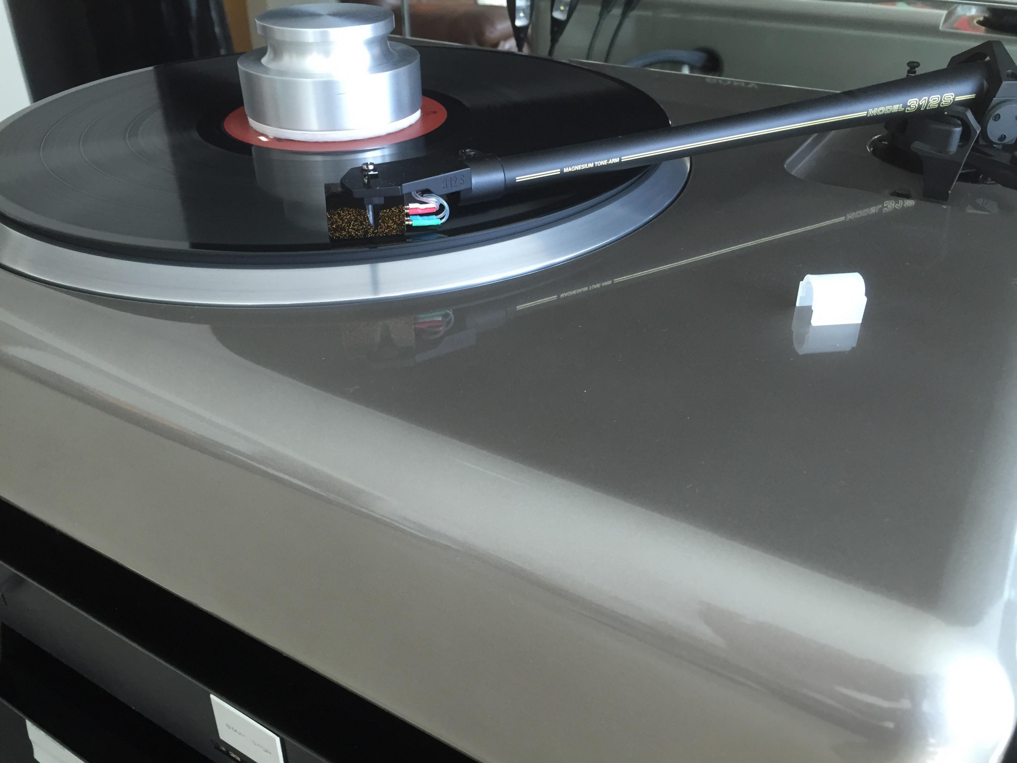

Yesterday afternoon I finally worked up the courage to mount my Koetsu Urushi Black. After a couple hours I have it pretty close. This afternoon I'll get out the USB microscope camera and better dial in the SRA (Stylus Rake Angle).
The cartridge is beautifully but a little weird how it hangs so far over the headshell, at least to me.
Sounds great and I'm having fun playing and listening.

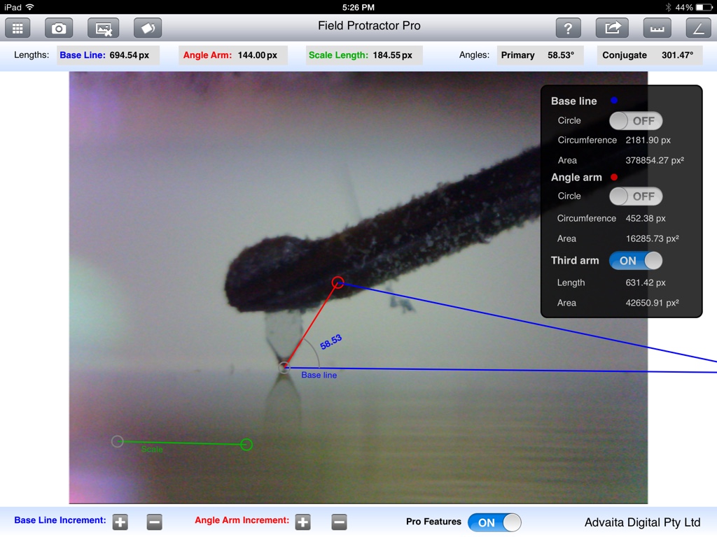

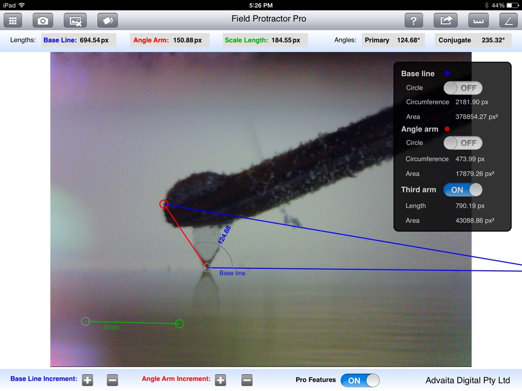

For those interested I set the SRA this afternoon with an inexpensive (eBay $60) USB microscopic camera and an IOS app. Took a bit to get everything set up. But basically you lay a CD on the edge of the platter and set the needle down. Then set the camera close to the cart (1/4") and adjust focus on screen with laptop and with adjusting lighting get the horizontal line of the CD in pic for reference.
After sending the image to my iPad I used a protractor app to measure the stylus.
So in one pic I have 58.53 and the other I have 124.68. So add the two together = 183.21 then divide by 2 = 91.6. Pretty close to the spec of 92.
At least I think I did it right, newbie and all!

concur on the reading of 91.6deg.
Although I took a slightly different tack to get that figure. Visualizing geometry involves a perspective unless one is born with perfect geometric perception.
My method:
(124.68deg) - (58.53) = 66.15
66.15 / 2 = 33.075
58.53 + 33.075 = 91.605
my way is longer but it helped me to visualize that I was measuring from tonearm side.
anyway, the microscope pics look great. You must be quite close to the optimal SRA. Although listening to well known records helps to confirm the adjustment.
