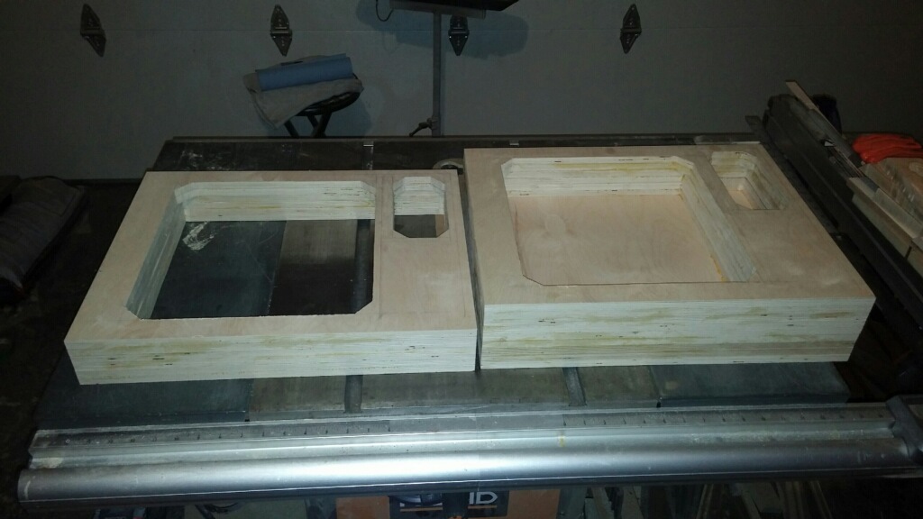

I'm building a couple of plinths from laminated BB Plywood for these TT's.
Here are some progress photos.

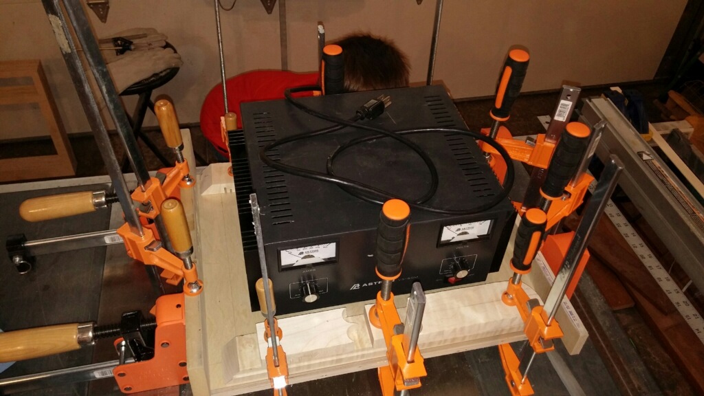

LOTS of clamps are used, I totaled up about 9,000 pounds of force that is distributed around the perimeter of the plinths.
My son enjoys helping me spread the glue for each layer, an extra hand really helps even out the glue with my limited open time for the glue.
When I laminated the 3 solid bottom layers for the tall one I figured an extra 40 pounds in the middle couldn't hurt and I had an old bench supply that fit just perfectly.
The 3" plinth weighs 9 pounds and the 4.5" one weighs in at 20 pounds.
I need to finish the cutout on the bottom of the armboard hole for the big one and that will probably shave a pound or so.
Next I need to even out the vertical edges and flatten the top layer.
Then I can seal and fill and seal all of the surfaces prior to veneering.
