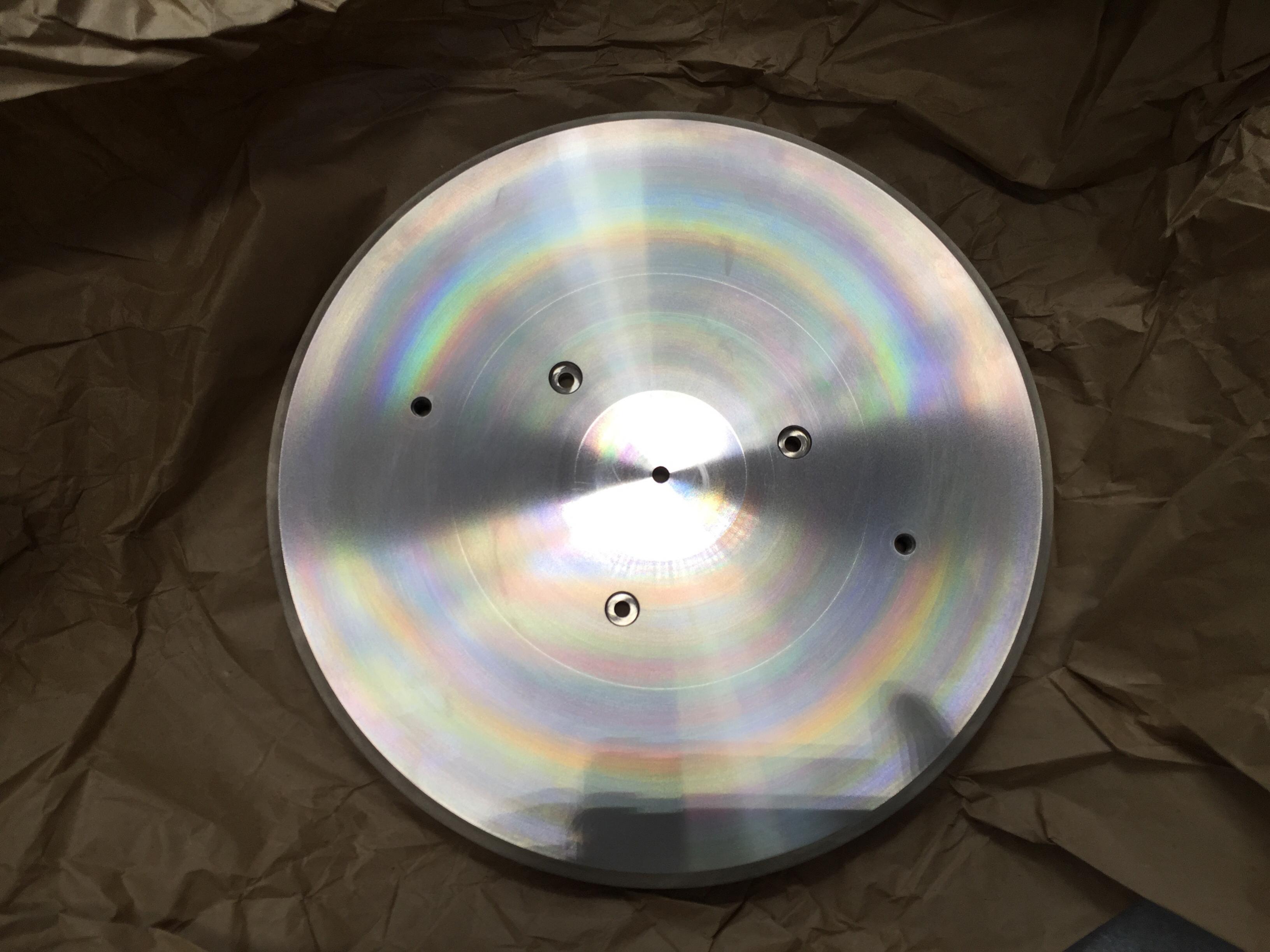

Here is a photo of one. The sonic improvement is difficult to believe I am surprised at how much it is. While demonstrating the platter swap it elicits that jaw dropping response in participants.

These were done by a local company called Titan machine. They have some TV reality show now about american made aerospace or something like that. This platter is easy compared to some of the things they do in exotic materials.
The MK 3 was a reference for us but the modified Mark 2 now is. Time to rework the 3.
A MKII with that platter, may both measure and sound better than the MKIII

I have a MKIII here and the big difference is the platter. To be honest the electronics don't seem to be as good as the MKII. They used a simpler approach on the MKIII as the MKII was way too complex.
So it is quite possible that a MKII with that platter, may both measure and sound better than the MKIII ? and maybe better than anything past or present ?

The bearings are new and the electronics redone with caps etc. It may wear faster with the weight but probably not by much. We just have a half dozen or so of these around. They are cheap compared to some of the $50-100K stuff.
I haven't done any measurements but would like to, just need to figure out the equipment and see what Dave uses.
I do know somebody with lots of measurements of different tables I can talk to him and see what to look for. He makes very nice tables and knows his stuff.
I use exactly the same testing methods as the magazine HiFi World, in fact I sourced some of their test equipment for them. When I'm measuring the MKII in two weeks time, it would be good to measure the new platter too ?
Many of the SP-10's I have seen, have had over 25 years of continuous service, that's nearly 1/4 million hours ! So a few hours a day in the home with a heavier platter isn't much at the end of the day ?
