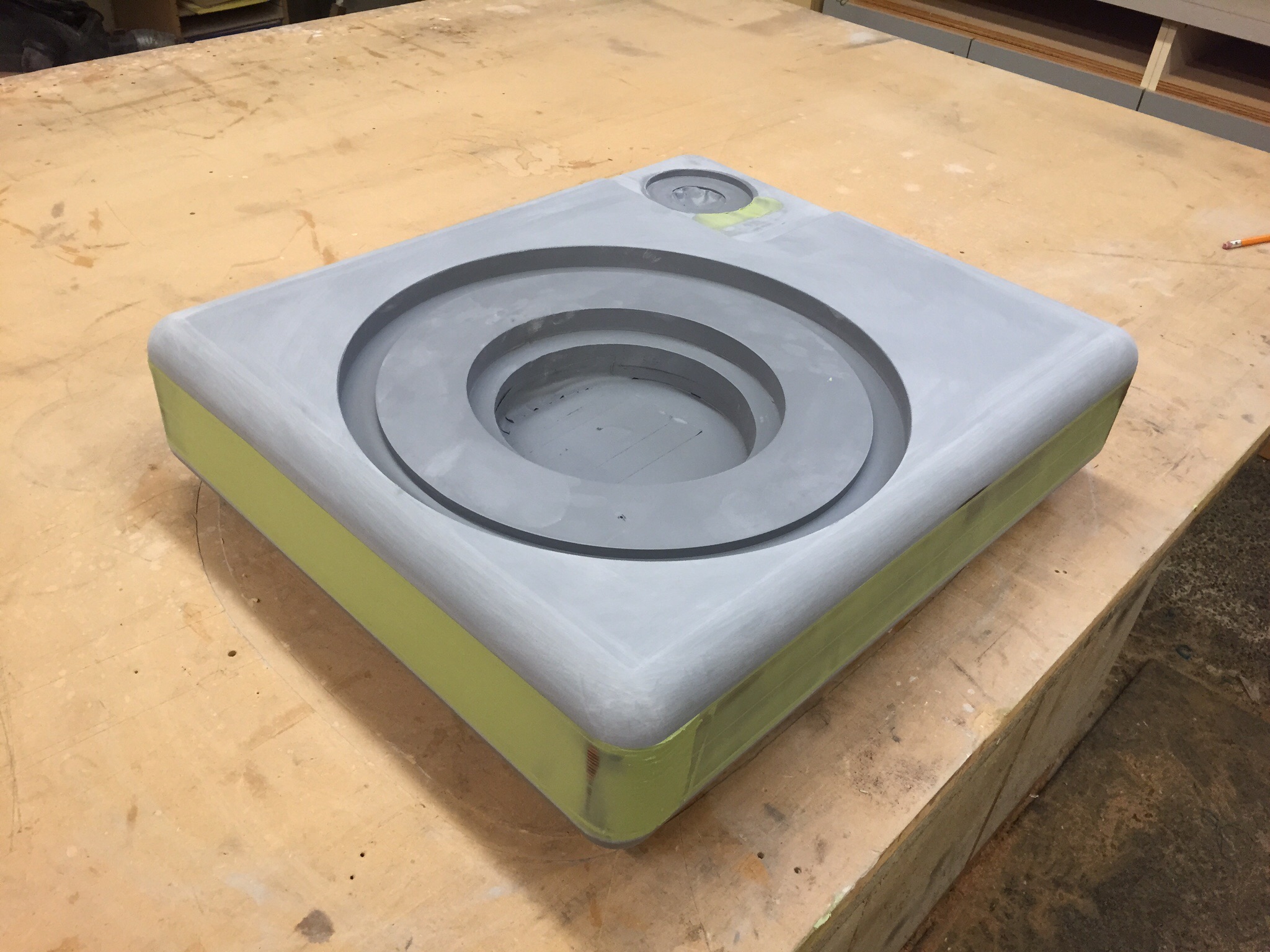

After a week of letting the bonding agent cure I finished rounding over all the corners.
Then put it on a scale to see where I am on weight. I really underestimated how much Panzer I cut away. As it sits it weighs 53.5 lbs.
The Stillpoints are about 1 1/2" tall. A little tall, in my opinion, for the size of the plinth. So I made a 1 1/2" dia x 3/8" deep recess for each foot. Looks less like its on stilts.
Just about ready to start priming and filling for paint.

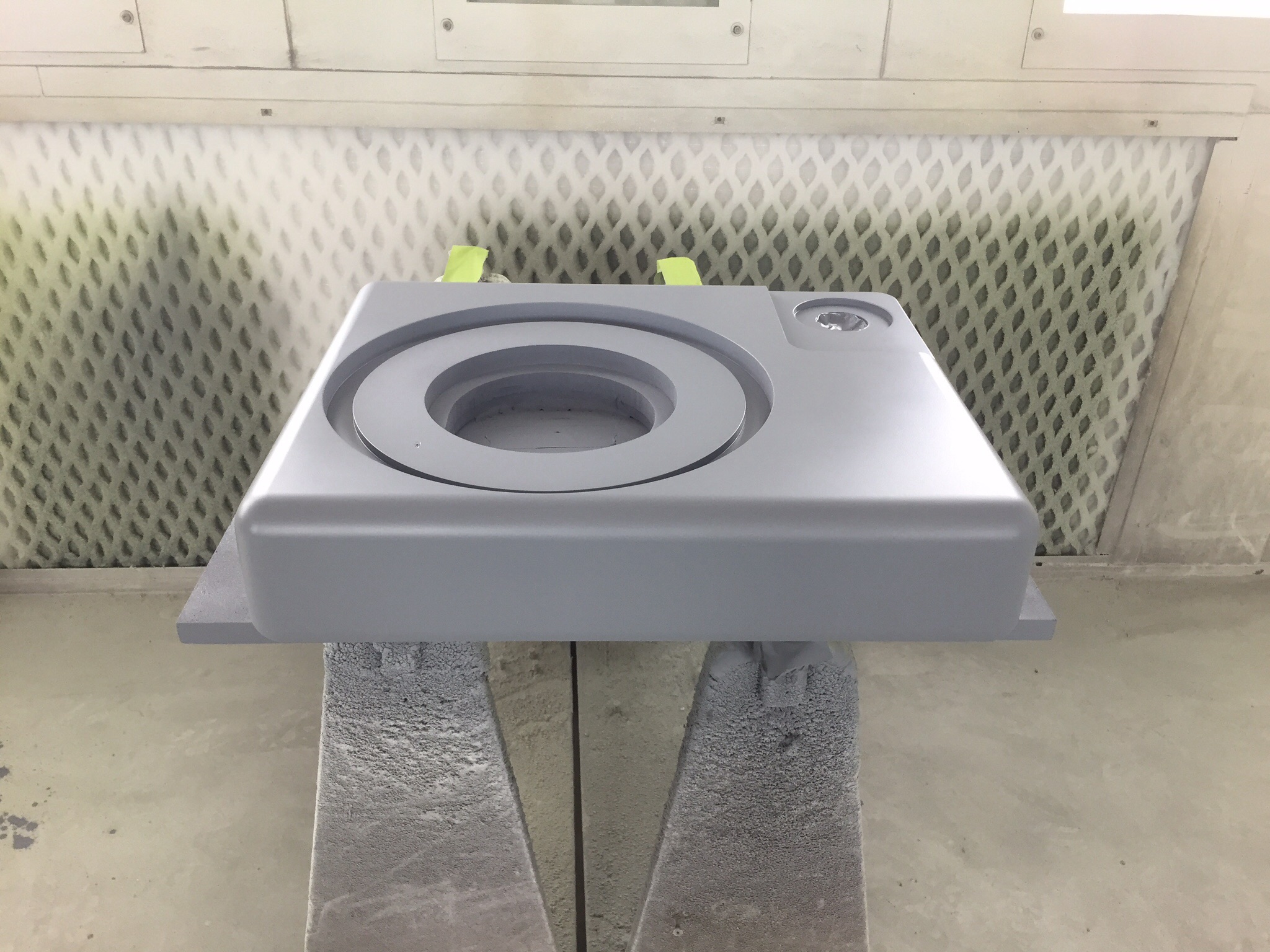

I block sanded and hand sanded the plinth with 180 grit paper to make sure the primer had something to grab onto.
Then into the booth for priming. I have access through the shop to buy Cromax (formally DuPont) automotive paints at jobber cost. I have had good results with their 2K Urethane Primer and Filler.
Cromax recommends 3 heavy coats with 7-10 mins flash (wait) between coats, so that's what I did.
I debated filling the 1/16" gap between layers prior to spraying the primer, would have saved a couple steps. But I opted to spraying the primer first as I believe it has a higher bonding strength than filler. And I know the filler and the primer bond well to each other.
Excuse the length of the details on all aspects related to the Panzer. But I can find almost no information on working/finishing this material. So good or bad final results, I'm posting my steps here.
So after 3 coats on the bottom I flipped it over and 3 coats on top

I am a bit sceptical about your procedure in two points:
a)I would fill and sand it up to the best of my ability before applying the primer.
I my experience paint will not cover sufficiently the least of discrepancy...
Maybe you should apply another coat or two of primer after filling...
b)You have prepped and cut the top for a specific tonearm.
Usually people tend to change tonearms more frequenty than turntables!
Wouldn't it be better if you had opted for a more flexible "system" on the rear right top section?
Something like a steel/bronze/aluminum plate that would be of sufficient dimensions to accomodate different arms in the future?
You could just change then the top plate and use any arm without having to redo the whole chassis...saving you from a lot of hassle and expense.
Of course all this goes out the window if you're adamant about the specific tonearm...
Anyway keep posting.
I like watching a step by step progress...

Thanks for taking the time to read an comment about my build. Great points!
To your first point. Yes, absolutely I will be following the filler with additional coats of primer. Final paint will not have a consistent sheen/finish if applied over exposed filler.
