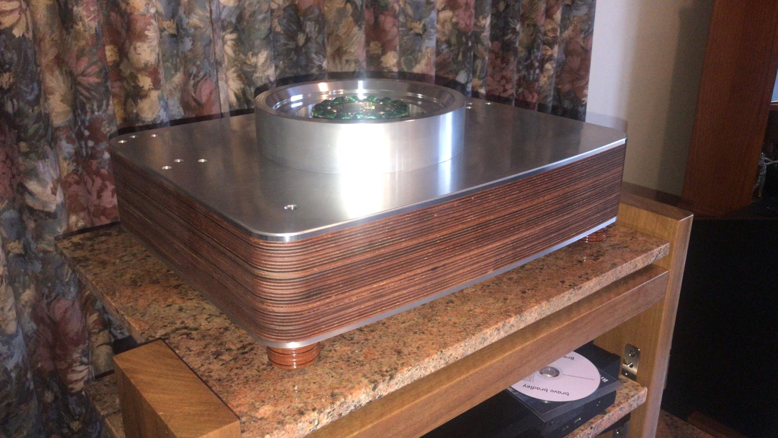

I would advise against machining the stator housing in the Permalli, there is no shielding. An aluminium housing will provide better shielding of the magnetic fields especially if the housing is grounded. The housing shown could also be fitted with a standard bearing.
Here is the new SP10 with custom motor housing. There's still a lot of work to do before it'll be playing.
