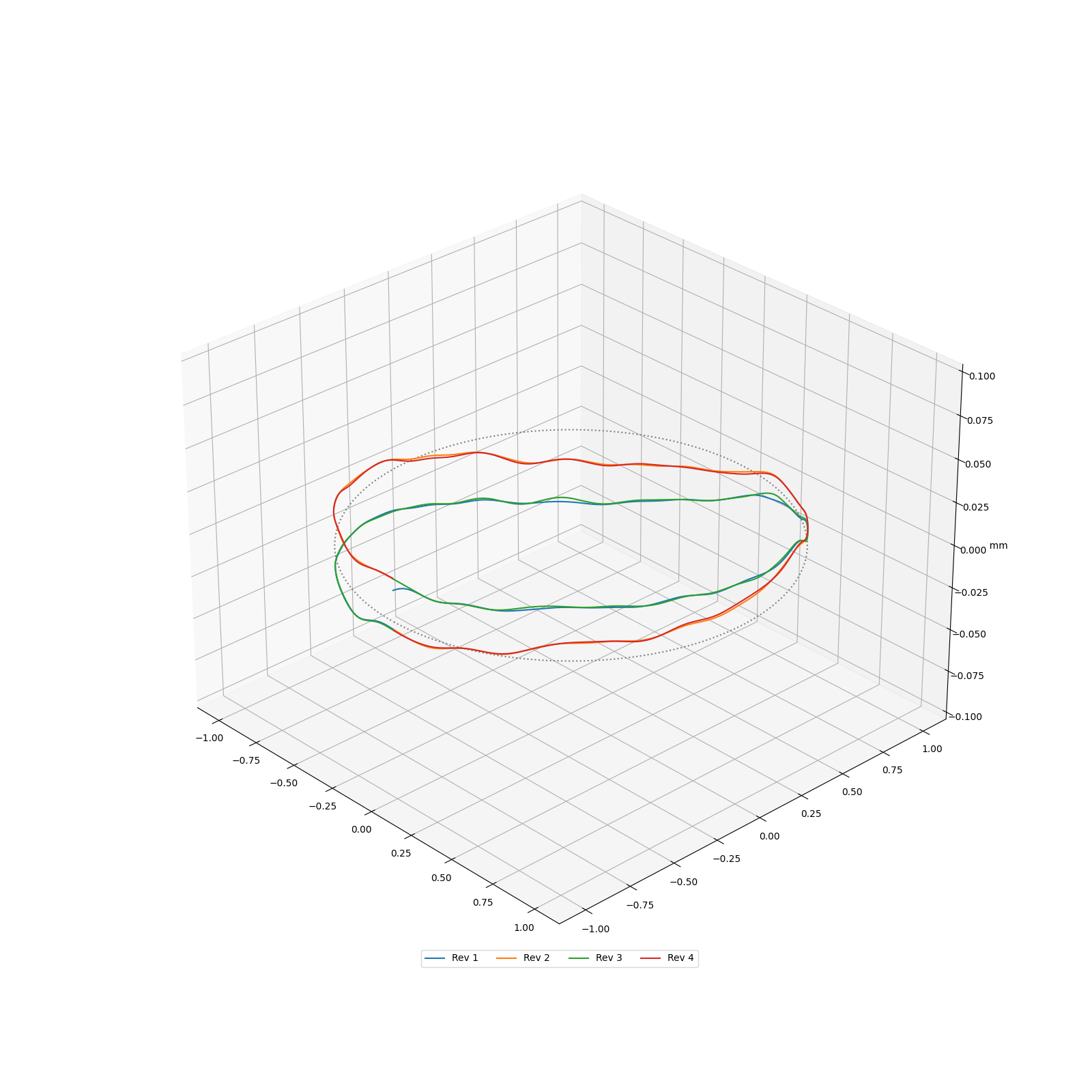

I had some unanticipated forced downtime that afforded me the window to write the script to facilitate these measurements and plots. These are laser displacement measurements of a MKII platter, taken from about 1cm in from the platter lip, spinning under its own power. This is an early unit that I imported from Japan 2-3 years ago. It shows signs of being stored in a slightly unfavorable environment. The motor is untouched.
The max deviation is 0.07623mm / 0.0030" over four revolutions. It's 0.09152mm / 0.00360" over 200 revolutions. Time permitting I'll measure it with a cartridge on a cut-down record, and repeat all measurement after servicing the motor. And, of course, measure a few more units.
For giggles, the second plot superimposes four revolutions of what I'd consider a rather flat record. Max deviation is 0.33559mm / 0.01321". Platter and record measurement are not indexed.
JP, sorry about the down time but that is interesting as heck. A couple of questions, neither of which are questioning what you did.
First, if we looked down at the curves directly from the top (I would normally call it the Z axis) would the curves be circular without most of the deviation.
Second, if not, can you show it. Or if yes, is there a way to measure it.
Given the size of the information in the groove, It amazes me the sound is as good as it is.

I'm not comfortable with making a sweeping generalization based on how a single unit measures, though I don't really see anything here that wasn't expected. Actually, I thought the overall runout of the platter would be higher. I still want to see it with a cartridge tracking at ~2g, though I don't think that'd make any difference. I've been surprised before, so would want to be thorough.
I can say for how this unit measures under these conditions, platter "problems" appear to be non-existent.

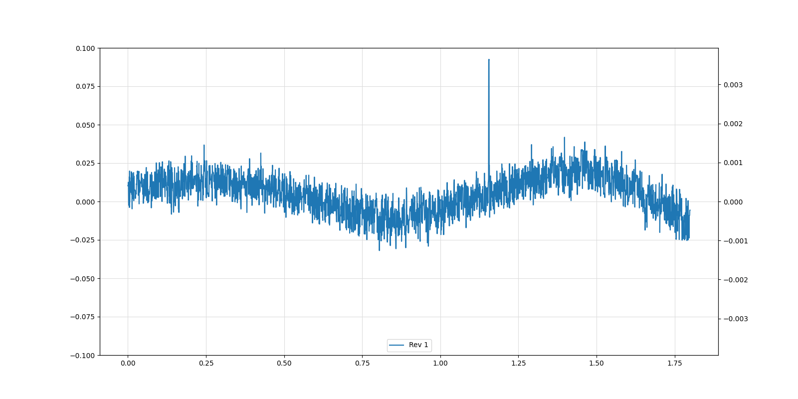

512us sampling w/ no averaging applied, 1um repeatability, 30um spot. I'm squaring the head to the platter which is plenty good for the minuscule effect to the span accuracy an error within that will have.

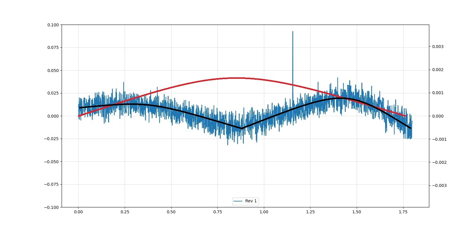

Surface noise is an issue. The above plot data had a 10Hz LPF applied for readability. Below is unfiltered with a ~1mm wide piece of tape on the platter, which is the blip at ~1.1s. So far I've yet to see anything that indicates a pulsing movement of the platter.
Getting a more friendly surface for the platter would be high on the list. I may also have a system inbound with 2.5us sampling. This isn't the intended application, but I can add it to the winter project list. I would like to see some evidence of this problem existing, and to a degree that audibly affects playback, before going too far down a rabbit hole.

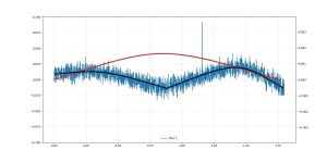

That's a better representation and easy to see the precession of the bearing. 4 or 5 rotations with the same graph would be interesting.
If this was purely runout you would expect a transition from low to high back to low in 1 revolution RED line. If we assume the noise is normal distribution and the measurement is approximately in the center Black line it's clear there are 2 high and 2 low spots in 1 rotation of the platter, with the second high spot greater in amplitude and Q. Either the platter is warped or there is precession in the bearing. This closely resembles what is seen on the DTI.

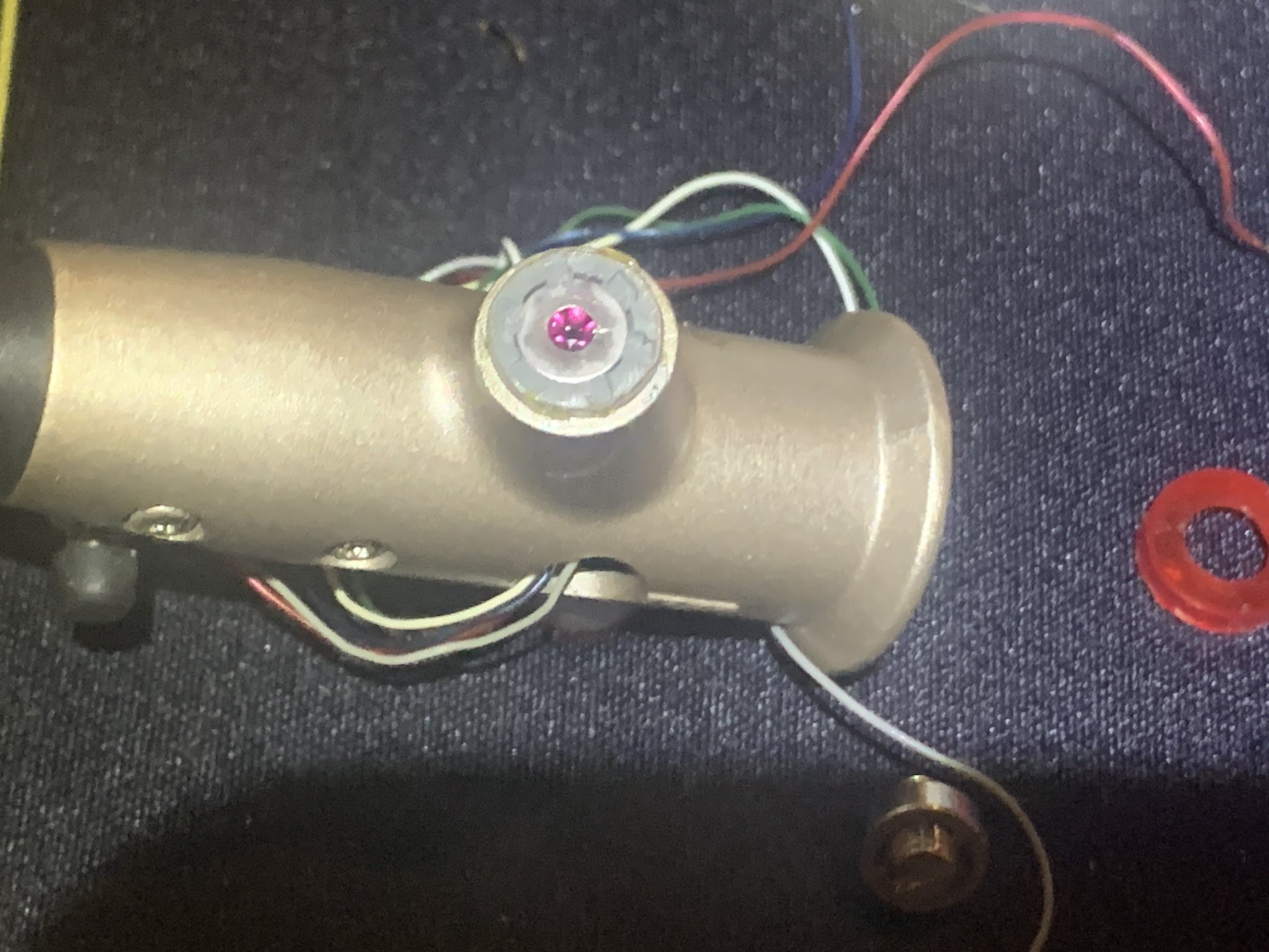

hello

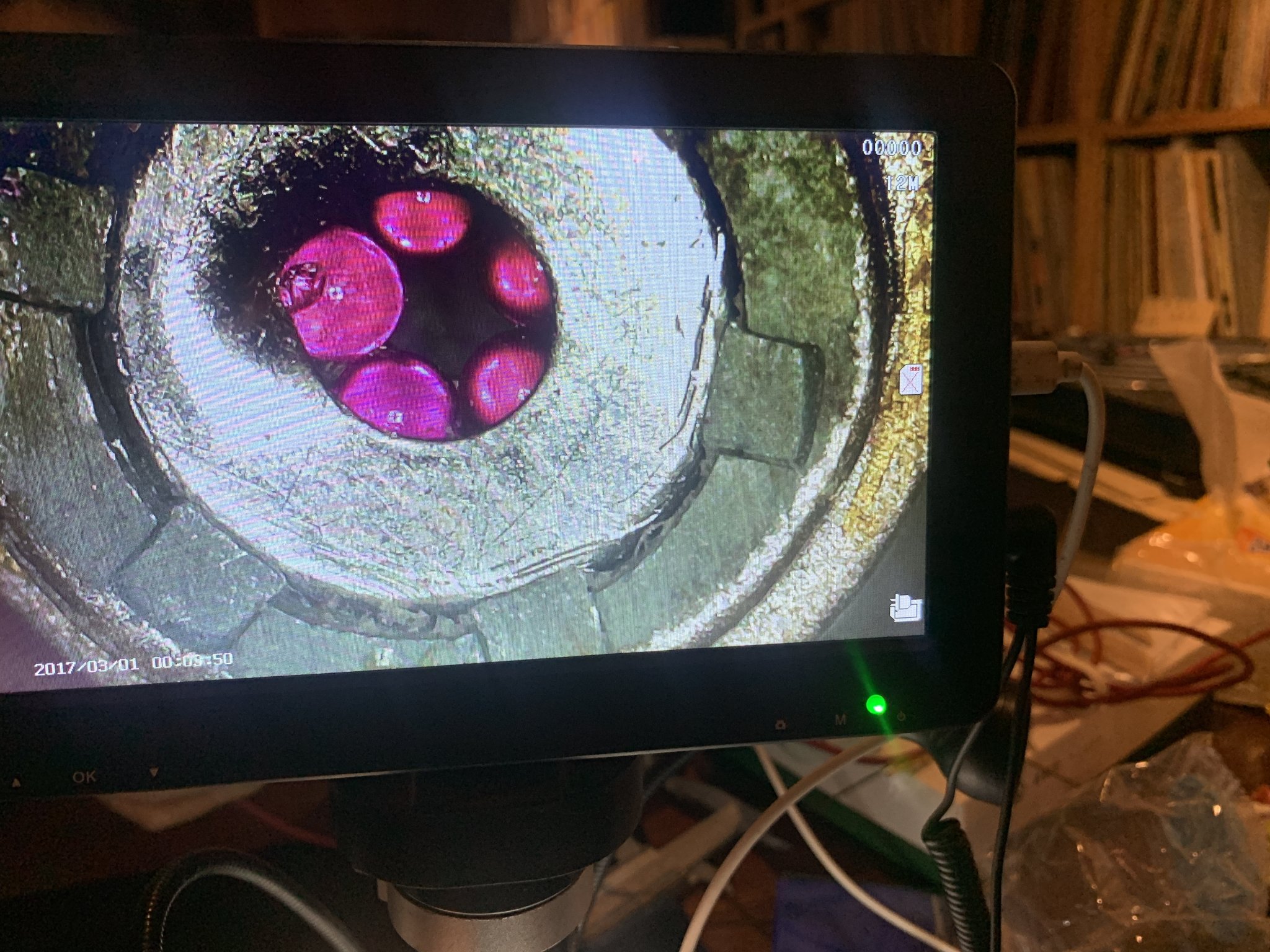

i receive a defect EPA-100 recently,
and trying to repair it by myself.
after disassembly,
i repair the anti skating.

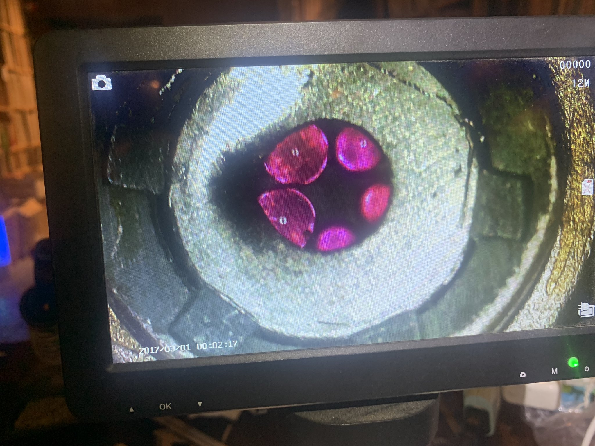

the only problem left seems to be the bearing,
my tonearm works not so smoothly in vertical.
and after disassembly, a ruby of bearing on one side of tonearm tube is cracked
but i need help now
how to remove the cover of bearing?
i've bought the SiN3 balls instead.
but it seems no way to remove the cover without breaking it?
thx for any help!
