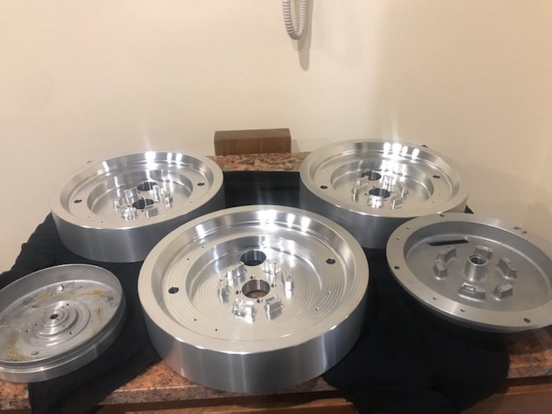

OK here is teaser - these are custom made motor housings for SP10's I'm building. The rotor housing has been digitized and will be machined shortly.
Warren, you are the endless Mark 2 innovator.
Those appear to all be the bottom piece. Are you going to do the top piece also?
Are they for the regular MK2? Inverted bearing MK2?
You are doing soo much stuff I am having trouble keeping up with you.

They are the bottom stator housing, The top rotor housing has been digitized and will be machined shortly. The OEM motor housing is cast and not overly rigid. These housings are extremely rigid and are designed to take an inverted bearing.

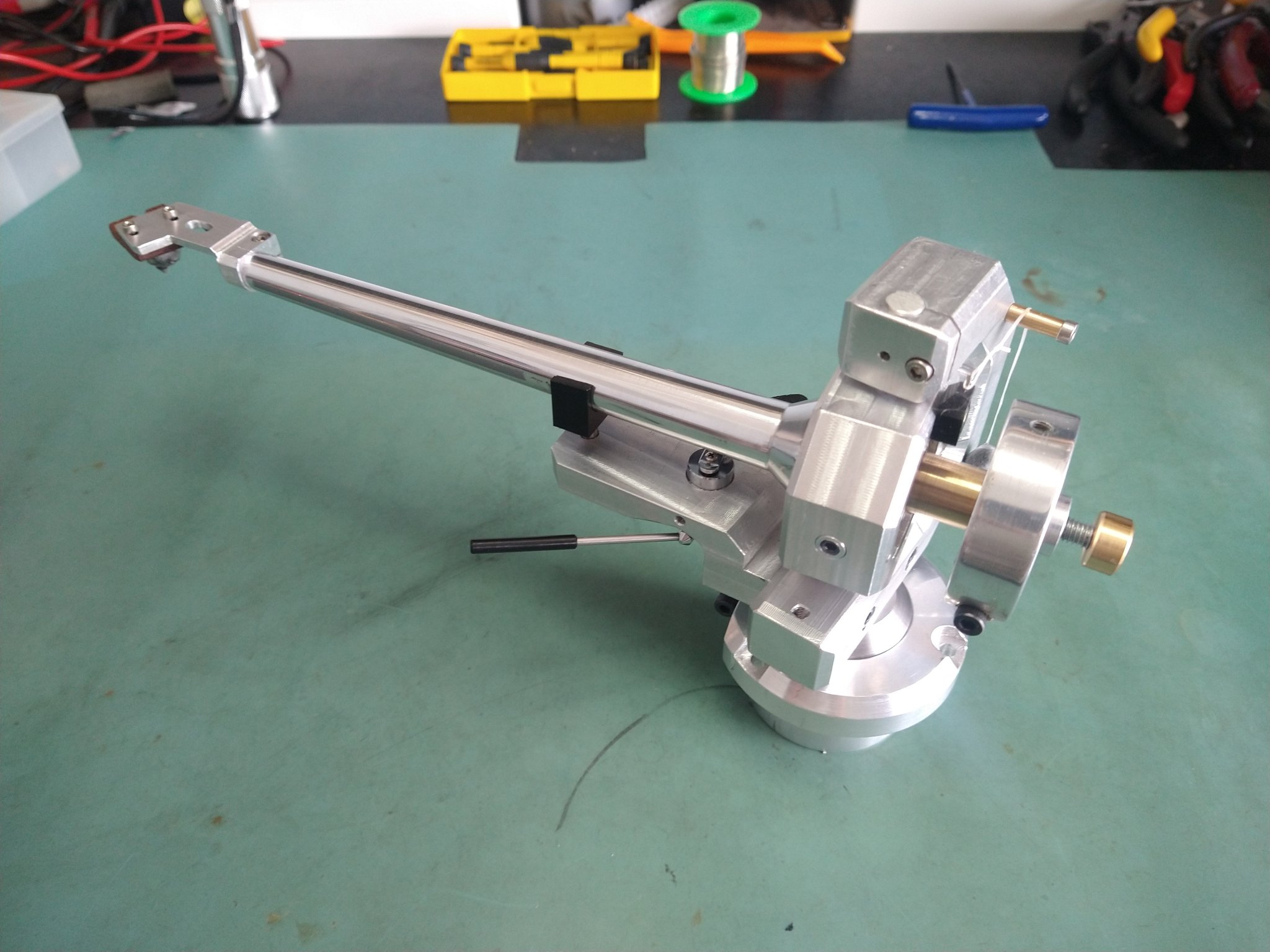

The EPA-100 is mine I installed to test the TT.
I would disagree about the sonic quality of the EPA-100 especially my modified one. If you look at my EPA-100 it has a custom CW and mounting as well as viscous damping, this elevates the arm significantly. I recently setup an SP10 with an SME 309 and Shelter 901mk2 and my SP10 with EPA-100 and EPC-205 sounded better, way more detail and depth in the music.
I built this arm and used pin pivots, they are carbide scribe points in radiused and polished M3 grubscrews. Very low breakaway torque. Sensitivity of this arm is less than 4mg
