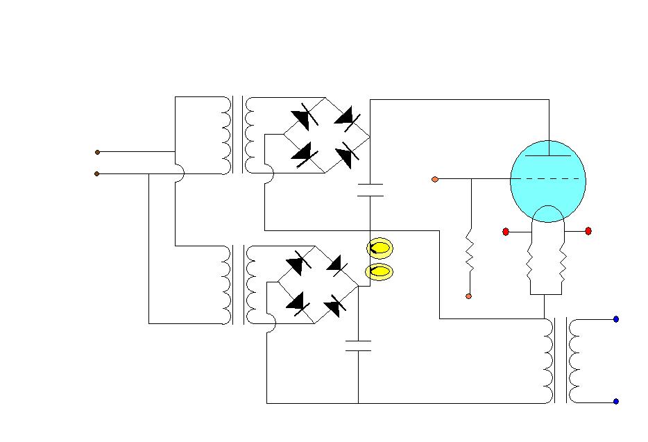

Ok, since my point about saving power by dissipating it was not understood and deleted by a moderator, I spent some time to explain it a little bit deeper.

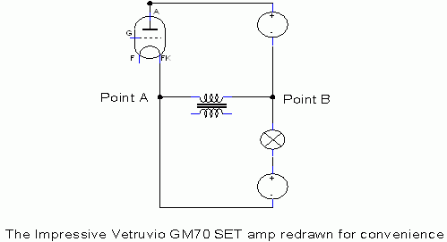

Here is redrawn for convenience of observation schematic added.
Actually, this is a SE amp. In order to compensate transformer bias an opposite current through it's primary is supplied by an additional PS and a lamp.
Without such a compensating current supply the amp would be a conventional SE amp (if to ground point A it is a common cathode amp, if to ground point B it is a cathode follower amp). And it's efficiency would be the same as of a conventional SE amp. But a lamp that is used as a ballast resistor consumes additional power. That means, it's efficiency is more than twice worse than efficiency of a conventional SE amp.
Power efficiency claimed in the item description is a sad mistake (I hope so!)

About power dissipation:
It's true, the amp continue to dissipate 100 Watts per channel as well as a normal gm70 SE with 1 KV on the plate and 0,1 A quiescent current, but in this case, these 100 Watts power dissipation are divided in two. On the GM70 there is now only 500 Volts with 0,1 A= 50 Watts. The same is for the side of the bulb.
Total amount of dissipation 100 Watts.
It's true or not that with 50 Watts of power dissipation the GM70 will live the double than with 100?
About linearity of the bulb: consider that there is a high local feedback imposed by the output signal it self to the stage. This feedback is able to compensate the non-linearity of the bulb almost at all till to 25 Watts. After it appears evident, but it's a good result in any way.
This amp is in any way the result of a compromise: my goal was to be able to set on the market a real SE mono tube tring new solutions for old (too much old) problems. In the same time to sell it for a resonable price...
Best, Ciro.

Unfortunately feedback don't compensate almost all non-linearity. A first, a loop gain in any real amp is finite. Second, it varies with cathode current. Third, internal resistance of the tube depends on a voltage between anode and cathode. That means, a cathode follower itself is already non - linear, and less linear the more effective you want it to be decreasing load resistance. Adding a plain resistive ballast load in parallel with output transformer already increases it's distortion. Adding non-linear, frequency dependent device instead of a plain resistor, adds own non-linearities.
Try to use a current source to compensate transformer bias. It would as well spend some extra power on compensation, however! But if you modulate this current source by inverted input signal you may get still SE signature and higher efficiency! It is what I did in my Alligator project. Some time ago we thoroughly discussed this matter on the forum, you may find corresponding threads if you want to.

I have redrawn your circuit so as to be more 'readable'.....in a form where myself and others might deem easier to see.
I do know how difficult it can be to design an amp with limited resources....perhaps I am being assumptive but here in Argentina resources are very limited.

Hi Rick,
I find Ciro's schematic actually a lot easier to follow, and dyslexia aside I am pretty sure your's has a serious mistake. Hopefully Ciro will weigh in.
Note where the plate and cathode of the GM70 go in Ciro's and tell me yours is the same.. Sorry..

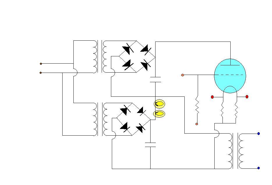

Slight mistake...don't see a "serious boo-boo. But then again any miswire will get you a poof of smoke.
Note the tap of the Cathode flipped to the other side of the OPT
Now it is better. A tube and a bulb supply opposite currents to the tranny so when they balance each other there is no DC current through the tranny.
The same result will be obtained if to connect power supplies in series, a bulb in cathode, and an output tranny between cathode and common point between power supplies. The only difference will be less fancy schematic drawing.

Hi.
Nothing fancy and nothing sad.
Fancy is drawing. Change places of a lamp and a power supply, anyway they are in series, and you get 2 power supplies in series, a lamp in cathode, and transformer between them.
Sad is the mistake in item description. It is mistake, right? Why it is sad, because people were thinking that you lied intentionally.
1) The max output power is 29 Watts: In the schematic I posted there is only the output stage that in reality is driven widely in A2 or positive grid area operation. This allows to achieve 29 Watts (I can see on my oscilloscope 25 Volts p/p on 8 Ohm=78 Watts p/p= 78/2,82=27 Watts RMS)
Actually the GM70 works almost as a "zero-bias".
What?
Zero bias current, or zero bias voltage between cathode and first grid?
2) If the non-linarity of a bulb is a so big problem, what to say about the linearity of the primary windings or inductors? When it happened that an inductor became a linear device?
Transformer is much more linear device than a tube.
3)It's true: it would be possible to connect the two power supplies in series It works, I tried already, but the point "B' is not so stable and it's more difficult to keep the offset (I still don't know exactly why).
Negative supply and a bulb are connected in series. For DC it does not matter, if you swap them, or not. For AC, parasitic capacitances would be arranged a bit differently.
I even already try to use a single power supply with a central tap output transformer , to load the plate of the GM70 with the first section and to load two bulbs 25 W/220 V in series with the second section. In this case too the quiescent current of the tube through the primary section is neutalized by the opposite current of the bulbs through the second section. The goal is always the same: to compensate the bias current in the trasformer. Just, in the last case, there is no practical advantage: The output transformer will require almost the same cares about construction and materials. It's better to make run the quescient current through the power supplies and to have an output transformer with very "short" primary only one section made.
As you may see from your schematic, there would be no difference. Just a bulb and a power supply that are in series are swapped. При перемене мест слагаемых сумма не меняется. The same current flows through devices connected in series, no matter how to swap them.
4) It's easy to have these good ideas after I posted the schematic...
Good ideas existed long before you drew your schematic. Almost all transistor amps currently on the market work similarly: bi-polar power supply, and a load between amp's output and a center point between power supplies. Lamps to load devices were used, but discarded because of their non-linearity. It is not a good idea, you have to admit. Plain resistor would work better. Current source even better. Modulated current source would work the best (like in my Alligator project, when 40W output was obtained from single GU50, and many other designs already discussed here).

Hello Ciro,
I was trying to validate your power and anode efficiency vs. lamp load power etc. and things don't seem to add up.
This post provides the missing information... If you have 25V peak-to-peak into 8 ohms, the output power is about 9.75 watts.
The formula for watts is Vrms^2/Rload. Vrms is Vpk-pk/2.83
in other words, you must divide the pk-pk voltage by 2.83, then square, then divide by the load resistance to calculate power.
BTW, there is no such thing as "peak watts"*. Watts is watts. (Hint: what happens to the units when you square the Root Mean Squared voltage?) Peak watts only exists in audio amplifier marketing claims.
Michael
* What I mean to say is that "peak watts" is meaningless as an engineering unit
Hi.
Hello Ciro,
Michael
