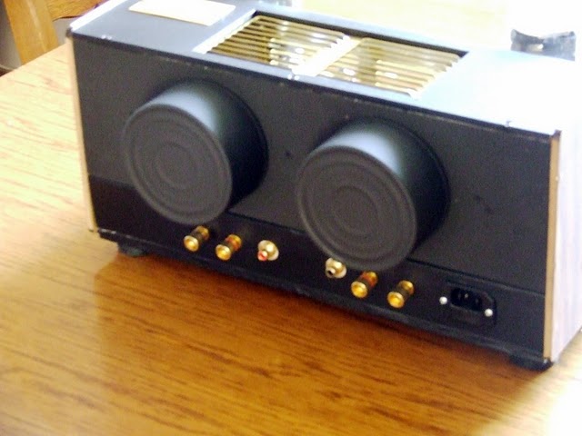

Here is a pic from their website. For the life of me, it looks like it has two Tuna cans of the back of the cage.
You can even see the lip on the end attached to the chassis panel. Sure looks like one to me :spin:
I think they have a name for this: "Adaptive Reuse" illustrating clearly that the designer of this amp does not suffer from "Functional Fixedness." :eek:
In the interest of honest disclosure I have a pair of Progresso soup cans awaiting a similar fate - they are just screaming for some ill-advised use such as this.. ;)

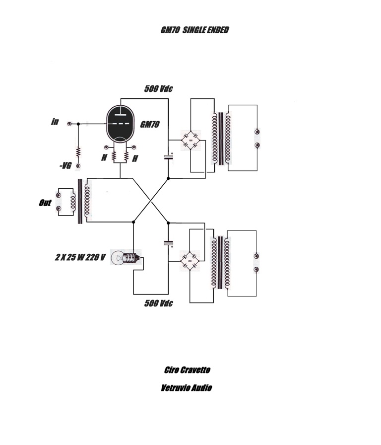

The amplifier is sold on eBay and the guy who opened this thread is a forum member who was curious about the merit/lack thereof of such a design.
I have heard very similar amplifiers, as I indicated in an earlier post there was a time when this was a bit of a cheapskate fad around here, and believe it or not they do work, and they don't sound terrible either - however and this is the point, these were hobbyists experimenting just for fun, were well aware of the serious performance limitations of the approach and admitted such.
I'm not sure anyone should be selling such a design to the public, however a truthful disclosure of the technical limitations of this design, and an honest statement of the power output capability would be a good place to start. They could bill it as an experimenters amplifier and explain how it might be an economical starting point for someone wanting a GM70 amplifier.. They could even sell the "upgrade kits" to take it to a more conventional design.
In terms of tube life, the cathode current is pretty high regardless of the actual plate dissipation so I would not expect this design to have significantly better tube life than mine which will run at twice the dissipation and roughly the same current. I doubt tube life of much more than 1K hours is even likely with this tube, but until I run through a set or two in my own yet to be completed amps I don't really know. CCS heating of the filaments is unlikely and I expect filament failure kills a lot of these tubes if not a serious drop in emission. (They run really HOT)
Unfortunately these guys have probably figured out that spelling it out as it is does not result in many sales particularly on eBay.
I find it hard to believe that the published design differs significantly from what they are or have been building.. Sadly a simple plate choke would eliminate most objections to this design, and result in a significantly better performing amp even with the apparently undersized toroid they use as the OPT..

Hi, there.
I am "Mr Vetruvio" or, if you prefere, Ciro Cravetto from Italy. The disigner of this amp.
1) There is written nowhere that the schematic visible on my site is the same there is inside the amp.
2)Here you can find the very basic schematic of the amp actually for sale. The amp is a circlotron in S.E.: the bulb on the other side works as a constant current generator and allows to achieve a perfect output offset without any continuous current in the primary winding of the the output transformer. It means that there's no need of any output capacitor.
3) Yes, it true: this design allows to save some money
4) No chinese is doing something like this.
5) The output power is 29 Watts RMS!!!
6) The boxes where I placed the output transformers are not for tuna, but for meat and they are perfect for to resin inside the trasformers. Any way they are painted.
7) Output transformers are toroid and they are made by me as well as the power ones and as well as the case.
8) This forum is a "scientific society", so I am sure that you will be able to find out a driver of this output stage. I did not published because probably you will do a better job.
Good luck, Ciro Cravetto
