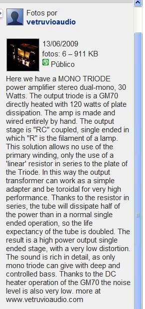

Awesome diversion from schematic discussed 🙂 Would you then care to explain these anyhow (in reference to the new schematic you posted today):
1: What is the impedance of a lightbulb running off 500V and how would it compare to (A) choke the size of the light bulb supply transformer and (B) output transformer the size of both lightbulb supply + existing OPT combined ?
2: Why would a circlotron require a coupling capacitor ? (you mentioned yours doesn't so this must be something unorthodox, a circlotron without one)
3: You mentioned this design saves some money. How much (in relative figures, I understand you wouldn't want to reveal absolute numbers) more does a choke cost compared to the price of the entire lightbulb section, including its transformer, filtering and other bits ?
4: I believe you mentioned output power, 29W if I'm not mistaken. What is the efficiency of your design and how would it fare compared to an amplifier with a true reactive load (efficiency-wise) ? An easy one for the engineer among us 😉

I am both a DIYer and have a PhD in electronic engineering, as well as a BSc degree in physics. Having worked for many years in industry, I found that some professionals know less about their job than I know about my hobby.
We were commenting on the circuit diagram and blurb which was placed in front of us, which appeared to come from your website. If these are not descriptions of your products, then of course to that extent our comments do not apply.
A 25W/240V bulb will consume approximately 105mA at 240V, two in series with a 500V supply would represent about a 5K load.. This is actually an interestingly clever design - you might want to do a little analysis before you criticize further - as a cost saving approach it is certainly original.
The reference to saving a coupling capacitor is in reference to the typical parafeed which this most definitely is NOT. (Since there is no dc current through the transformer no gap is required.)
This is an interesting design, and it is a shame that the schematic and product description do not mention this interesting design twist. (And the fact that it is a variant on a circlotron should have been disclosed on eBay.) I am not sure that a resistor would not have served just as well, but 100W power resistors (I derate to 50% of power rating in my designs minimum) are a lot more expensive than a pair of 25W bulbs..

To Kevinkr: the output power is 29 Watts if the output stage is correctly driven. As you know in a circlotron the tubes (the tube in this case) are cathode followers. It means that the stage does not have voltage gain. So, the output signal will have the same amplitude of the driving one, a part the "current" gain of the cathode follower it self. The advantage is that this output signal will have a very low impedence compared with a plate output and will be able to drive aprimary winding much more "short" .
Actually the output transformer has a transformation ratio of 18.3. So, if a power of 29 Watts on 8 Ohm means 15 Volts RMS out of the secondary winding, on the primary it will be required 300 Volts RNS from the output stage. It's not so difficult to have 300 Volts from a driver stage with a voltage supply of 500 and 500 Volts on the plate of GM70 are more than enough for to pass out 300 Volts from this tube in cathode follower operation. With a transformation ratio of 18,3, the primary winding will have an impedence of 2700 Ohm.

Using a non-linear resistor as a cathode load will do much less harm than using it as an anode load (provided the valve is really acting as a cathode follower - this depends on how the grid is driven), but it is still non-linear - not "linear" as claimed in the blurb. A low wattage bulb such as 25W will have a thinner filament so will have a shorter thermal time constant than a more powerful bulb. It will react to low frequencies. Advantages are that it is cheap, and behaves a bit like a CCS.
By the way, why do people draw a circlotron with crossed over lines? It seems to hide the fact that this is just a cathode follower with a centre-tapped PSU. Is a single-ended circlotron really a circlotron at all?
I don't see it as a Circulatron, it appears to me to be an SE amp (probably with a non gapped transformer) using a lamp as a current limiter and additional power supply to neutralize the transformer dc bias current in the OPT.

I am "Mr Vetruvio" or, if you prefere, Ciro Cravetto from Italy. The disigner of this amp.
1) There is written nowhere that the schematic visible on my site is the same there is inside the amp.
2)Here you can find the very basic schematic of the amp actually for sale. The amp is a circlotron in S.E.: the bulb on the other side works as a constant current generator and allows to achieve a perfect output offset without any continuous current in the primary winding of the the output transformer. It means that there's no need of any output capacitor.

Please excuse my earlier sarcasm, and understand that on face value your claims in the attached ebay listing do not hang together. Is a light bulb any more linear than a simple resistor? Or maybe you mean to say that it holds constant current, which is clearly not the same as linearity.
On what do you base the claim that the output stage is power efficient (uses less power) when it has a current balancing load that needs to dissipate as much power as the output tube? How does adding an extra load increase the plate efficiency of the triode? But then, that's not your claim, only the implication... Double the life expectancy? Class A 30W output requires a certain plate dissipation +/- only 10 or 20%, no way to reduce it by 1/2!
Also, note in your description you state that the output is SE and RC coupled with the light bulb in series with the plate of the triode (I summarize). This to me describes the free schematic of the SE GM70 posted on your website more closely than the schematic you posted above. Why do you call it RC coupled series SE in your ebay ad and then tell us it's a circlotron with no output capacitor? That at least is cause for some question.
Other issues may be related to translation to English; you probably meant to say that the OPT primary winding doesn't need to pass the DC operating current for the GM70, not that it isn't used at all.
