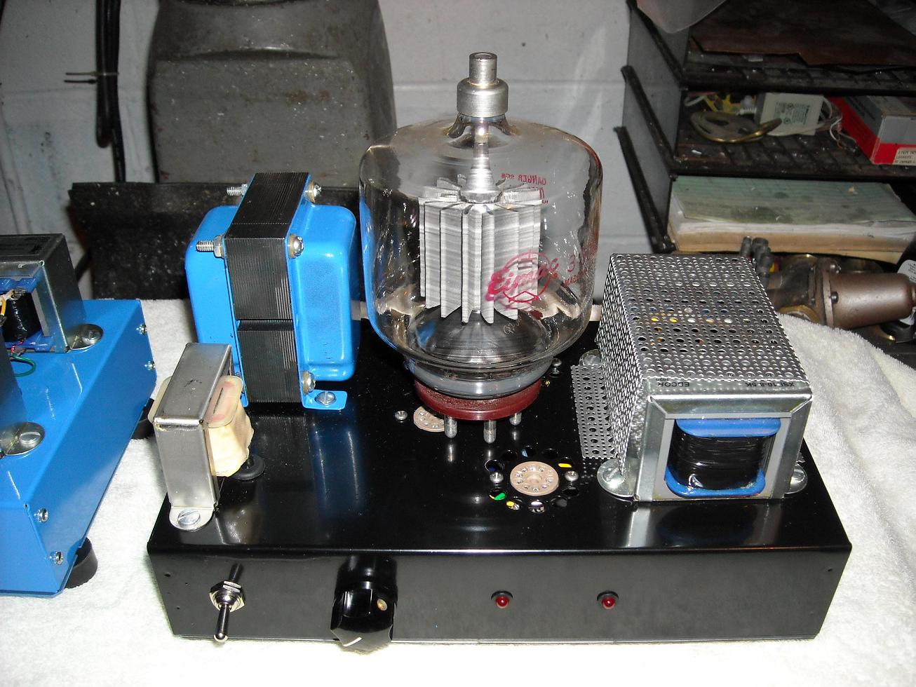

I've got a pair of supposedly NOS 3-500Zs, do you think I could cram one in each FireFly chassis? What size lamps would I need?

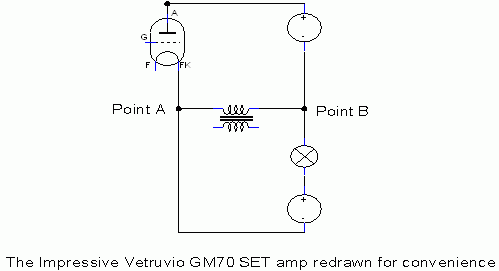

"That checks out for this amp producing about 10W output.
This amp is SE, no help from the bulb; in fact the opposite.
388V peak into 2700 ohms is about 27.8 watts. The lightbulb at 5K dynamic resistance consumes 15 watts, leaving 12.8 watts at the OPT primary.
So as a reality check on the claims, based on the information provided so far, the anode efficiency of this amp is 12.8% -- at best -- and it produces about 10 watts of audio power at the speaker terminals "
Ah, right you are. I was assuming the 100 mA idle was correct for the stated 29 Watt power. But 29 Watts output would actually require 150 mA idle due to the bulb losses. 100 mA idle with 388 V peak would work for a CCS loaded design to get 27.8 Watts.
Also, 100mA into 2700 ohms only swings 270 volts peak positive at the plate, maybe more negative in A2 for a quite asymmetric current swing and less RMS plate swing.
Anyway it's been real...
Sure! But you need some filament PS underneath. Do you think a SMPS would be Ok?
About the time I was ready to hit the post quick reply button it dawned on me that to do so would shunt the voltage swing on the transformer dampening any output and killing it.
There was a circuit for a highly regarded amp floating around the internet about 10 years ago. It used a 211 in SE on one side of a P-P OPT and a second 211 configured as a "CCS" on the other side of the OPT.
It dawned on me at the time that simply wiring a second triode and biasing it up similar to the first except that it was undriven was an easy way to waste half of your output power in the Rp of the undriven tube. It is entirely possible to make a pentode based CCS with a high plate impedance to accomplish this. There were threads discusing this several years ago. I was thinking 845 for the output tube and 813 for the CCS. I got some cheap "845 SE OPTS" from the same guy that ripped everybody off on Ebay several years ago and I used them instead. They aren't half bad and the amp sounds very good.
Depending on how many extra tons of AC you add to your house, you could use the 3-500Z for the output tube, and a 4-400 for the CCS.
And GM-70 were driving GM-100 tubes.
In my case I have about a dozen live 833A's. At 100 watts just for the filament I have given up on building a really big amp. We have been having record heat and my recently replaced central AC can't get the house below 81 degrees in the afternoon. I will stick to P-P sweep tubes. This seems like the most efficient way to make big power.

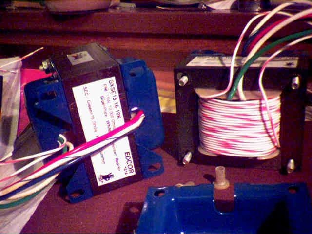

Buck Winding
Here is a way to use a low voltage CCS to balance the current in an OT. A buck winding has been placed in the available space remaining on the xfmr bobbin, in this case a SE OT. This way a 5 Volt power source can power the CCS. The CCS could also be a modulated current source to double output power.
This approach avoids the need for a doubled B+. And for a gapped OT, one can then remove the gap spacer (or just reduce it's thickness) to greatly improve the inductance for LF performance.
<snip>
Maybe I missed a post somewhere, but I am wondering if we understand at all how this output stage operates?
The bulb definitely does consume power, however to calculate the actual output power you need to treat the bulb's shunt dynamic impedance as being in parallel with the 2.7K opt not as a separate entity.. In a sense it is part of the output AC load the GM70 sees, but to some degree the reverse might also be true. The thevenin equivalent impedance of the opt and bulb in parallel is 1.75K and hence the load the GM70 sees is 1.75K, not 2.7K and given the ratio of the impedances roughly 2/3 of the power should be delivered to the load, and 1/3 is wasted in the bulbs. Since the OPT is a toroid the DCR is probably quite low, as a swag probably well under 100 ohms.
Note that this is not really a cathode follower either - both the plate and cathode contribute to the audio output - I think the potential voltage swing across that transformer is far greater than we realize. Hint: Take a look at the audio voltage across the secondary of the OPT when the GM70 is driven towards cut off.. It's NOT zero. The voltage developed across that output transformer will be result of the sum of the currents flowing through it from both legs - Obviously because one leg is passive (undriven) the behavior in the current domain might be rather asymmetrical. It is not nearly as simple as it first appears.
I think we need to do a simulation and a better job of analysis than we have so far.. Perhaps it would be worthwhile for someone to build this circuit with parts on hand to see what it actually does.
I choose to believe Ciro's comments on output power based on his measurements until such a time as someone does a viable analysis or simulation and/or someone builds it.
Perhaps I have missed something fundamental that you all get and I am all wet..
For the Edcor GXSE15-16-10K shown, I was able to fit 24 turns of #20 wire onto the available space. I used Teflon insulated wire to take the heat. With 3600 turns on the primary and 24 turns on the buck winding, I need 7.5 amps thru the buck to neutralize 50 mA thru the primary. Using the secondary for 8 Ohm at 15 Watts then requires a peak voltage compliance of +/- 2.56 V for the CCS, so 7.5 VDC should work for the CCS. The buck winding has a resistance of 0.14 Ohms, so should dissipate 0.14R*7.5A*7.5A => 7.9 Watts. The CCS 7.5A*6.45V => 48.4 Watts. (6.45V = 7.5V - 0.14R*7.5V)
Since I only plan to use it for a 6BQ5 with 6 Watts output, the CCS only needs +/- 1.62 V compliance, reducing the CCS dissipation to around 7.5A*3.95V => 29.6 watts. (3.95V = 5V - 0.14R*7.5A)
Obviously all this pointing out how inefficient CCS balancing is. And resistive balancing would be hitting almost twice this loss per watt output.
Later I intend to try modulating the CCS to double power output and lower the loading (increase R) on the 6BQ5. Then measure the FFT to compare with the original CCS case. Also plan to try removing the gap spacer, which would no longer be necessary, and check the FFT again. If that all works well, then I will only be using P-P transformers for SE from then on.
On Ciro's circuit, the resistor leg does indeed absorb about 1/3 the power output. The tube side doesn't really matter what confijuration it's in (other than the grid drive required), its just a SE stage. Compute its off voltage to its on saturation voltage at 2X idle current and thats the peak to peak V swing. (obviously the grid has to go positive to get to 2X idle current) That V swing should jive with the 0 to 2x idle current swing across the equivalent loading (bulb plus OT in parallel) One of the confusing factors there was that the bulbs, as configured, will not support sufficient idle current to get the stated power output. Needs around 75 Watts of bulbs (linear R assumed, to draw 147 mA idle) instead of 50 Watts.
I'm getting some very interesting results from initial simulations of Ciro's circuit. Hopefully I will be able to derive some real understanding, but the initial results look like Ciro's reported output powers are achievable. Very, very large voltage swings are possible across that OPT. (Despite my earlier comments they appear rather symmetrical.) Based on a very shaky analysis and the resulting simulation significantly more than 700Vpp appears possible across the OPT - this may be optimistic but indicates output power in the range stated is possible.
You can get some mis-leading results easily if the tube is biased to draw the required 147 mA idle current (Uhh, actually a little more than 147mA idle is required since the bulbs will not drop to 0 mA at the positive signal voltage peak) because the OT will not be setting with 0 mA idle current (actually the OT won't be setting at 0V idle either if there is a little R in the OT ). So the OT will not be balanced, but the Sim will be showing the required +/- 394 V swing.
Lets see, with a 100 V still on the 50 W bulbs at signal peak, they would still be drawing 20 mA, so idle current needs to be increased to 147mA + 20ma => 167 mA to get the required +/- 147 mA swing. Well, this interacts back again in the calcs, add infinitum. Really needs more like 100 Watts of bulbs for pullup to the +500V. Make that line cord wattage from my earlier calc. more like 750 Watts draw to get 29 Watts audio per channel.
