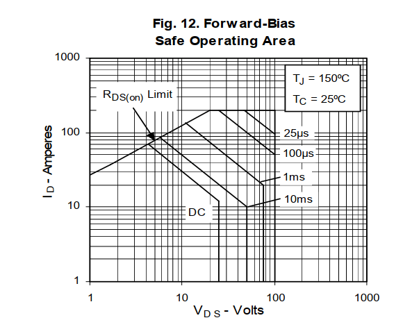

Hi TAThere is another pairing to consider - IXTQ75N10P with IXTQ52P10P. It would likely perform best at higher rail voltage and bias current, say 26.5V and 1.5A to 1.7A.
I am already familiar with the sound of the 75N10P at that operating point, it is quite wonderful.
i am afraid of the SOA of that chip. Nelson Pass wrote in some very early comment that he tried a lot of MOSFET and if i remember right he give a kind of "warning" about SOA DC.
so the Figure 12--> SOA of that chip just show a DC area up to 25V.

Certainly it is best to exercise some judgement when using the IXTQ75N10P. I have been using them mainly in my F6 variants with +/– 26.5V rails, source degeneration and feedback. They also worked well in my souped-up ACA, which limits them to about 15V Vds.
