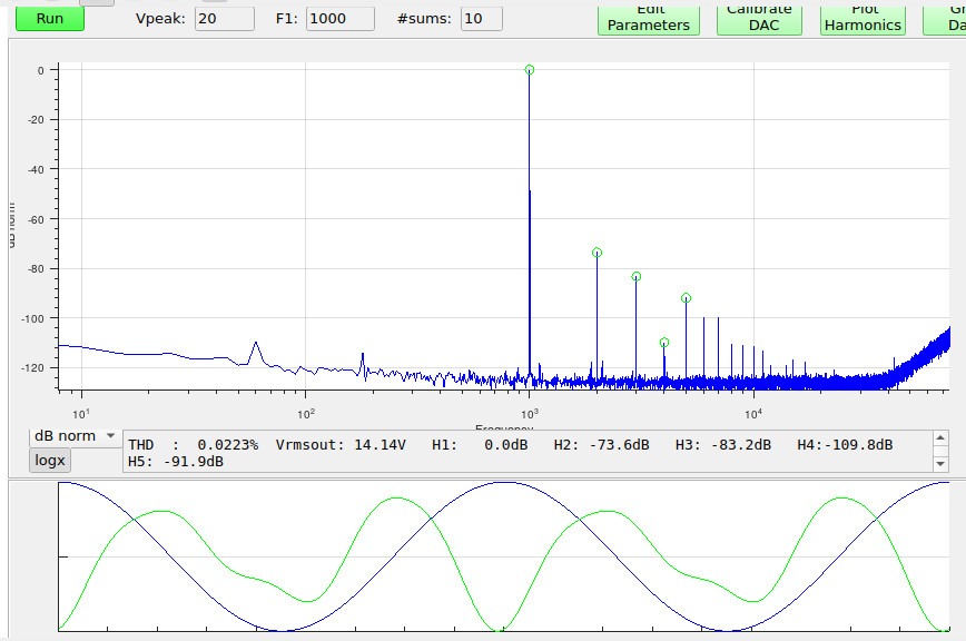

The interesting thing about the undegenerated push-pull source-follower is that with the proper choice output FETs the behavior smoothly transitions to class AB at high output po lwer levels, assuming that to power rails are high enough. Yesterday is bench tested my prototype amp:.How to include the Class AB feature of the M2OPS (with the LM385s) with this ?
https://www.diyaudio.com/community/...in-class-a-b-and-maybe-a-power-whammy.390636/
Thinking out loud,
Patrick
- Rail voltages: +/-24V.
- Bias current: 1.3A
- Output load: 4 Ohms
I couldn't test at much higher output levels being limited by +/-24V rails and current limits of the SMPS.

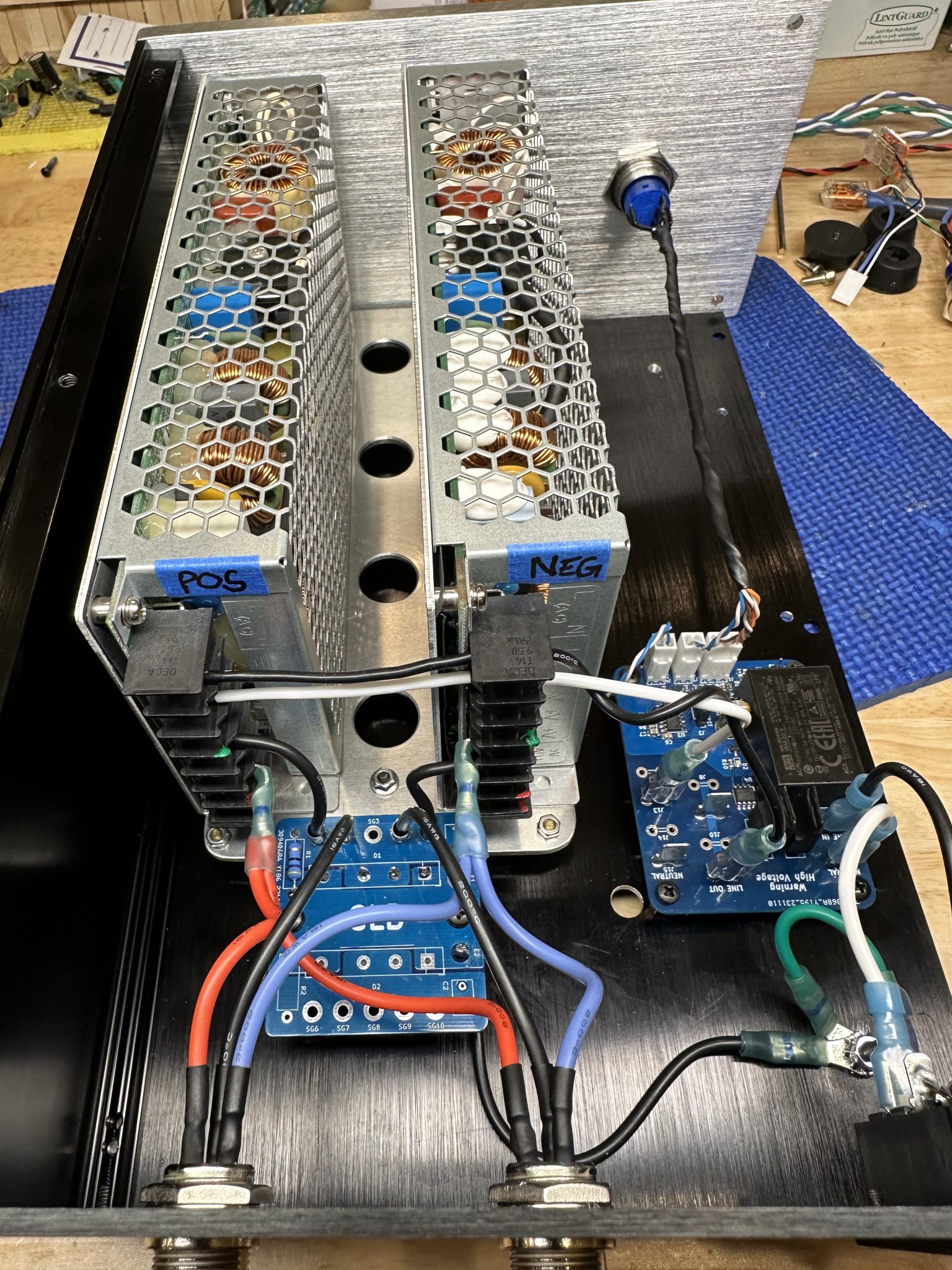

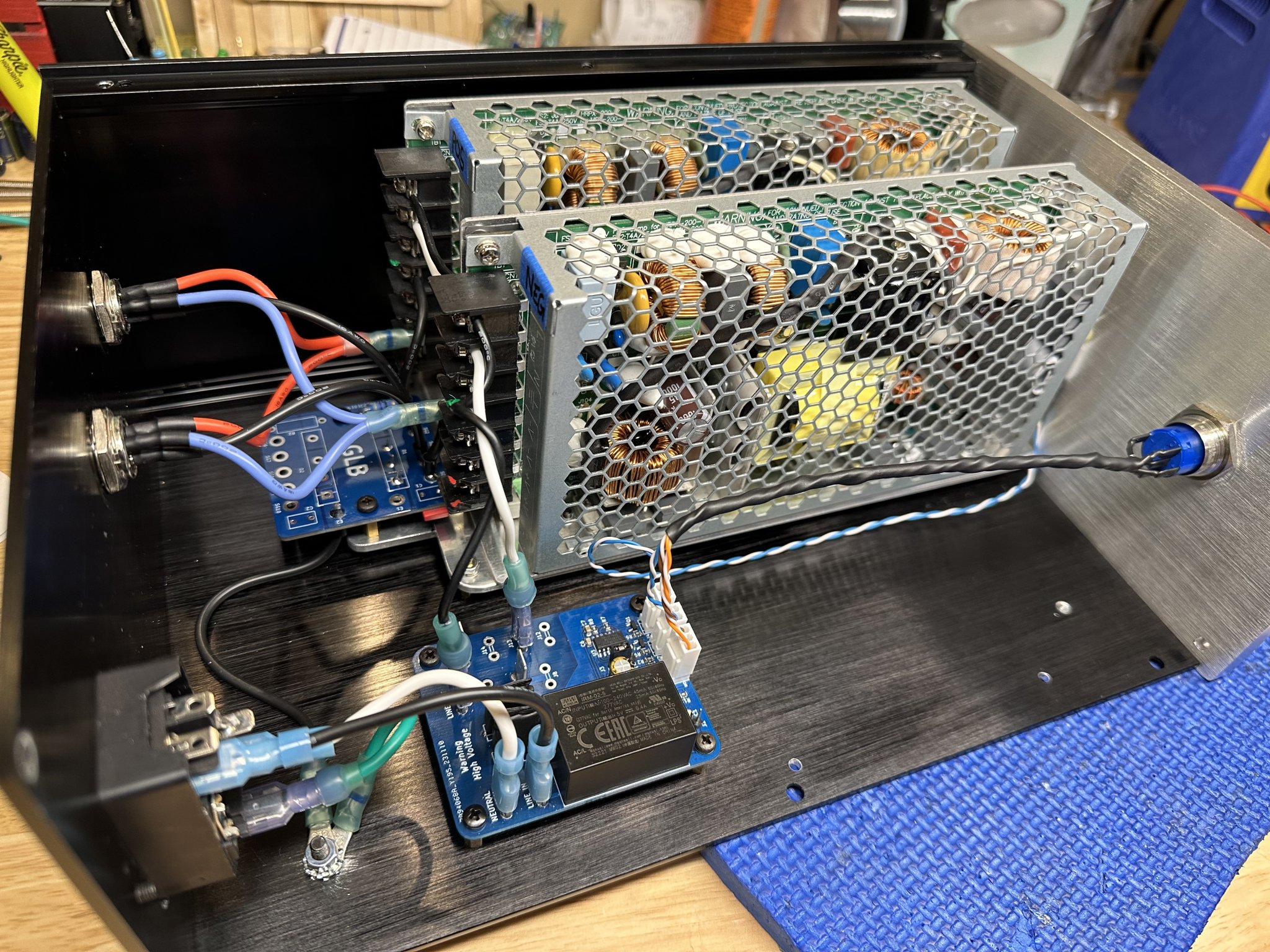

Hi lhquam,
The very good results you shared using the Meanwell switchers wired for a bipolar psu gave me motivation to improve the setup I was using. I reclaimed an old chipamp chassis to build an external power supply using a pair of Meanwell HRP-200-24 units already in my stash. I used a GLB pcb to create the common connection with 47R in series to star gnd.
Hopefully will get to put it into service soon!
Can you explain further what the 47R resistor does? Did you possible mean 0R47 for use as a ground breaker?I used a GLB pcb to create the common connection with 47R in series to star gnd.

I have tested five different sets of output FETs and the FQA28N15/FQA36P15 FETs are the clear winner. That doesn't mean that other FET pairings will not give good results. I will soon post the comparisons.
The PS can be either SMPS or linear. I have tested both. The linear supply is more expensive, but has better known properties w.r.t. noise and some other potential issues.
