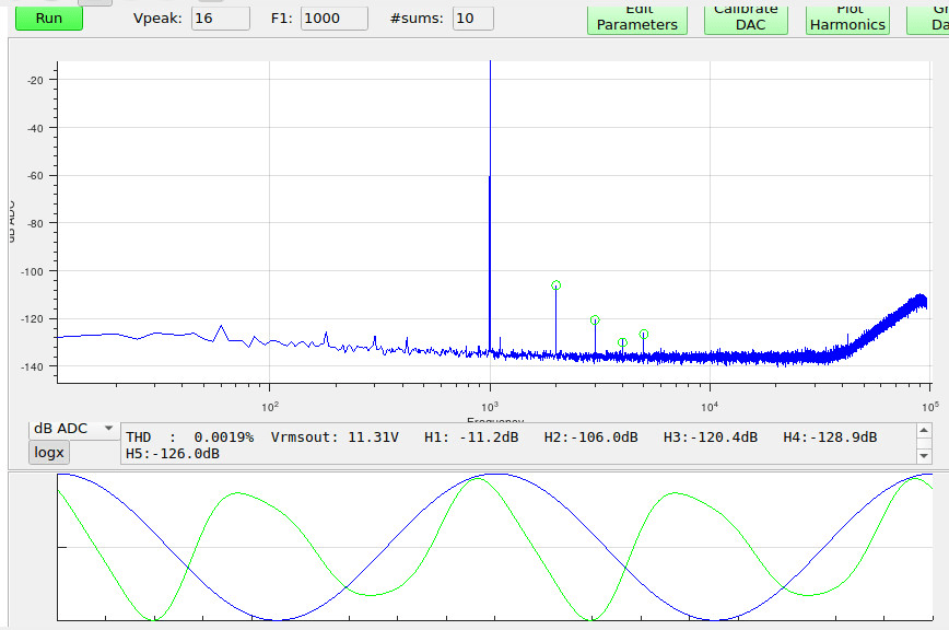

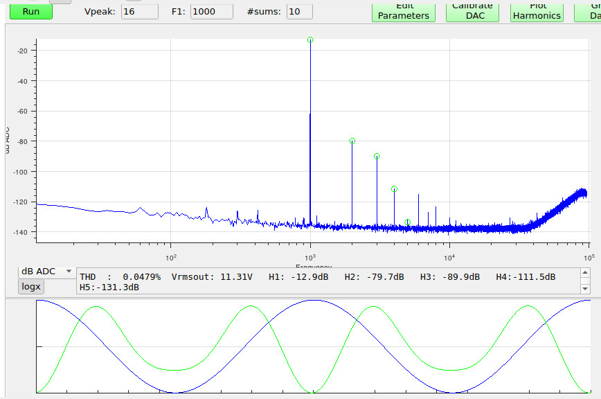

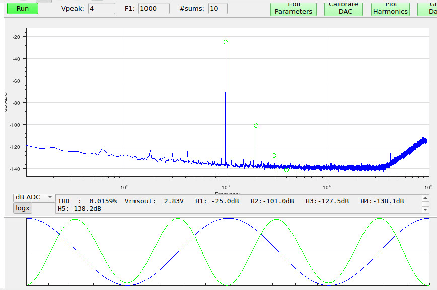

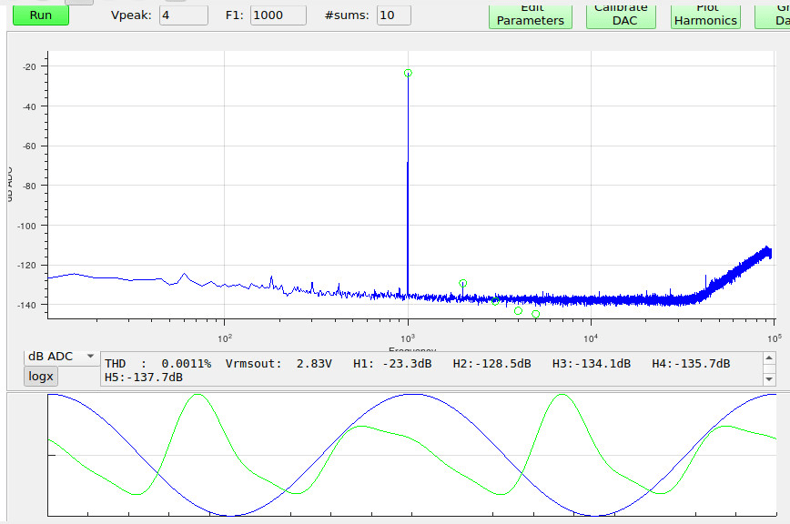

The exercise is the overall amplifier performance. But here are some measurements of the output stage without feedback.
I do not have a distortion-free source for +/-20V to drive the OS other than the opamp.
Here are some spectra with no global feedback, the feedback loop is only around the opamp with the same closed-loop gain.
Spectra 1 and 2 are for the amp output 1kHz into 8R at 1W and 16W.
Spectra 3 and 4 are for the opamp output under the same conditions.
The spectra without global feedback are essentially identical to these shown with 12dB global feedback but multiplied be a factor of 4 (12dB). The opamp output has a minor contribution to the spectra.

For 1 Watt 1kHz into 8RSo we can deduce that the OPS itself has H2 of about -75 dB, and H3 of -100dB.
Is that correct ?
Not too different from those measurements of twitchie with the standard M2OPS with the same devices.
(Post #31)
Patrick
H2 is about 76dB below H1 => 0.016%
H3 is 26dB below H2 => 0.0008%
These numbers are somewhat better than those in post #31, but H2/H3 is about the same.
Even at full output of 25W with 12dB global feedback, H2 is only about 0.012%. Can you hear that?

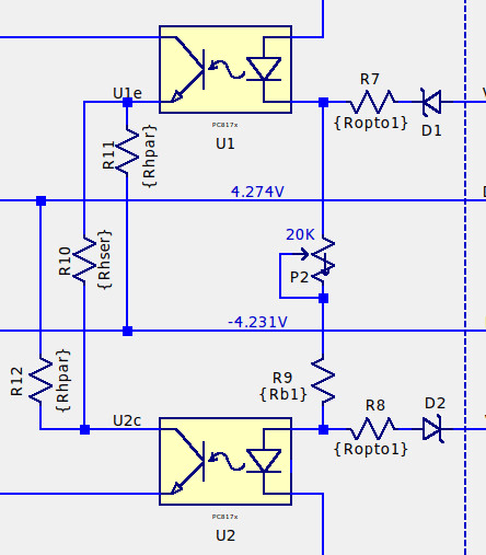

The Bias Circuit:
The bias circuit has a three resistor network connecting the two optocoupler transistor outputs as shown in the 2nd image of post #1.
Here are some measurement of the bias circuit behavior at different power output levels for some different resistor values for the resistors R11 and R12. In all cases R10=4.7
The R11=R12=infinity case is similar to the XA25 bias circuit. With R11=R12 in the range between 12K and 15K the bias current is nearly constant with changes to the output power level, as predicted by the simulations.
I did run simulations of bias vs. rail voltage. Iq/Vrail was about 22mA/V. Not great.
