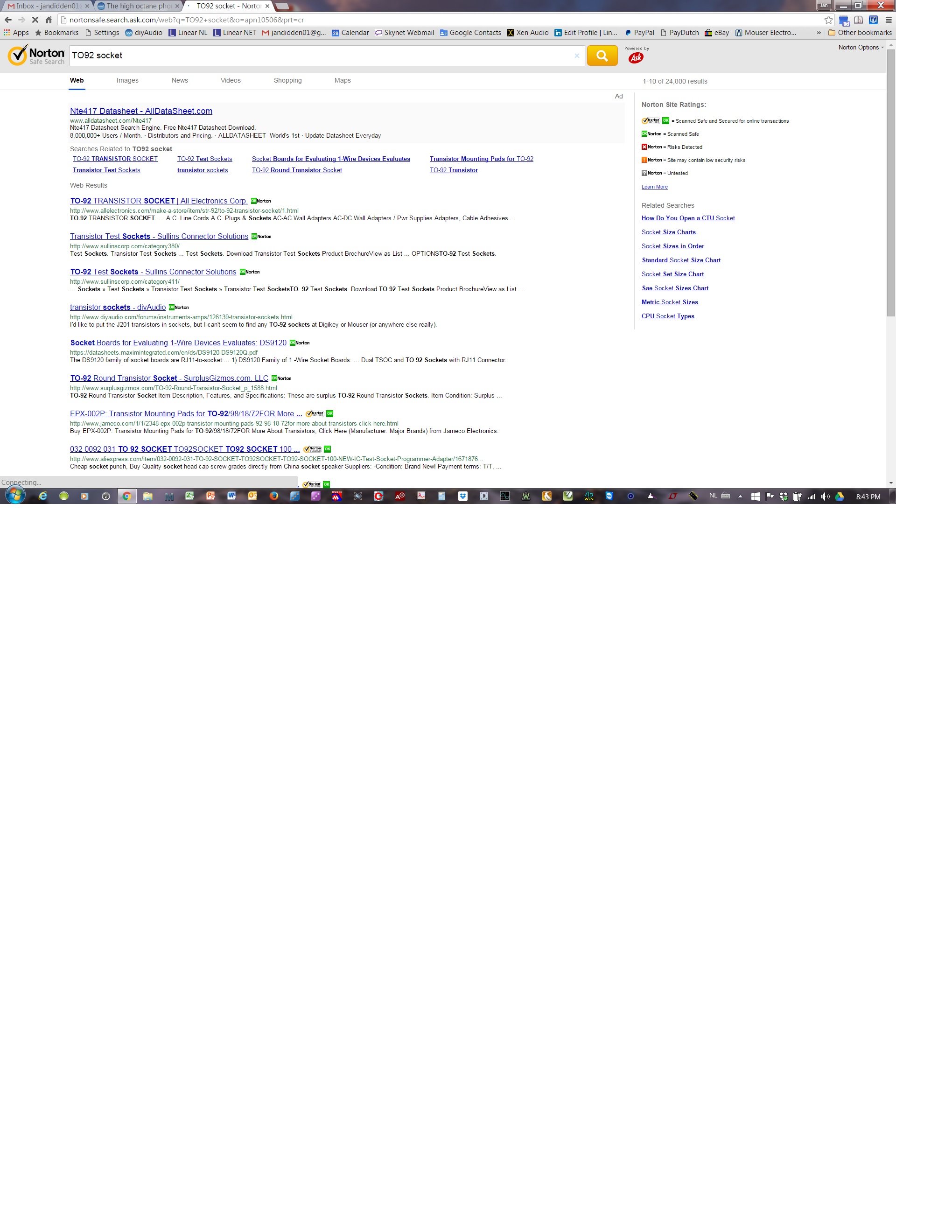

any idea what that three contact plug is called?
Use your imagination. Google 'TO92 socket'. See attached.

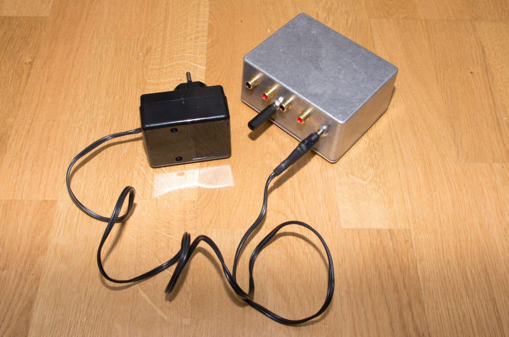

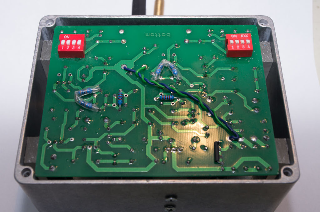

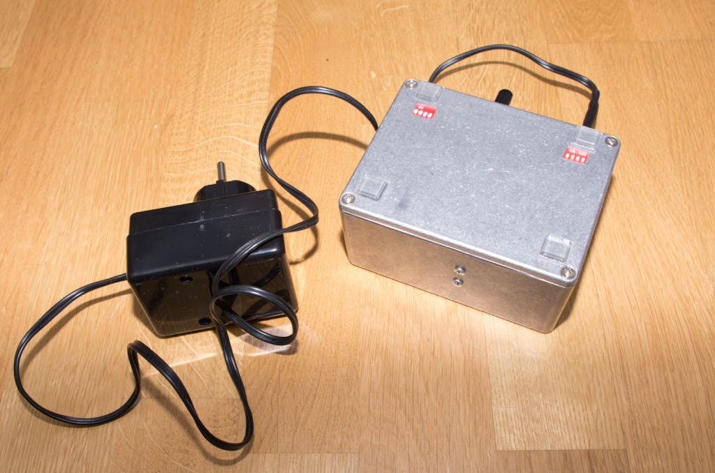

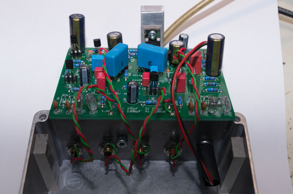

My take on the High Octane
Finally found some time to take some Snaps (had to listen before 😀).
I used KSA1845, tried also BC550 but measured slightly higher noise (though still very low) and so the 1845 went in again. RIAA caps and resistors have been selected out of a dozen and final deviation is <0.5dB with channel mismatch smaller than 0.1dB.
PSU is a small DIY plug housing unregulated linear supply ~50V DC.
I like the sound, its very detailed and punchy 🙂 Very nice Project, thanks a lot to Hannes
kind regards, Daniel
