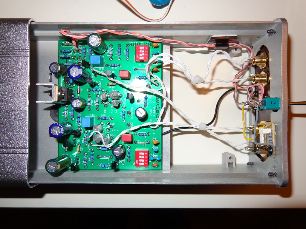

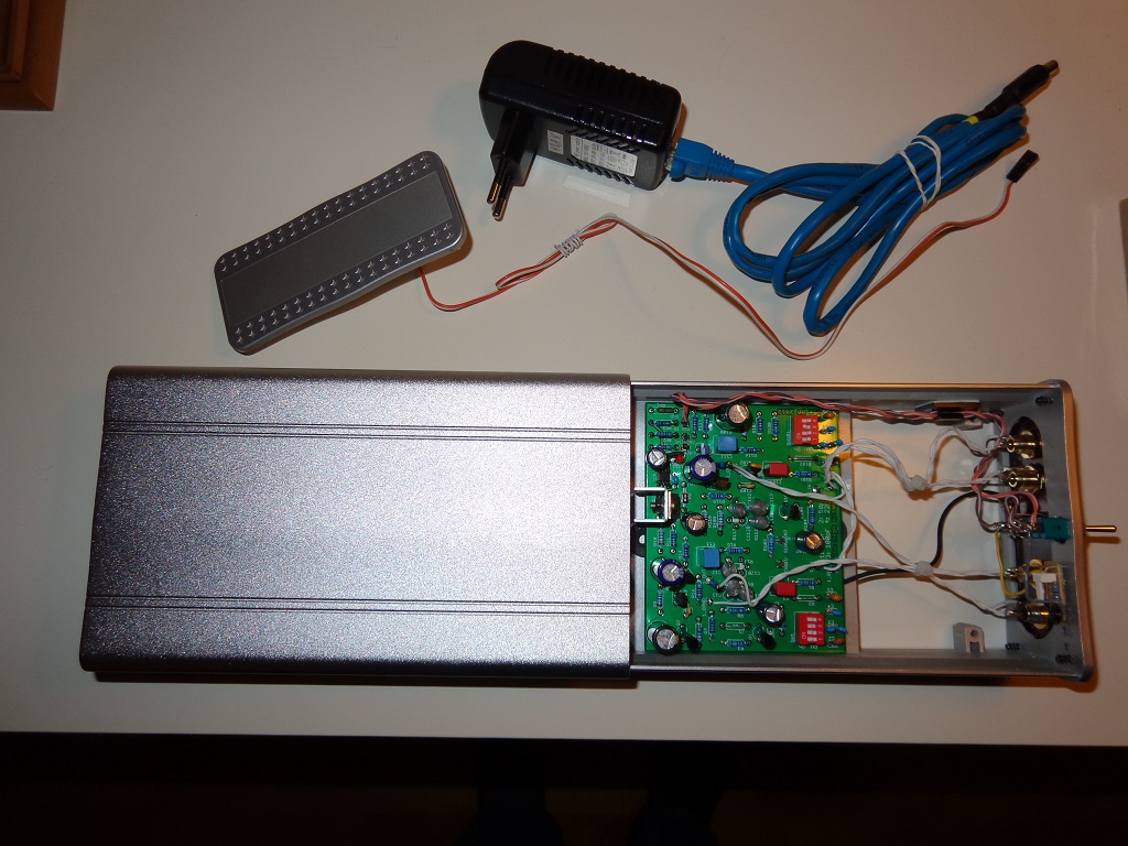

I finished mine a few days ago.
My first impression is absolutely positive. I believe this RIAA will be a keeper.
I'm a bit concerned about my output voltage, measured at SENSEV and SENSEGND.
I'm not able to get 40.0V exactly with various combinations of RP2 and RP3 sensing resistors.
Right now I'm a 41.1V with 25K3 and 1K, but I've also been at 39.2V with 19K1 and 845R, and at 40,9V with 19K1 and 768R.
The Vf of my regulator LED is unknown, however according to specs max. Vf is 2V. However, I believe it's around 1.6V.
To feed the regulator I use a 48V/500mA POE injector wall-mart. I measure 48.7V.
Opamp is THS4031C and regulator is IRF510.
By the way, I use BC550B transistors with legs crossed, but will probably buy 2SC2547 soon.
Enclosure used to be an old network disk, and the PCB fits in just nicely.
How important is it to be at exactly 40V for this circuit?

Not important at all! Anything between 38V and 42V is acceptable.
