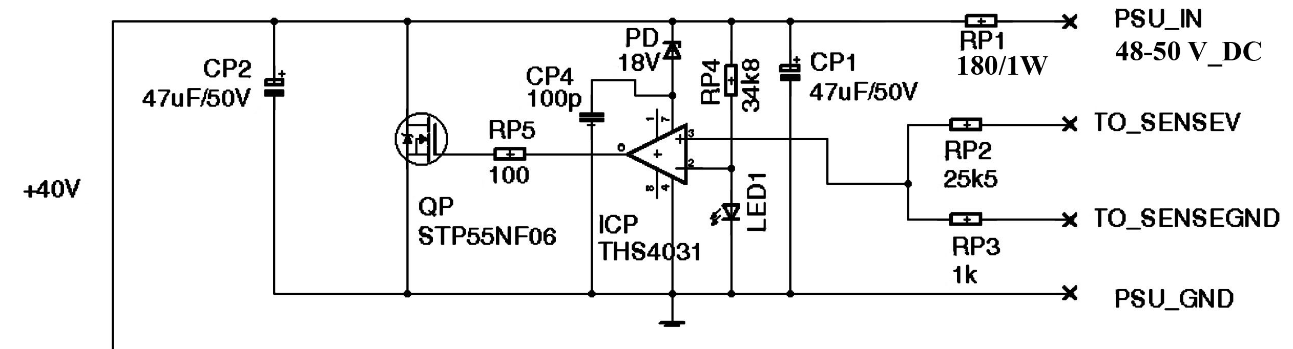

I've updated the link to show the correct component Numbers.
Sharif.

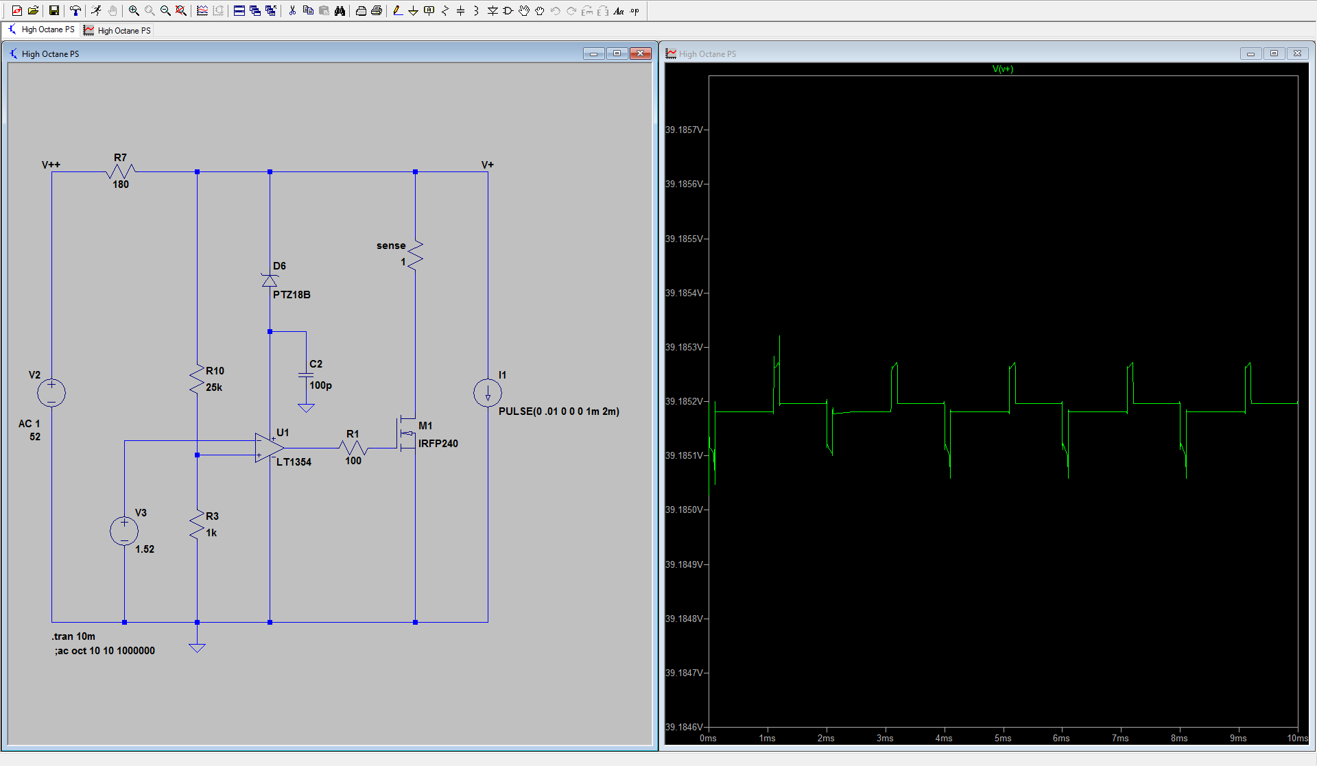

I don't want to overly press this, but I think you should know: that voltage regulator is totally unsuitable for the circuit is it powering.
The design is fundamentally flawed.

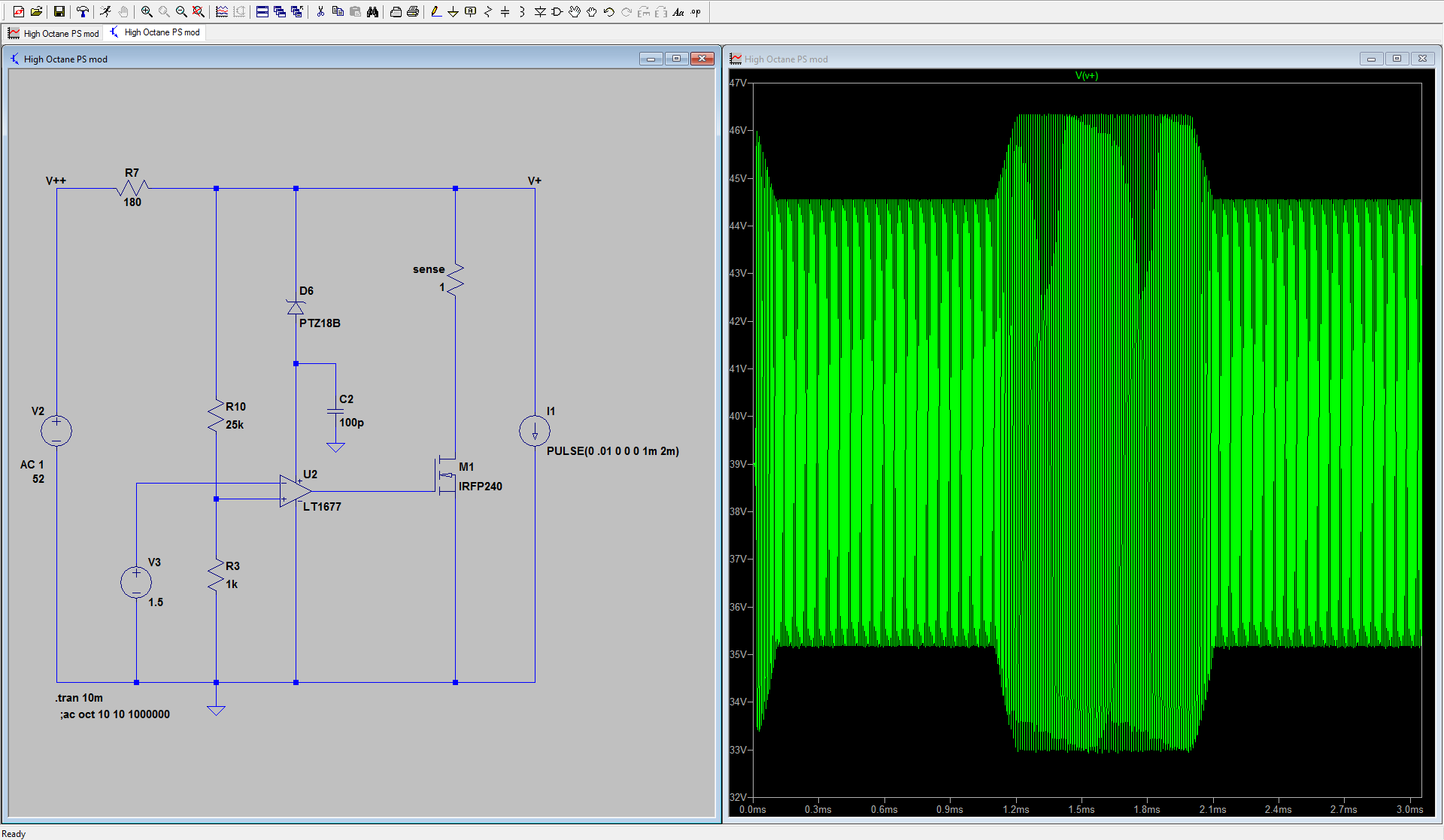

The LED1 bias is 1.6 V. This puts the inverting terminal of the op amp 1.6 V from the negative power rail. The THS4031 op amp, however, is not rail to rail. According to the datasheet the common mode input voltage is only up to about 1.5 V from the rail. It's touch and go whether the IC will function properly or not with one input at 1.6 V. (My guess is it won't) If you go and put a rail-to-rail op amp in the circuit, like the LT1677, the whole thing goes bezerk.

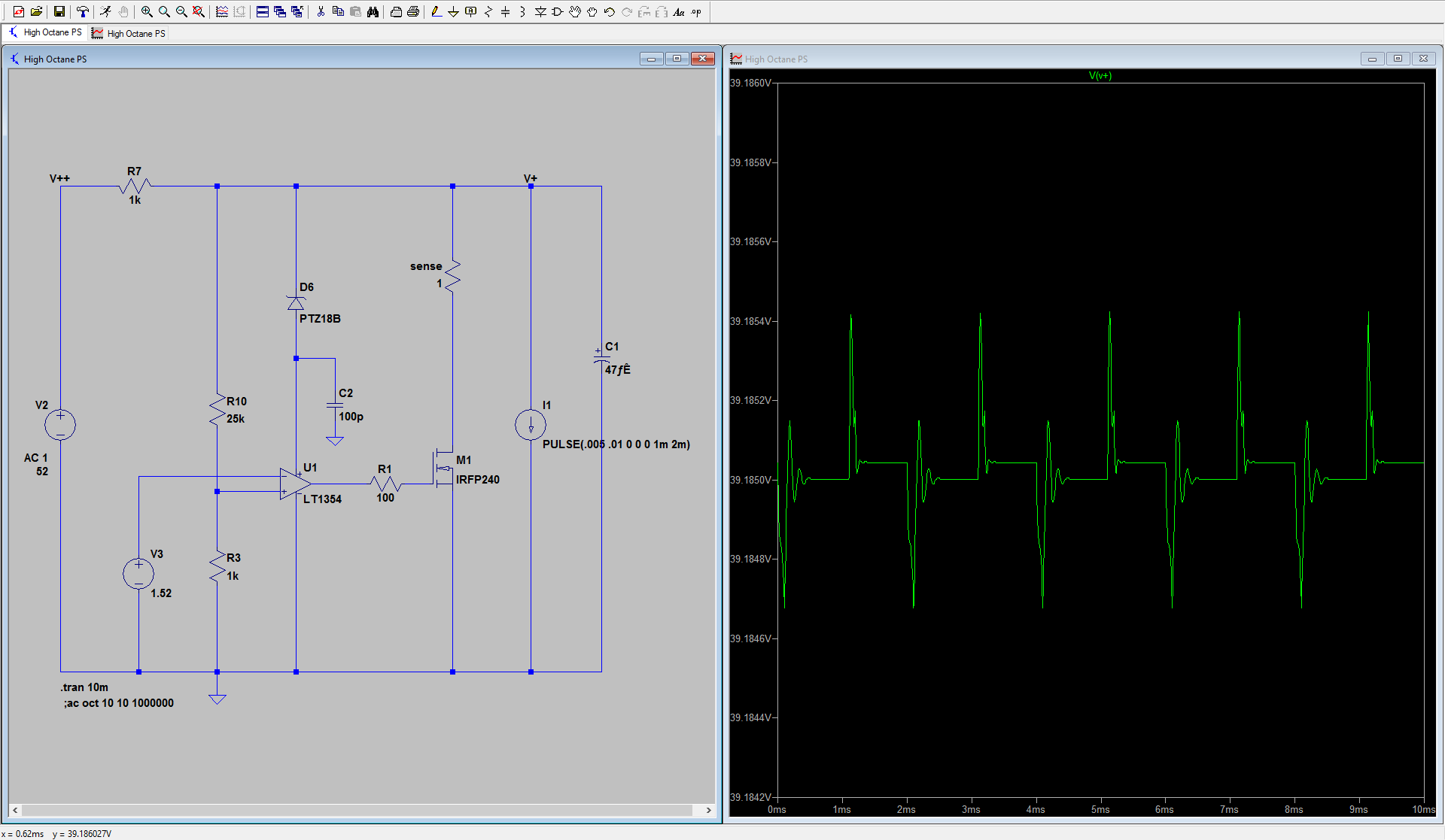

That's one thing. The other is with R7=180 ohms it seems 60 mA is shunted through the MOSFET. This is just a waste since the circiut draw is barely 5 mA both channels (right?). Increasing R7 to 1k puts the shunt current at 10 mA, but it could actually be even lower since it only has to shunt the deviation in load current.
Anyway, no matter what you do the regulator output to a pulsed current load is horrible. Trying to damp it out with capacitance just makes it worse.

One small further point: the shunt current is adjusted by RP1 (R7 in my quick-n-dirty sim), which means it is rather poorly controlled since I_shunt = (Vin - Vout)/RP1 and Vin (PSU_IN) is variable. Vin will change from day to day, and more importantly from build to build. What you really want there is a current source, so you can set the MOSFET bias current through independently of changes in the supply voltage.

Good points about that LED and the series R. If you dont want to mutilate the PCB a good solution would be to replace the LED ref with a 2-pin 5V low noise ref like the LM4040-05 and similar (more low noise) chips.

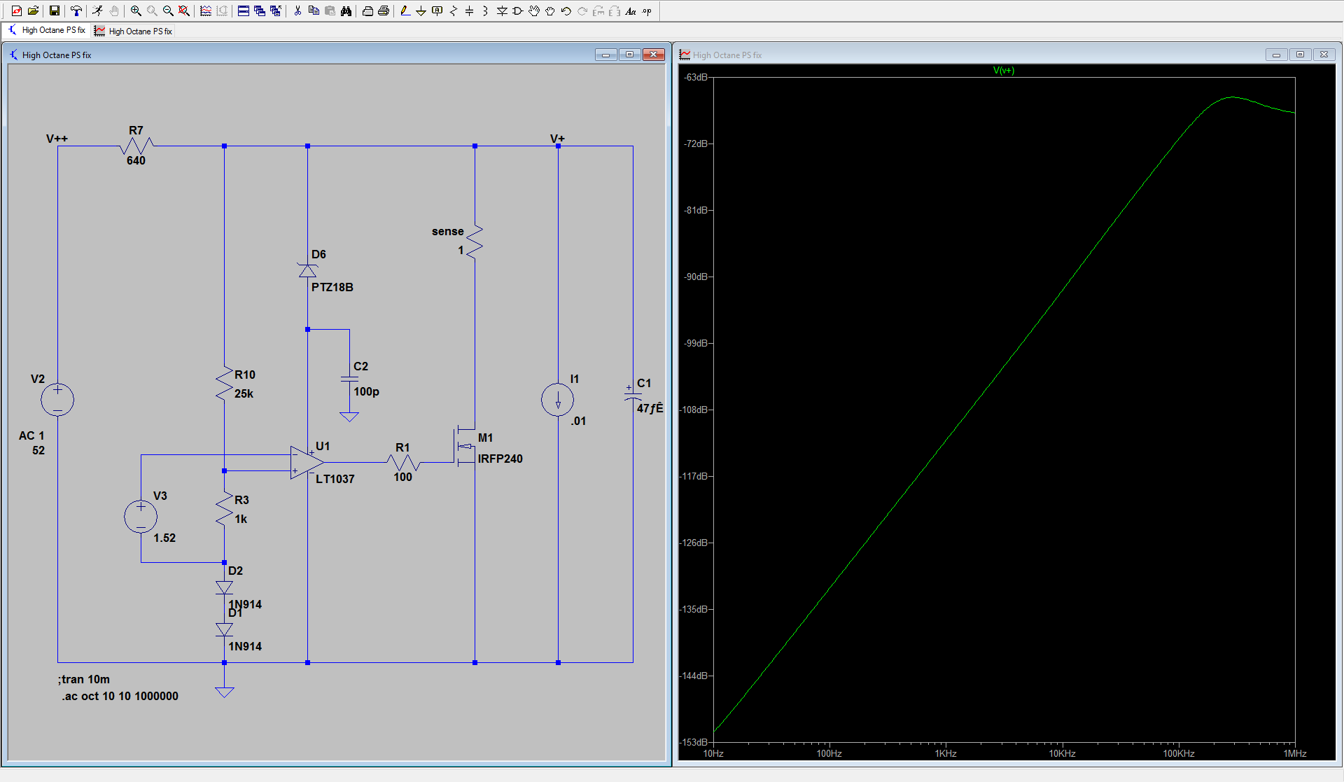

As I see it there are two ways around it:
1. Use a rail-to-rail op amp.
2. Bias the LED and RP3 (R3 in my schema.) up away from the negative rail (i.e. ground).
Mod (2.) is enabled using two diodes as shown below. This has minimal impact on the circuit operation and should allow you to be able to just about any op amp.
Note that the circuit is still very jumpy. It needs a capacitance right next to the output or it will oscillate. Even with the capacitor the pulse response has overshoot. It's the nature of it.

Unless rail-to-rail, op amps don't perform as per the datasheet when the input or output is sitting at the positive or negative rails. There is a grey area 1-2 V away where it might be OK, it might not, depending on the op amp or just sample variation.
I don't have a model to sim the op ap used in the circuit. Trying different ones in the LTSpice database, only rail-to-rail ones worked as advertised unless I biased the inputs away from ground as shown above.
So all I can say is it might work fine, but if it is does it is probably due to luck as much as anything.
Also to note in passing that the regulator appears to be only borderline stable.

Replacing the LED with a 5V ref fixes it too, without changes to the PCB. Do you agree?

I tried the two diode lift it made no difference to the sound.
Viewed on a scope there is a drop in supply noise but again I could hear no difference.
For the record this is what I done, lifted RP3 resistor at the end that goes to the '”SENSEGND”.
Added two 1N914 (1N4148) diodes, removed the led (you will need to replace it as you will need a longer leg)
From the cathode lead I solder it between RP3 and the new diodes.
No other resistors need changing voltage remained the same on my unit (40.2V)

You need to recalculate the two resistors that set the voltage of course, now that the ref is 5V, Vout is 40V, R ratio must now be 35 to 5.
