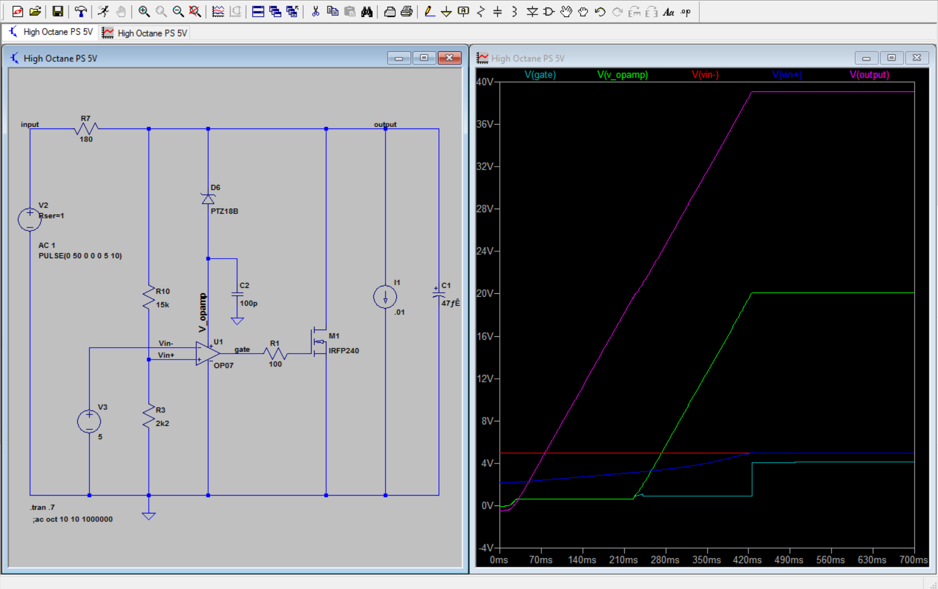

The startup of the regulator, when it works, looks something as shown.
The input and output voltages ramp up. While that happens, the voltage on the op amp is zero until until the Zener conducts, about half way through the sequence.
The voltages on the op amp inputs are meanwhile 5V and about 2.5 V respectively. When the output reaches 40 V, Vin+=Vin- and the opamp turns on the MOSFET. The turn on is very sharp.
This all seems fine. The op amp is powered up and controlling everything by keeping the MOSFET closed as the output voltage approaches the regulation value.
Perhaps Vin+ ended up latched to the positive rail V_opamp? That would certainly throw a spanner in the works.
