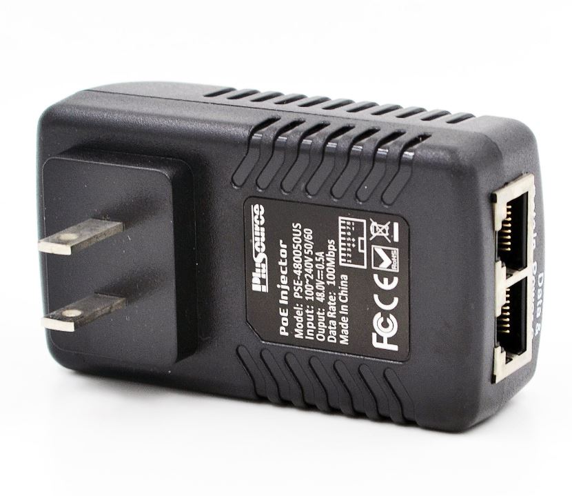

Checking twice before plunking down $5 for this...
Hard to beat this wall-wart for the price - will .5A provide enough current to drive the High-Octane preamp?
Thanks! - Sixto
Thanks! - Sixto
Oh, I actually really like wall warts.
The old ones have EI-cores with low capacitance between the windings which keeps high frequency line junk out.
In addition they're located far away from the phono circuit which prevents humm pickup.
The high octane comes with a strong regulator which eliminates any poor regulation that might come from the cheap wall wart. Just use an overkill unit with a 0.5-1A rating or so.
