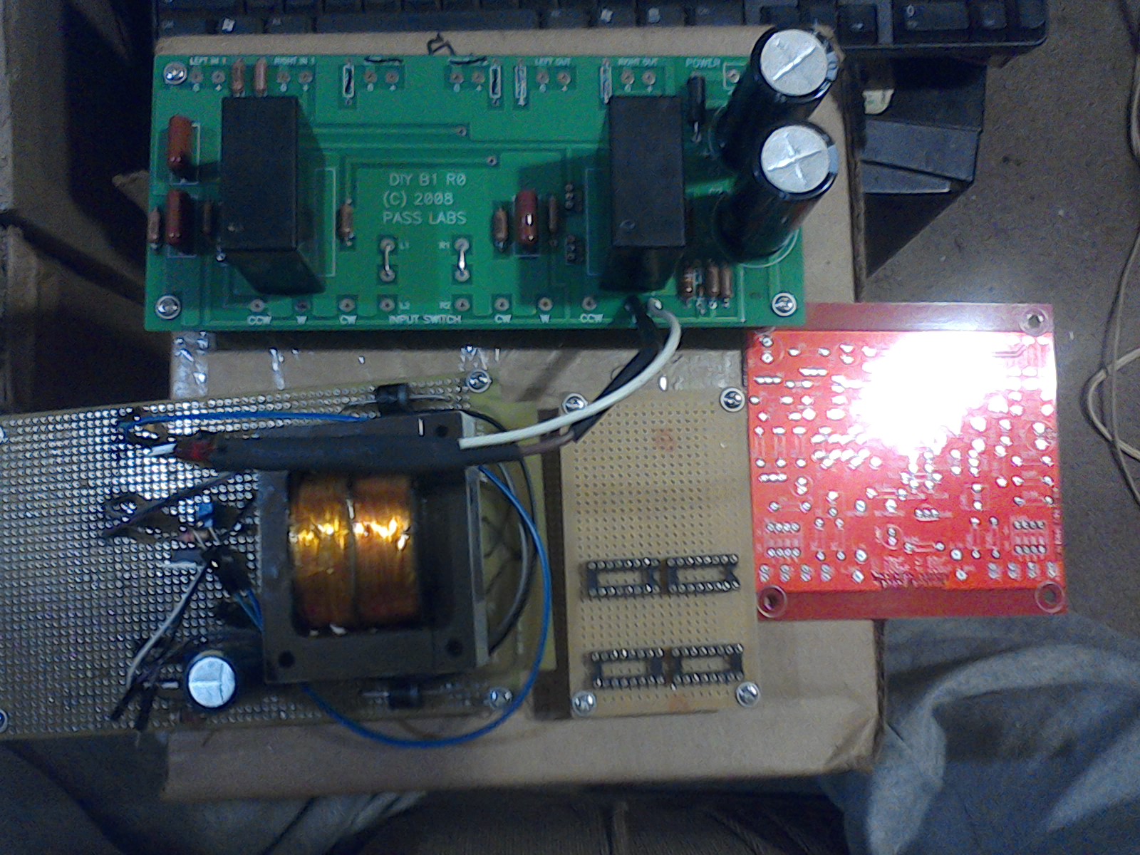

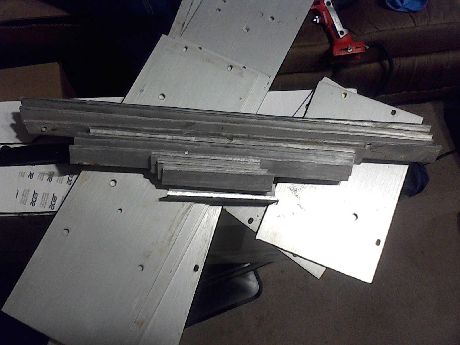

Got my new red board today. I have been cutting aluminum to make my rack mounted enclosure this afternoon. I am combining the " High Octane Pre-amp" with a "Pass B1" . I built a three output power supply for 48vdc, 18vdc, and 12vdc to power everything. Now time to populate the red board. Most of my life I was more likely to have a 5lb. sledge hammer and a stick welder in my hands, so this is quite a project for me. Wish me luck folks.
Thanks Hannes. Looking at your pre-amp is what got me started on this project. I am learning and having fun at the same time. What more could one ask for!
