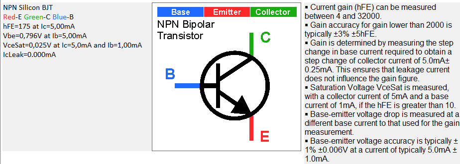

Yes I think (fear) you are most likely right.. But I am sending two of them to Salas tomorrow, and we will know for sure.
They arrived today.
Physically:
In close examination under illuminated magnification they look close enough to mine for printed characters but not exactly the same. Mine have somewhat finer & fainter print. Also the plastics mating line across the top has a brow to the right on yours but bit longer and to the left in mine. From the back mine look somewhat bulkier for the plastic head with a bit larger molded dot also. No character in the dot as in yours. Legs length and metal finish are very near.
Electrically:

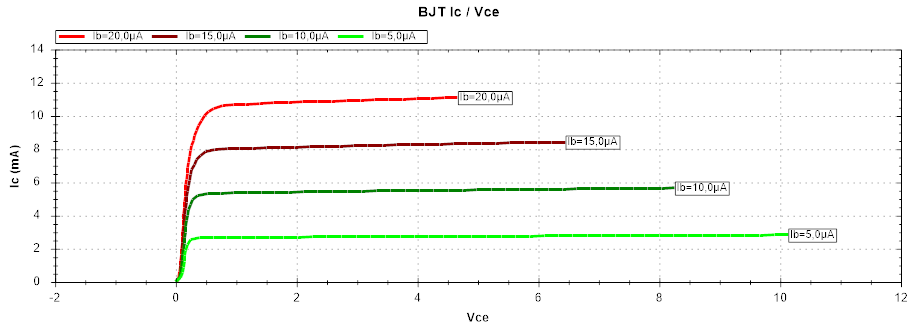

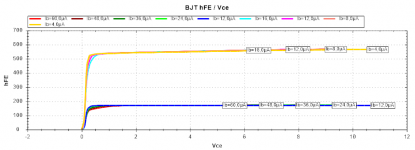

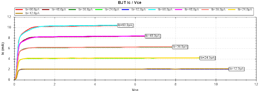

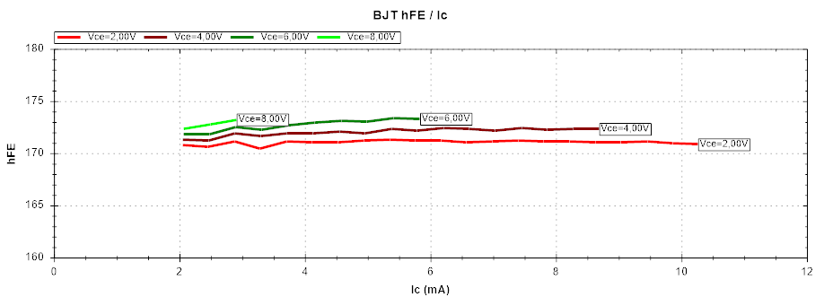

hFE is very close between your two samples (173-175). Their Ice/Vce curves are matching. Nice flat curves with even spacing. Plotting like some good type but low hFE transistors. Totally faked or original low hFE reject wafer you will probably never know. In any case they don't fit the Renesas datasheet E grade (not even the D grade for that matter). They are far apart with my 2545E in hFE when tested under exactly the same conditions.
Thank you for the information Salas!
So they are definitely not authentic 2SA2547E. My conclusion is: The 2SA2547E is no longer available anywhere. I will contact Dalbani with these findings, and see how they respond.
Interesting though, that they seem to be decent enough devices, whatever model they are really are. If I can't get a refund, perhaps I will try using them..

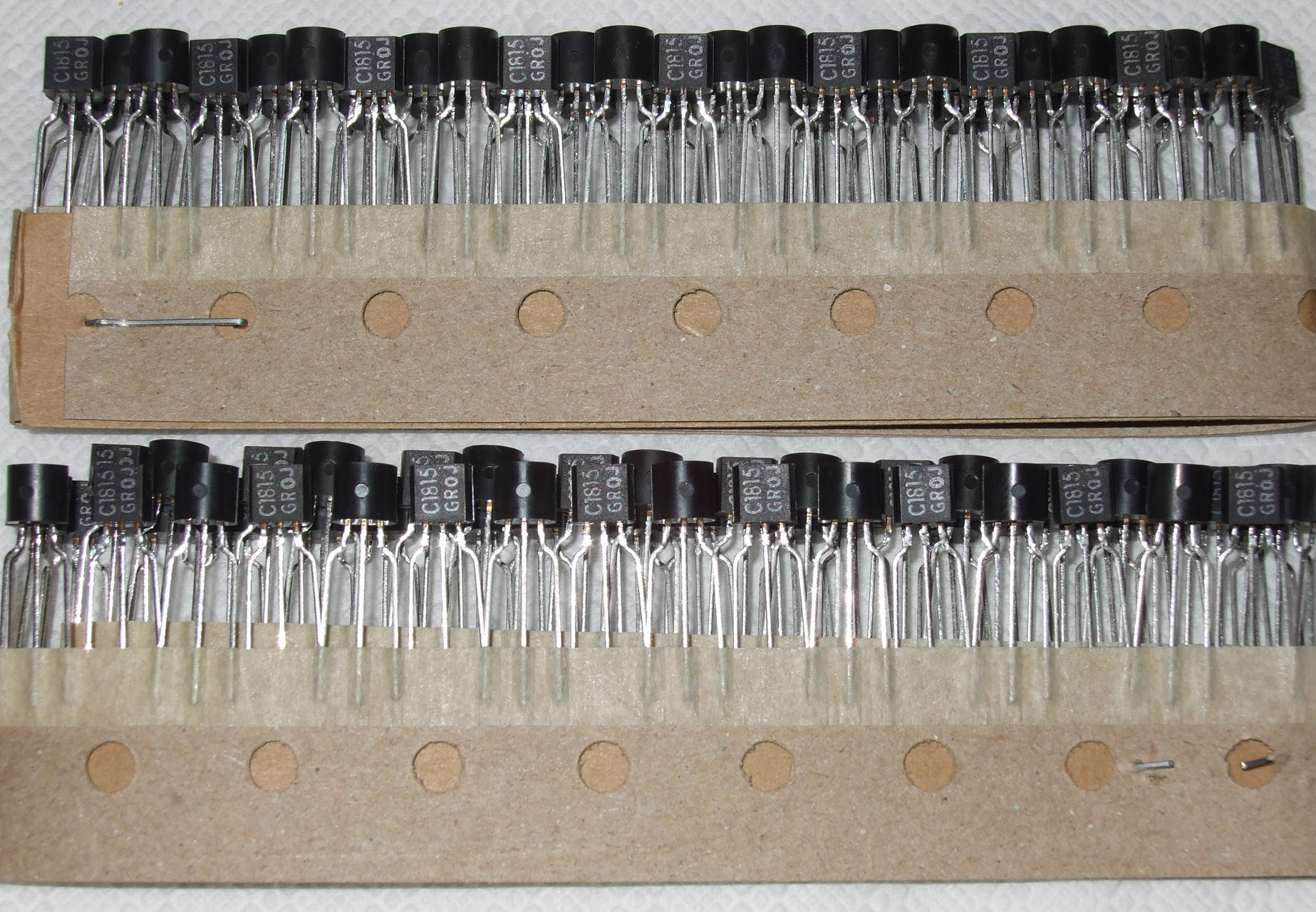

BC550 is around 150 Ohm Rbb'. I also have some Toshiba 2SC1815-GR that they measure near hFE 300 by majority, they got ECB pins order too like the 2547, 50 Ohm Rbb' 2pF Cob 1dB NF and very linear curves. I don't know what is the characteristics priority in this circuit, but if the author says they are acceptable too, this is how originals should look like, save batch code differences of course

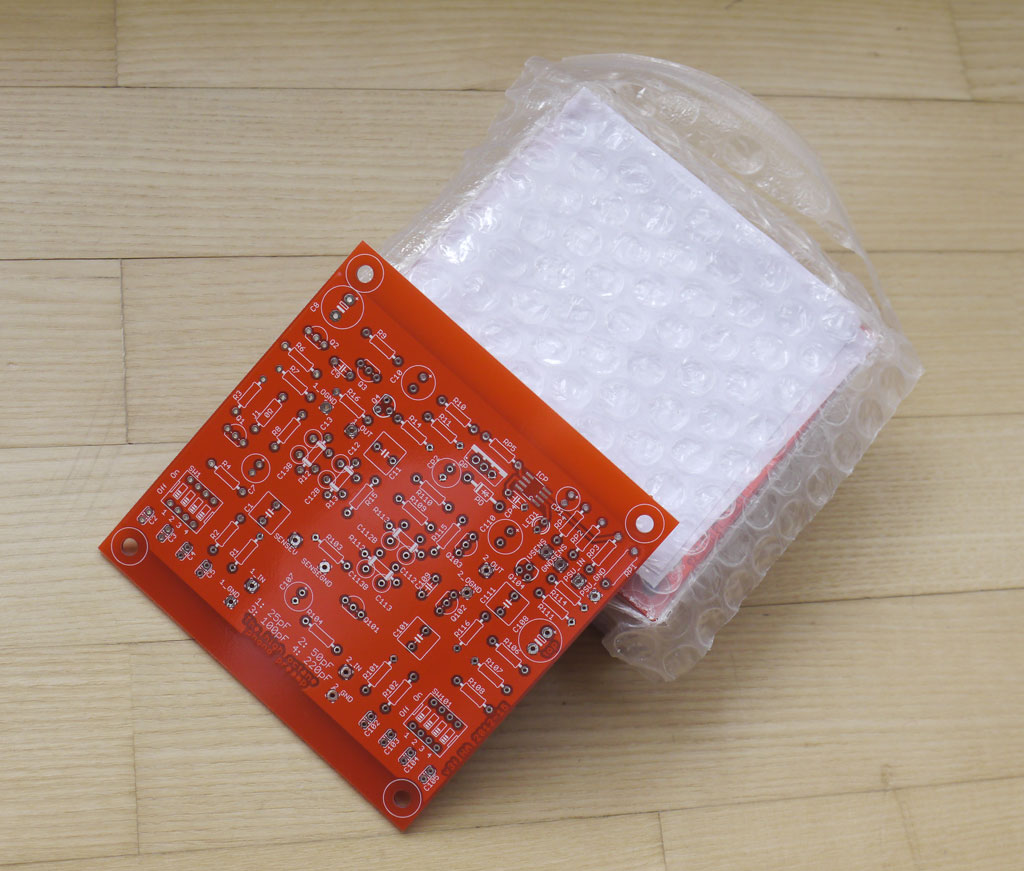

Hi there,
the new boards are finally there - and they look great!
I'll start contacting everybody who notified me of their interest!
Hannes

everyone that wants a boards, please simply send me a message!
Price of the new board is 11 Euros, together with shipping & paypal it comes to 20.07 Euros.
