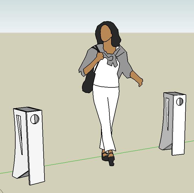

planet10 said:I finally got a chance to try out the free version of SketchUp today... and of course i built a Frugel-Horn...
dave
Dave, have you figured out how to draw an ellipse, or is that not possible in the free version?
Bob
Bob Brines said:have you figured out how to draw an ellipse, or is that not possible in the free version?
I didn't even try that, but from the tool set, it looks like it could be a problem. They have done a really good job of providing something free that gives you a real sense of how slick the program is, yet lacking enuff useful features beyond the simple that you'd be really tempted to do the full version.
dave

It doesn't keep the geometry thou (ie a rectangle comes in as four lines) so all it is good for is a template to use to redraw your object -- that is how i did the Frugel-Horn model.... certainly not as slick in that respect as the antique (Alis Sketch!) that i have been using -- save the Vectorworks as an EPS, import and go to town....
Bob, you could decompose an elipse into a polygon and then trace that...
dave

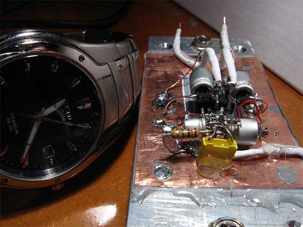

Dave thanks for the response and a big thanks to the other guys as well it is much apprecaited by those fairly new to the area like myself, I have been very much fascinated particulary by what Ron has written and the advice given- brilliant!
I feel I will probably start this project next weekend, so I will keep you posted on what happens, one thing I didn't mention is that I will be integrating a pair of gainclones into the speakers, basically I am going to put a supra baffle on and extend the side up a few inches then place the gainclone modules behind this and wired straight into the drivers, with a variable shelving circuit I will also be adding a super tweeter (car 1 inch type) I have done this with my DBs and it works a treat.
So overall my incarnation of the frugel horn may be a little different and of some interest to others.
The gainclone modules are a bit different too, they are already built and running 18v batt supplies, LM1875 chips, low gain and pretty much all smd parts, they sound quite a bit better than all the other clones I have built so hopefully they can do this marvellous speaker design justice. The amp is built P2P on a ground plane and runs 3200uf off board caps as well, the whole module is shielded in a little copper coffin. And as you can see its very small, the mid range and treble is very very sweet IMHO.
Many thanks
Brad.
Many thanks
Brad.

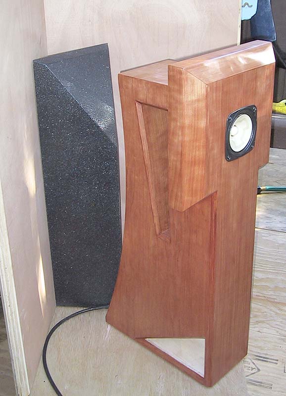

planet10 said:1st pics of the 1.4.0 level 3 build... Chris wasn' t pleased with how the finish turned out, but they sure sound fine...
dave
Looks like you performed a bit of a cone mod on that driver. Appears to be a carefully placed line of puzzlecoat or whatever it is you use for that purpose?
BWRX said:Looks like you performed a bit of a cone mod on that driver. Appears to be a carefully placed line of puzzlecoat or whatever it is you use for that purpose?
Yes. I posted the mod on the Full Range Forum... a link off this page that has additional info.
http://www.planet10-hifi.com/fostex.html
dave
