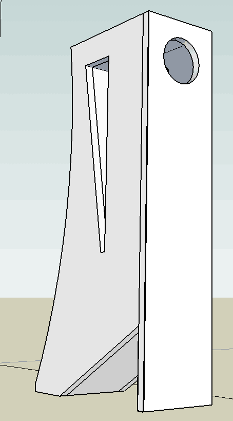

ssmith said:Thanks for the 1.4.0 Wedgie plans.. not sure if I understand them correctly...![]()
But any feedback on the sound yet???
I'm going to have to do some more drawings, and probably some 3Ds to make them easy to understand. Basically the 1st 2 segments of the horn are constant cross-section (31mm high). The wedges are then places in the middle of the segment to divide it into 2 channels, and introduce the taper.
Chris got the wedgies working late Saturday (no deflectors yet -- we want to build the more exotic shape and what i have drawn is a pita to build) and his sole comment was that the rear treatment (in this case just the curved mouth) has a disctinctly positive impact on the bass -- to paraphrase "Ron wasn't kidding when he said the rear treatment would improve bass".

Dave..am I missing something?
er.. why bother with a rear firing back loaded horn with a deflector.? Why not a forward firing back-loaded horn placed near the back wall?
I admit that I haven't been following the thread ultra closely. I understand the desire to enhance the bass, but is rear firing, and a deflector really needed?

Re: Dave..am I missing something?
No mystery -- it works better given the diminuative size of the horn. The deflector does 2 things... it increases the size of the mouth and probably even more important it reduces reflections off the corner/wall going back up the horn.
A front-mouth horn is really going to be a floor-loaded horn requiring a (theorectical) mouth 4 x as big for the same bass cutoff.

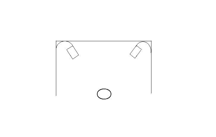

Hello,
I have been following this thread with interest for some days now, and have some questions regarding the placement of the horn.
What are the effects of toe-in adjustments for these speakers, i.e., have the horn fire directly into the corner? I read the remarks about deflectors, reflection and various baffles, and it got me thinking. If the horn is directed straight into the corner, shouldn't the reflected wave back into the hornmouth be reduced? Did you do any tests on this? I have a very small room were toe-in is probably needed, so I am curious to what effect this will have on the Frugels.

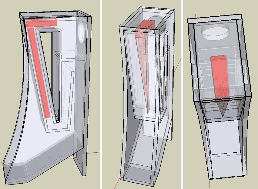

What are the advantages of the wedgie over the other.
besides being more solid.
The size is slightly larger and 1 and 2 are the same size top to bottom.
does it have a sonic advantage of any sort, or no one knows yets.

The wedgie came about because Chris was commenting on all the different angles he had to cut... the one wedge that comes to a point can be a bit tricky to cut, but all the angles in the 1st 2 sections are 10 degrees.
Any sonic advantages are still theoretical, but the theory is that 1/ the 4 panels subjected to the highest pressures are very well braced, and 2/ the aspect ratio of the 1st sections are less (ie a bit closer to the ideal 1:1 x-section.
The non-wedgie has an aspect of 7.5:1, the wedgie has 2 sections each with an aspect of 1.4:1.

The primary purpose of the model was to be able to illustrate how the wedges in the wedgie version fit. The free version isn't powerful enuff to model the exact shape of the wedges (or i just haven't figured out hoe), but the results are still suffiicent for the purpose. Wedges are in red.
