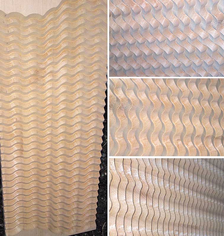

Maybe you've got a picture kicking around of the CNC machined wave pattern that we used in the second iteration of the A126 horn's "chamber"
Somewhere I have seen plastic balls with 12mm holes all around - about the size of tennis balls
Ah
I was thinking of plates with holes or honey comb type holes.
I was way out, glad I asked.
anymore info? location and specific purpose?
thanks guys
thanks guys
Another thought
does this wave pattern create the same effect that the dimples on a golf ball serve or exact opposite? or an entirely differant effect.
