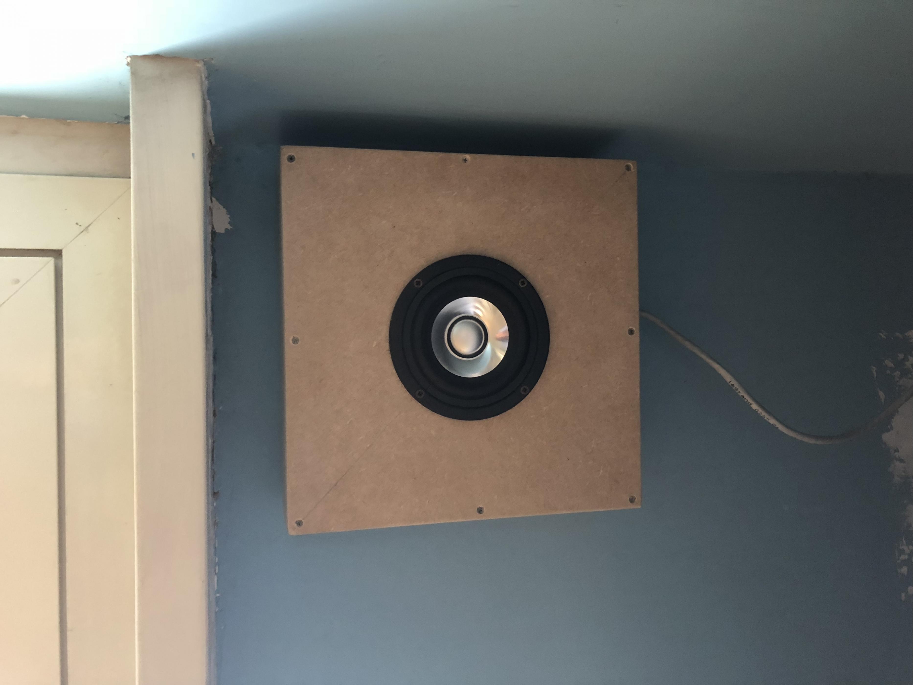

As designed volume is 2.7 litre so either of these would work. You would need to put the vent on the top or bottom so as not to obscure its entrance. The shape is a triangle but any shape could be used as long as cross-section and area are maintained — only the skinnier box would require that thou.

Ok
I will go with this volume
40 200 337
Now I will put the vent port on the bottom
What it could be the dimension of the port?
Like 10mm 200mm for?
And the ap it will be put where ever we want? Or have to be in the center?
Or maybe I can use the same place of the original project from the top?

40 200 337
Inside dimensions. You could get away with 9mm quality ply (oe 3mm aluminum) to shrink things as small as possible.
Current vent is a 4.5 cm right triangle. Cross section is 10.25 cm)sup]2[/sup]
Like 5mm x 200 mm.
Distance from the closed end of the box is fixed, side-to-side you can put it wherever you want (but not too close to a sidewall).\

This is the close box that actually I am using
The insieme measurement are 180 180 40

5mm x 200mm x i miss the last misurment what it could be lenght?
