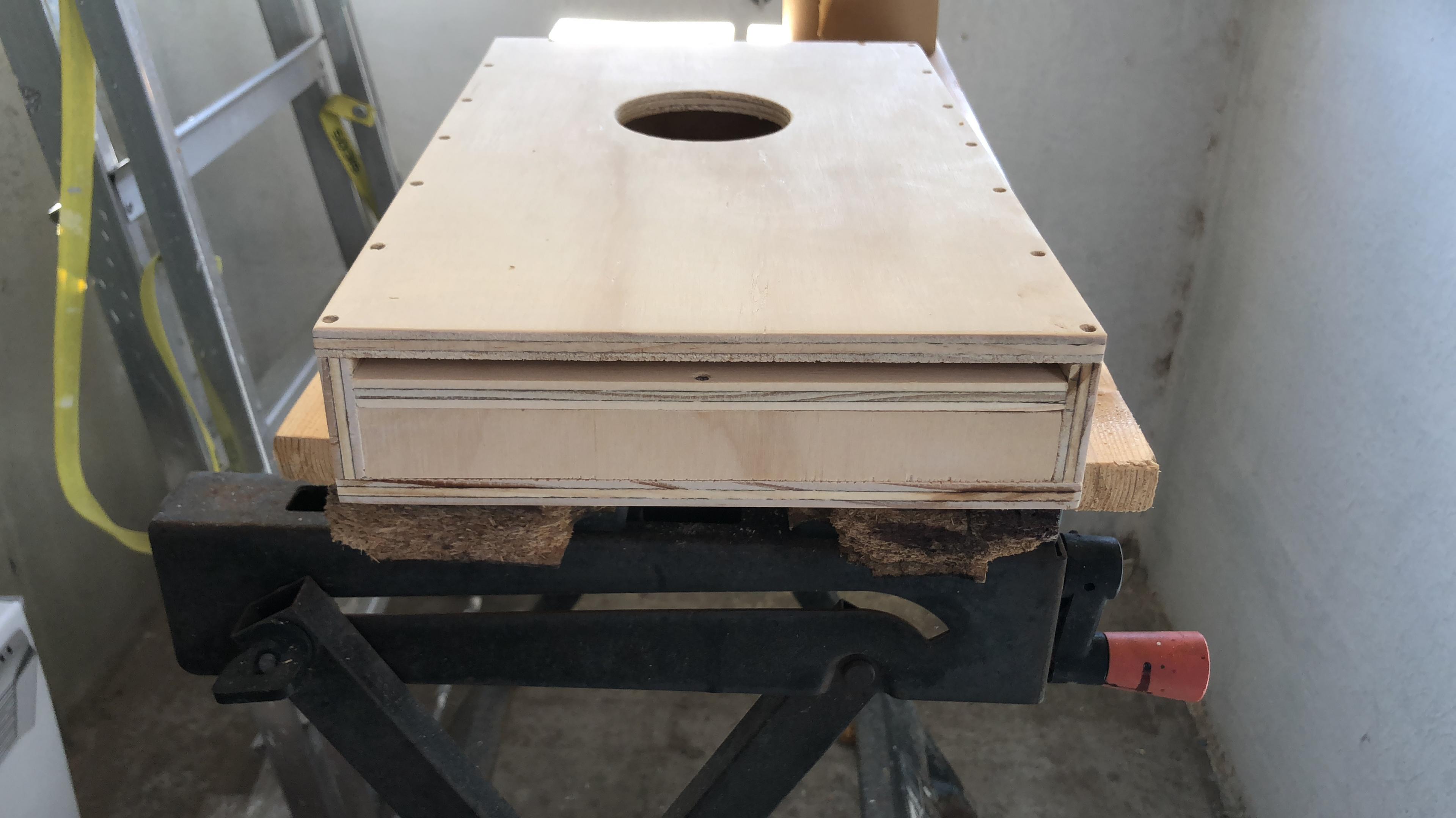

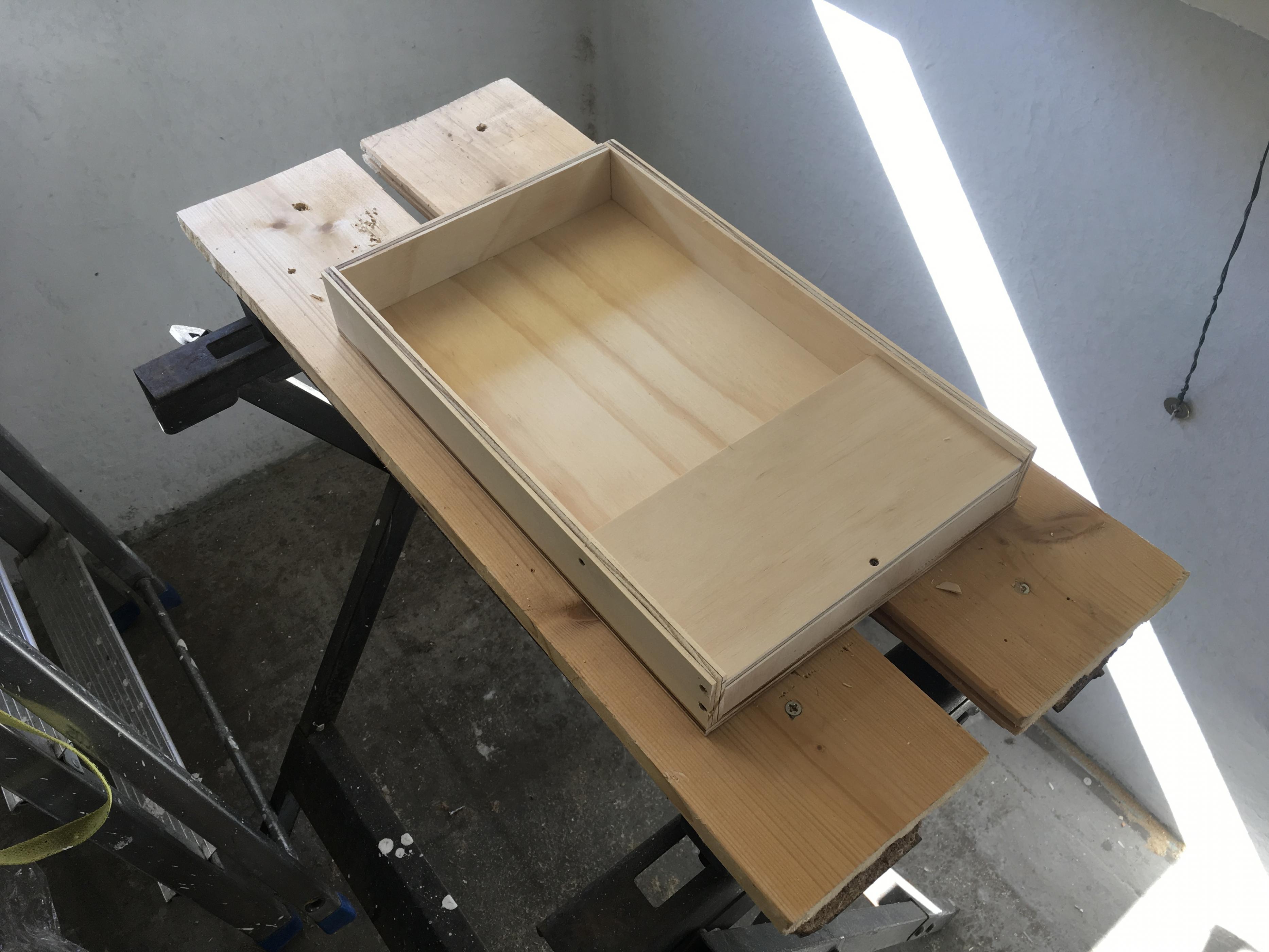

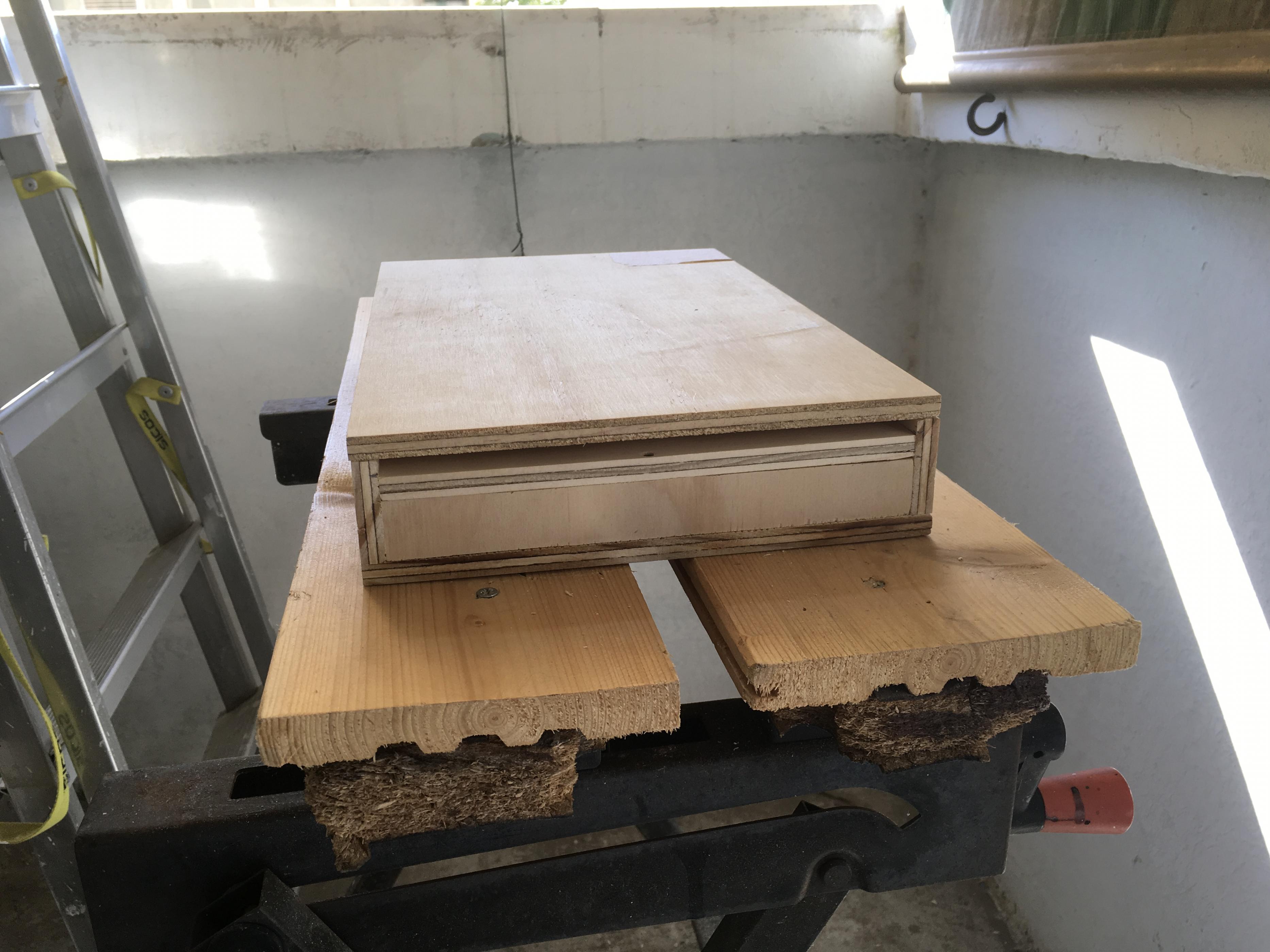

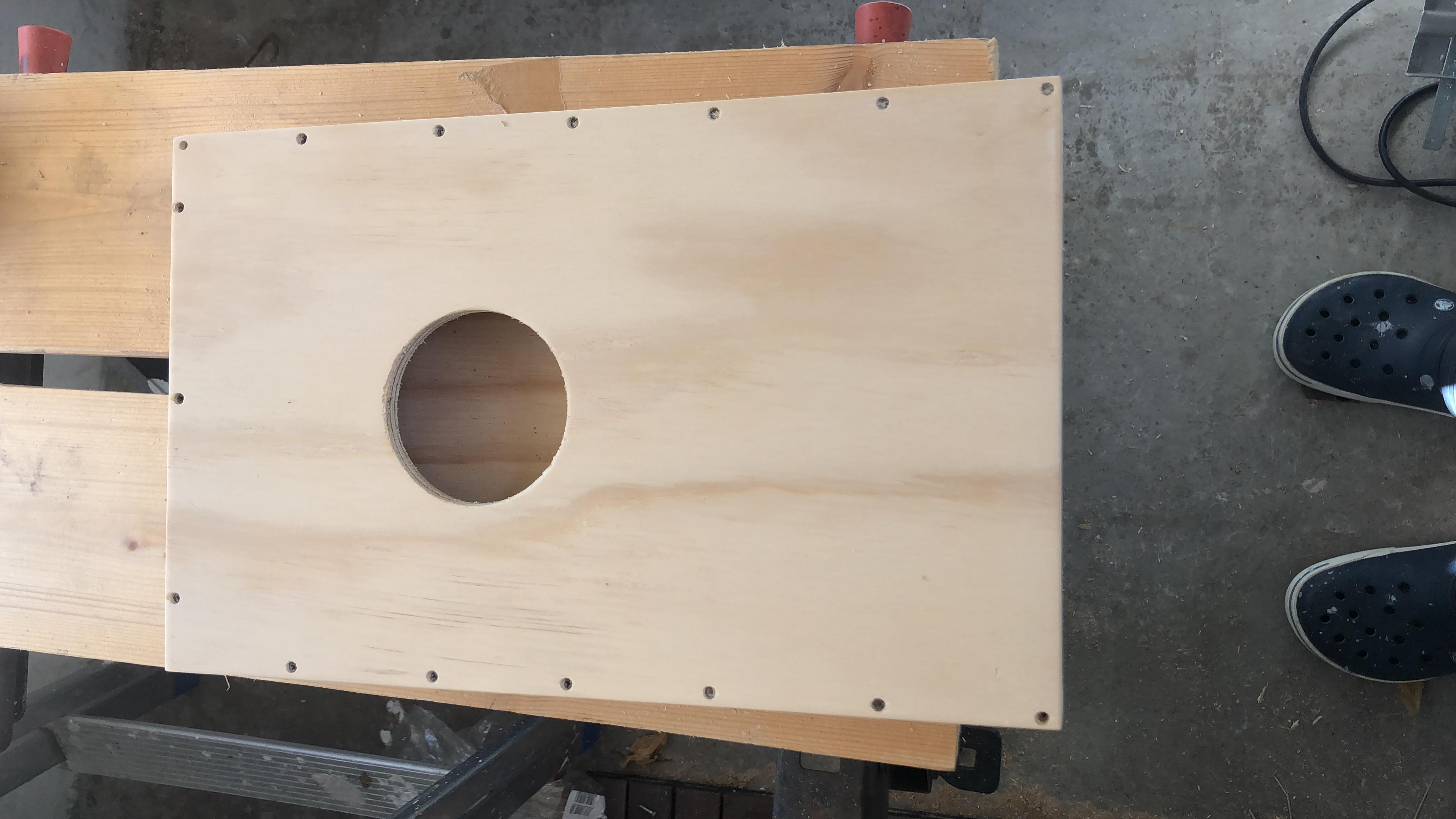

Today I bought the the ply 9mm for the hybrid with e different size I hope to give you an upset very soon
One question I do not need nothing like inductor resisten od other else???

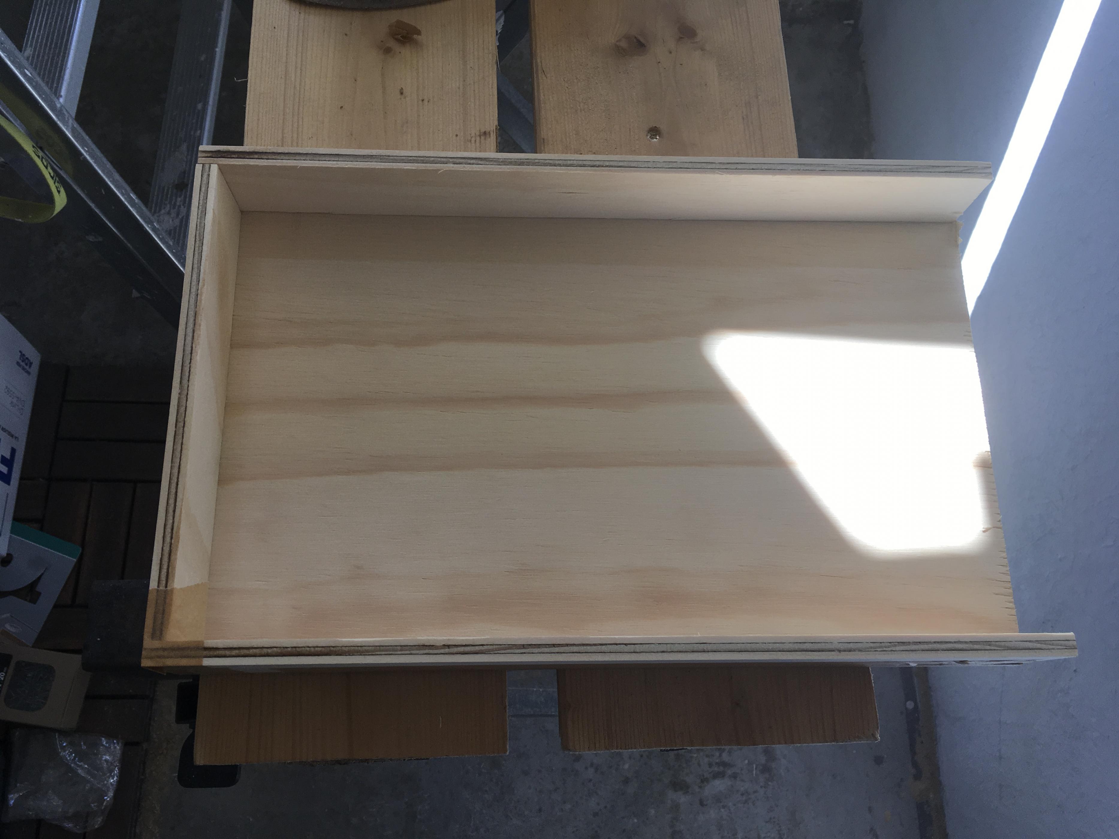

The speaker is new but this is the the difference from the hybrid “flat” with 2,7 L (center)
And
The close box “flat” with 1,3 L (surround)
We will see when the warm up it will finished

No. And if you are putting them on the wall, no need to even think about the BSC some like to add.

Dave thanks for the help and for the project

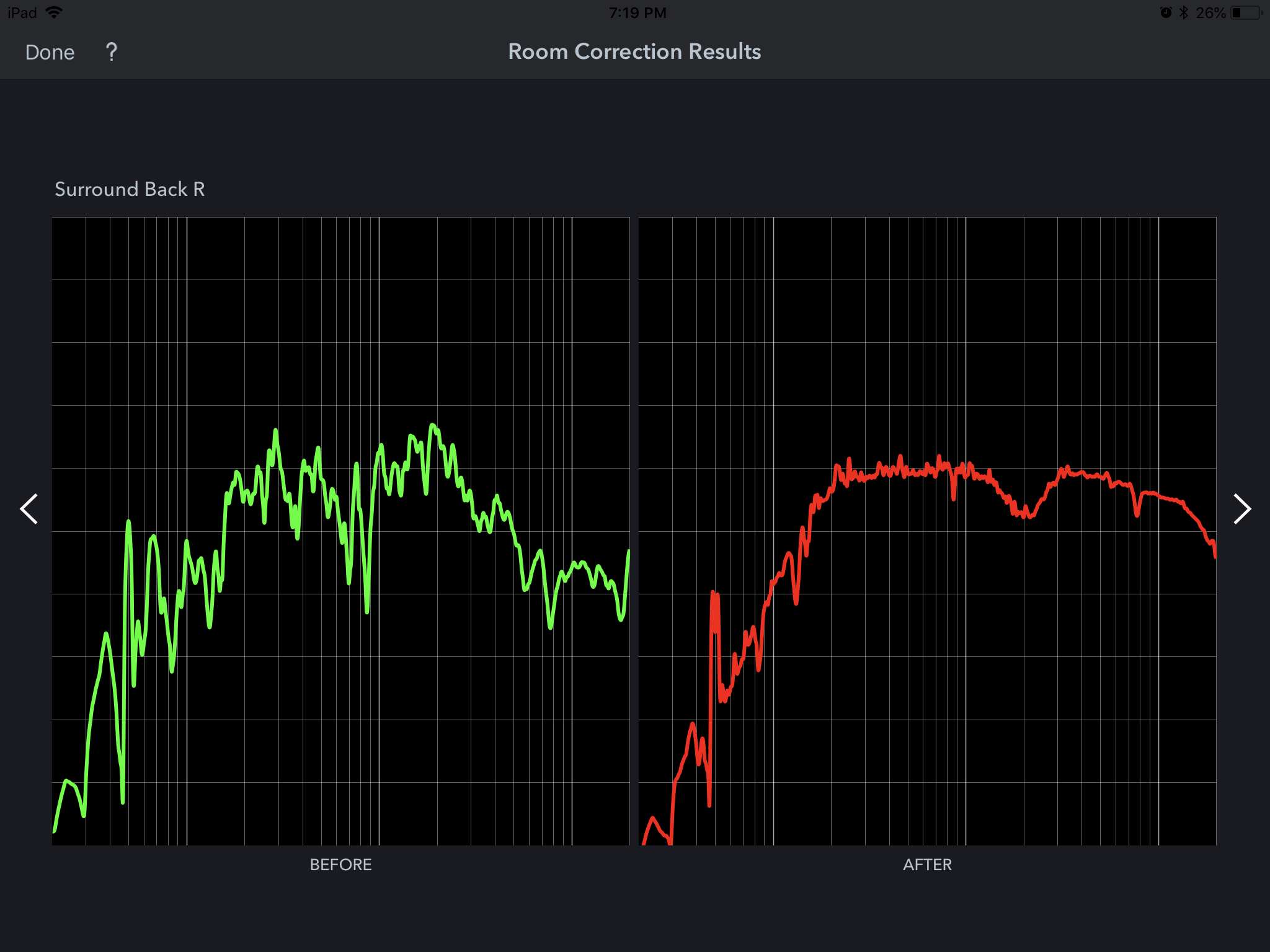

Did you see the speaker and the response?
Wha t do you think?
I hope that I will able to go more down when the speaker it will be warm up

I’ve not heard the FE85, but the somewhat similar FR88ex is a driver i’d put into the 2nd teir of small FRs i’ve tried.

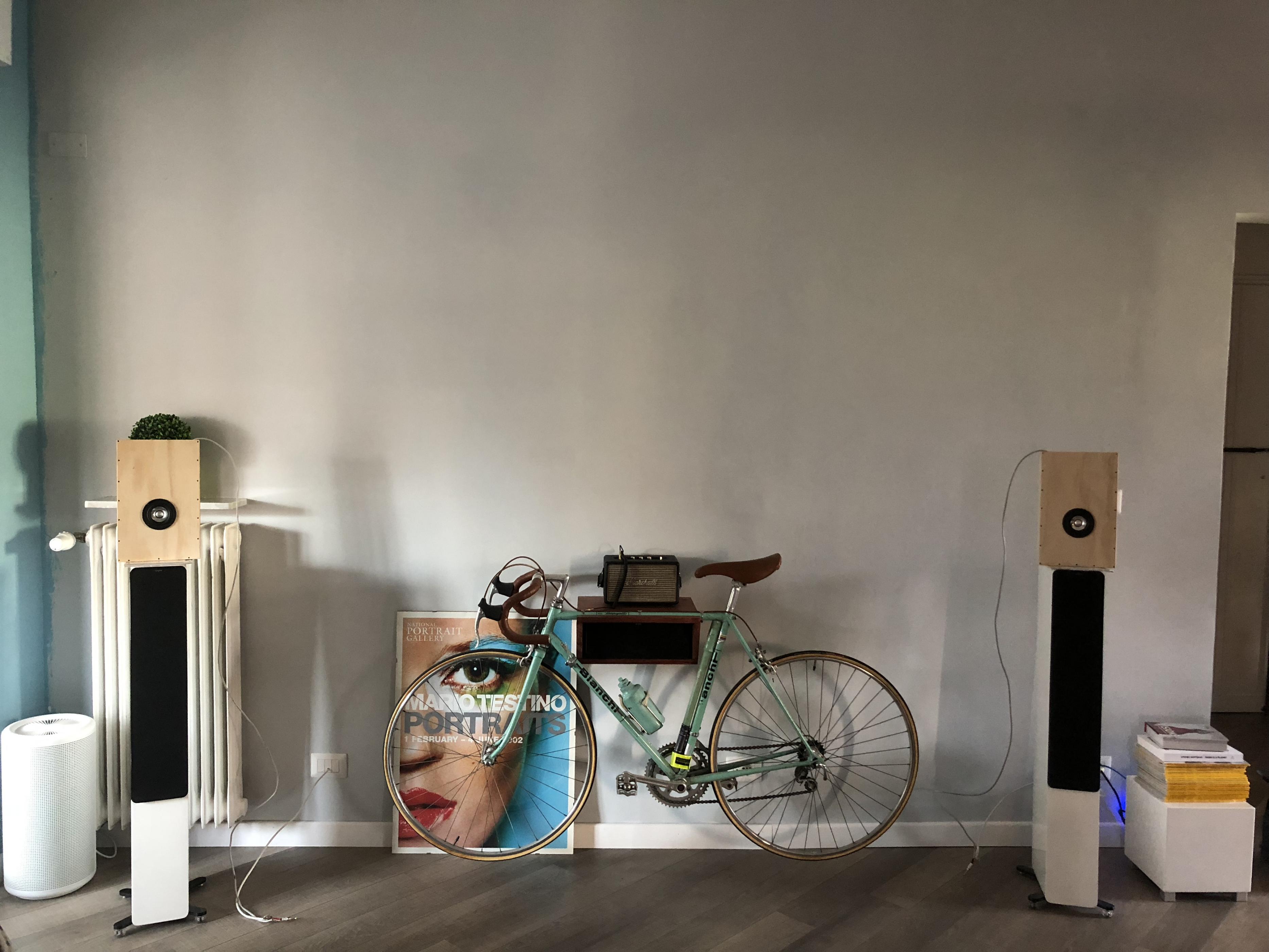

They are working with a jazz in very good way
I like the sound

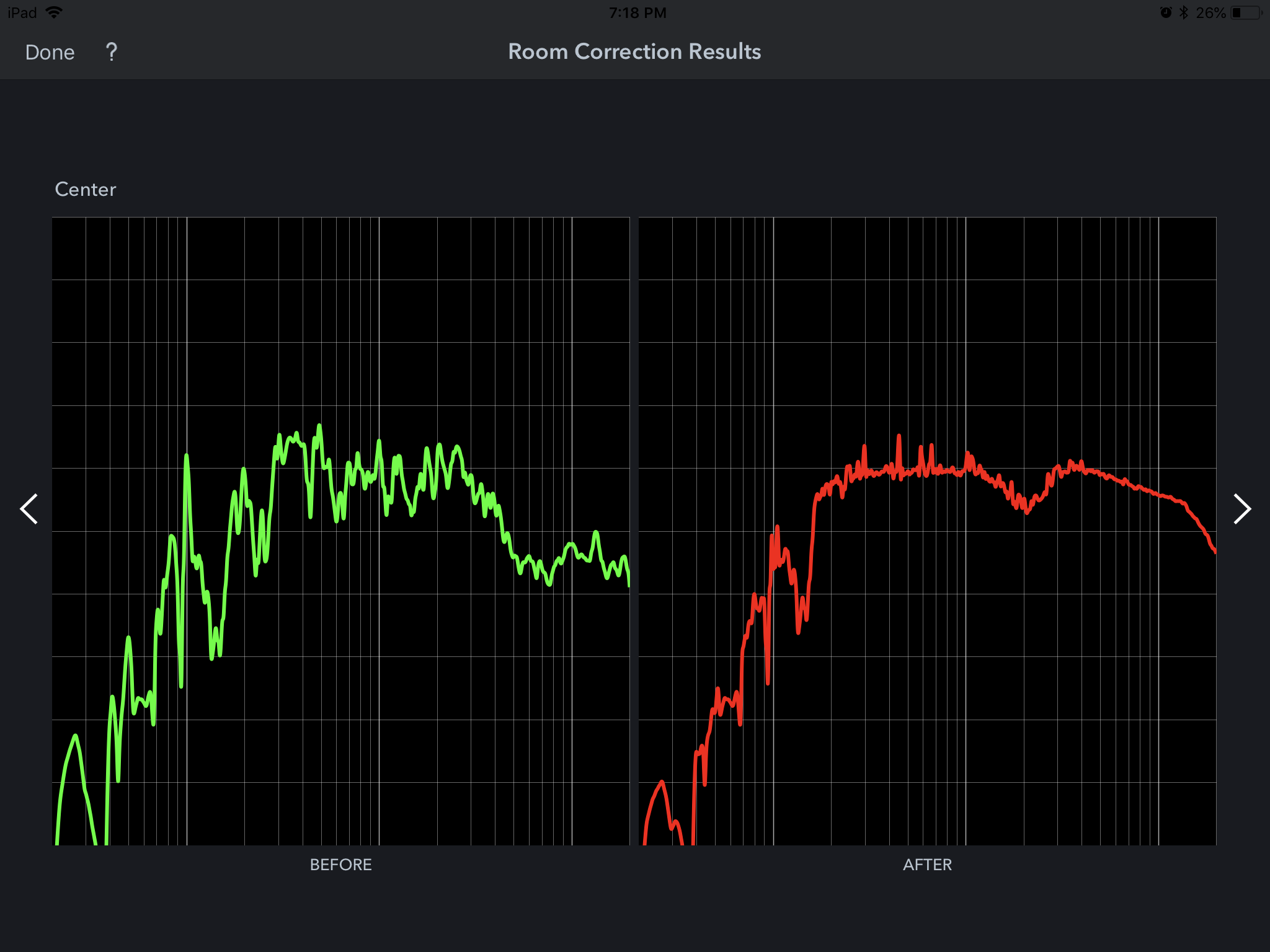

Actually they are running with the help of small sub rel T5
The Room cor cation Audyssey Cut then on 120hz
Do you think that it could be possible to have something like that but with more power??
