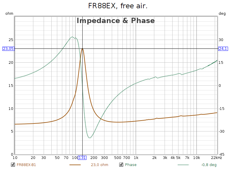

FR88EX resonates at 130Hz instead of 95Hz.

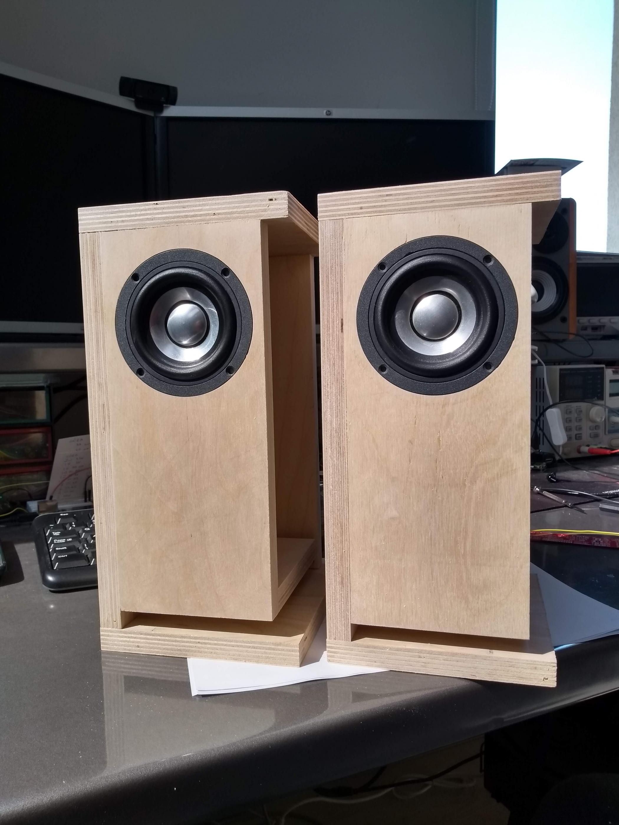

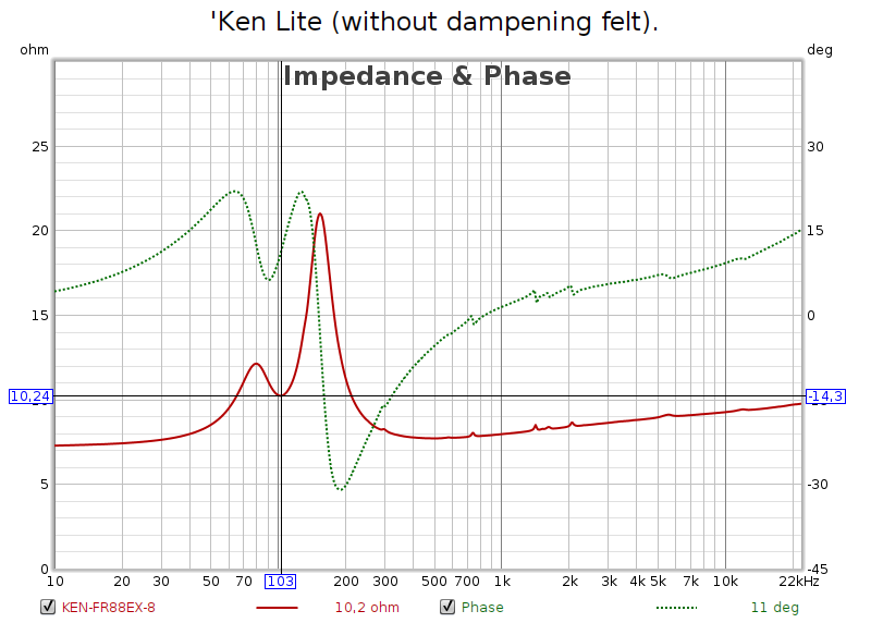

Almost at the end of the construction of my speakers I came up with the idea of ​​measuring the impedance of the driver itself and the complete speaker (without lining). And now I have a problem because FR88EX measurements show something completely different from the data sheet. Instead of the promised Fres of 95 Hz, my test set does not want to show anything except 130 Hz. I assume that the cabinet was designed for drivers with Fres = 95 Hz, so it doesn't fit well with drivers with a completely different Fres.
My drivers are brand new, without any 'breaking in' so maybe there is a chance for lower Fres in the future. But 30% difference? I think it is too far.
I would really like to close these speakers and start enjoying their sound (because they do not sound bad even without felt inside), but these measurements disturb my peace :).
Witold
