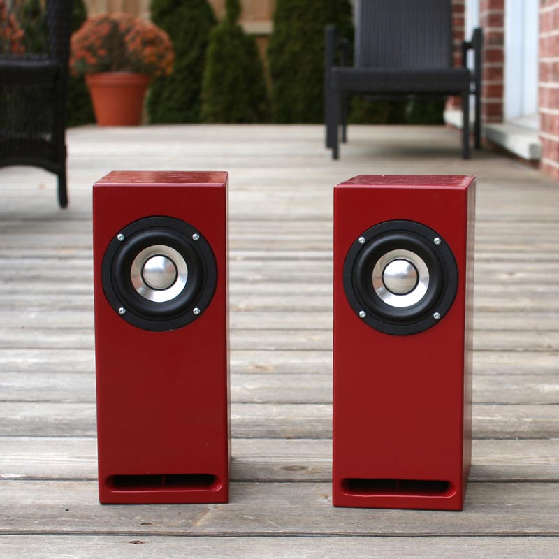

I can share that my experience with this driver has been positive. The bass performance, given it's size, is very impressive. I built mine back in 2010 using a small desktop design with an unusual port design - easy to build but it has a horn type of shape to it. Sitting on a desk it gets good boundry reinforcement. It has Golden ratio internal dimensions and a pair of them can be cut from one 2' x 4' sheet. I'd say go for it - you won't be unhappy with this driver if used within its capabilities.
http://www.diyaudio.com/forums/full-range/175056-martello-enclosure-fr88ex.html

These FR88EX's are great little drivers. I made my own box design (search up Martello) but it's not that different from what you can see in this thread. Highly recommend you try it - not the latest in micro-detail for some people maybe, but I'm hard pressed to find any issues - to my ears it is quite neutral so it doesn't have those little 'excitables' in the presence region that for some fold give a speaker a bit of detail but for me tend to irritate. No experience to offer on the FE85 though.
