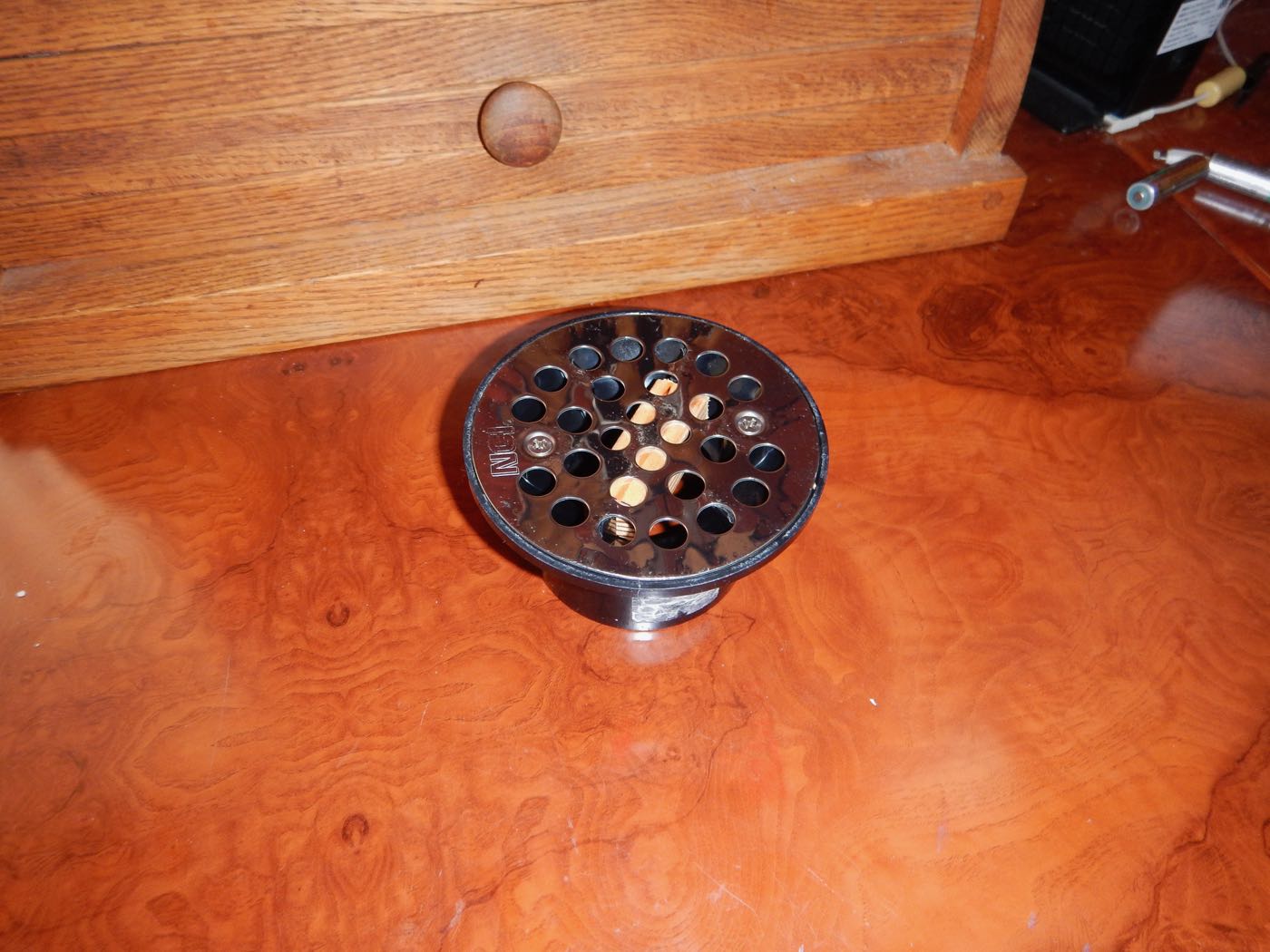

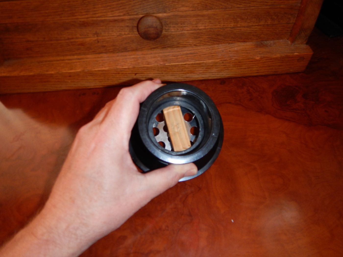

Start with a floor drain.
Add a piece of wood between the drain cover and and the bottom disk to keep the disk from bowing.

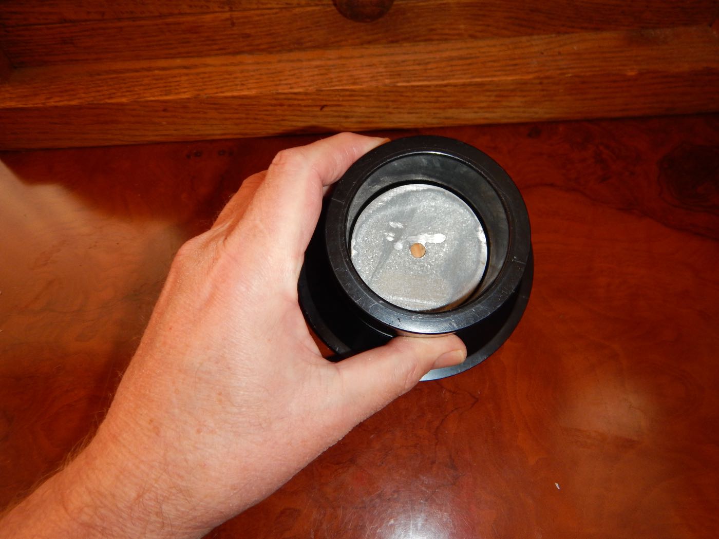

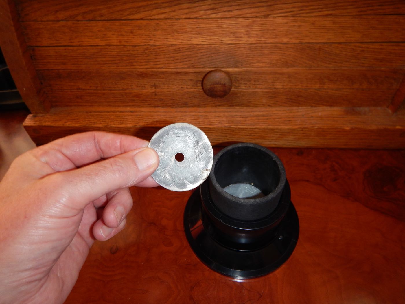

Insert bottom metal disk. This has been sprayed and allowed to dry.

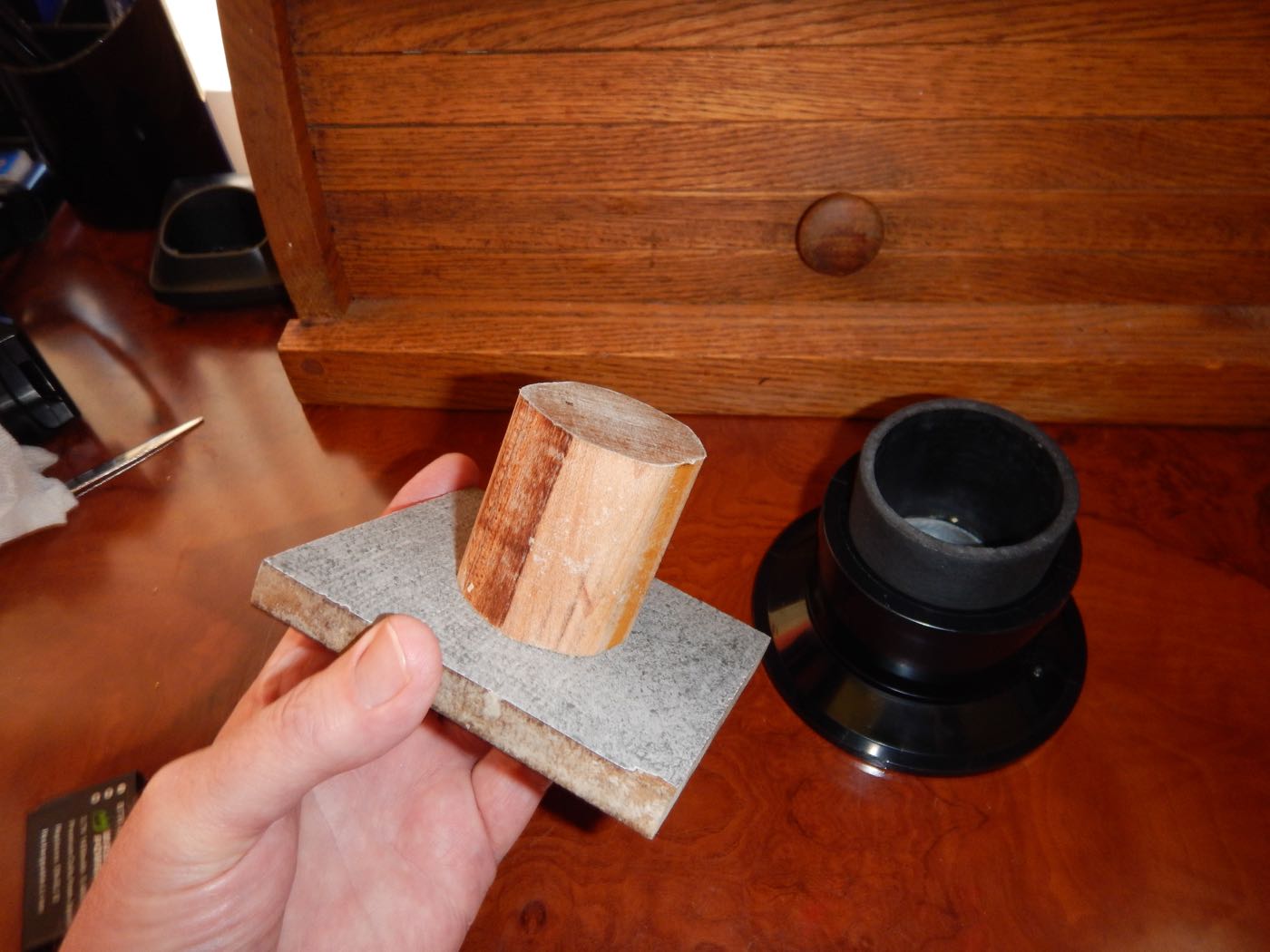

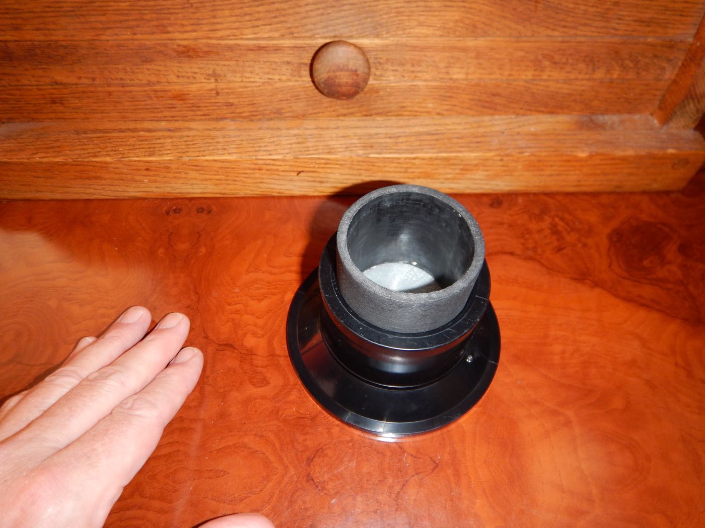

Insert the sleeve. This allows for extraction.
Add your sawdust and starch mixture.
Add the top disk. This has also been sprayed and allowed to dry.

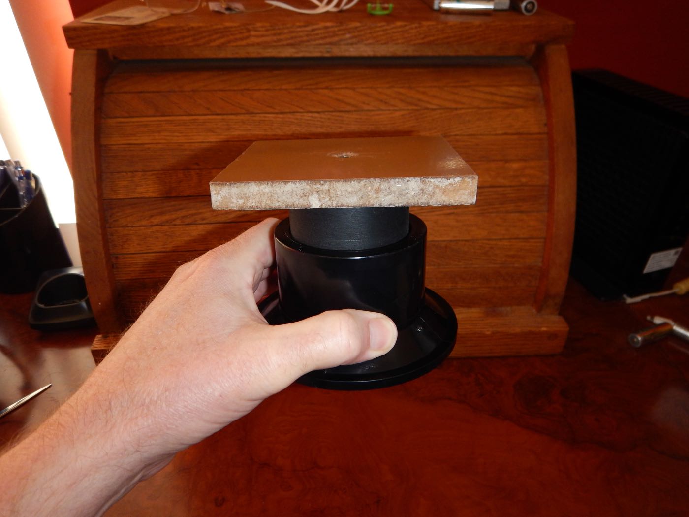

Insert the ram into the sleeve. The ram is just the right length for pressing after the mixture is added to the chamber.
Place into vice and press.

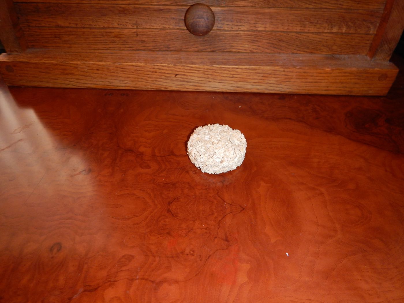

Remove the drain and use the ram to push out the puck.
Put them on a rack to dry.

That's not a quaker, but a puritan.Looks just like Quaker Oats rice cakes!
