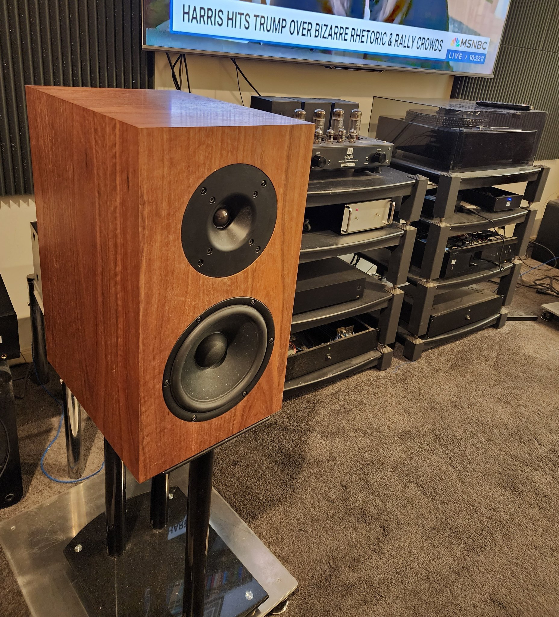

Below is a commercial speaker using the Satori 7.5" in what we might call 1 cubic footer (23L internal). It has good surface area all round without being a big speaker and decent baffle size. The tactile bass this speaker it is capable of just cannot be matched by 5.25" main driver plus dome tweeter a la LS3/5A. Actually, just now toying with the name, maybe call it NHØP, pronounced NiHOP after the late Niels-Henning Ørsted Petersen. 😎
Anybody wishing to come around to have a listen, please do. I am particularly proud of this design, the inductor drive idea has been pushed further than I have done before (and I hate the drive word, this is more about current delivery). This thing has the most boxless sound!

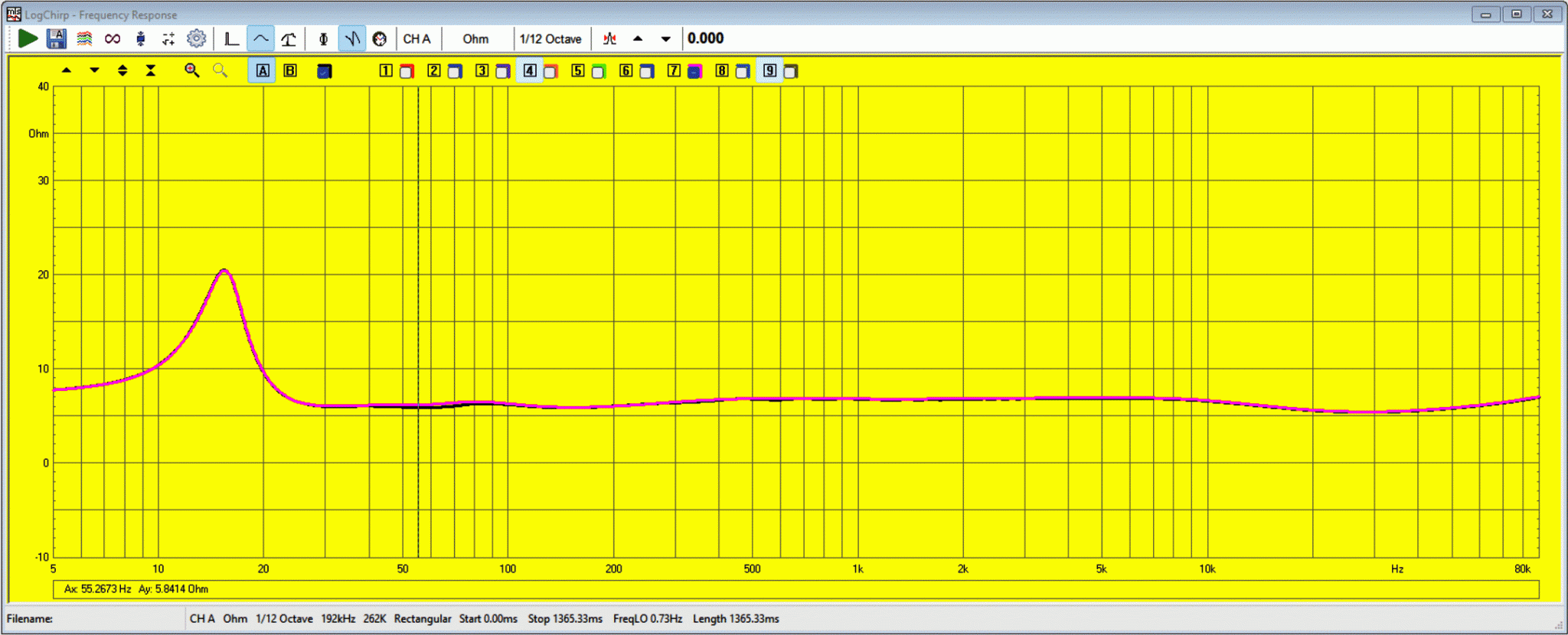

Below is the in-room response, two speakers summed at the listening position, so it includes room imperfections:

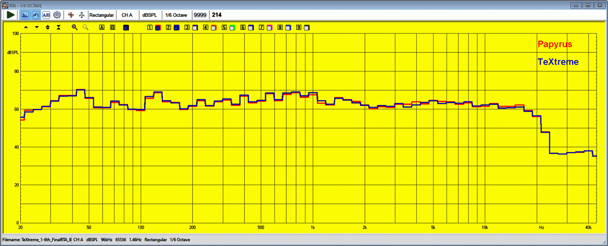

There is a hint of 'BBC Dip' in the response. Two versions of the speaker, Satori Papyrus and Satori Textreme, the latter will set you back a $500 premium.

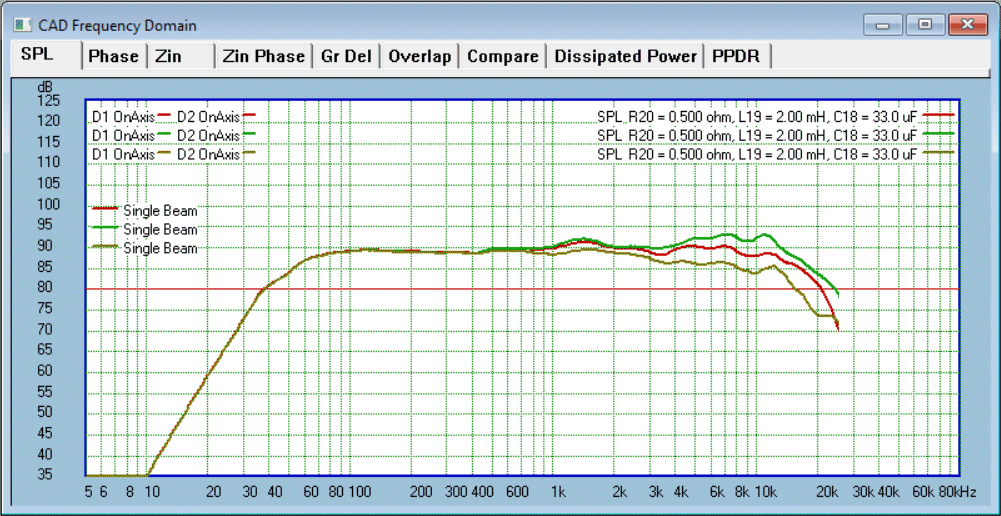

The 'Dip' was not intended, it really comes down to the main driver behaviour, that kink in the response around 3KHz before the on axis response rises, but rises much less as you go off axis. It completely disappears by 30°. Carefully balancing things, I have ended up with a massive single 1.8mH inductor on the 7.5" main driver. This is more than ten times the non-linear inductance of the driver at a critical 2KHz. This gives you current-drive type benefits with any amplifier. The main advantage of so-called '"current-drive" is not that it controls the current, rather that the driver imperfections don't mess up the current of the amplifier. I believe that what "current-drive" does is being misunderstood. The main benefit is isolation and that we have a mixer at work. It is hard to explain, but I am sticking to it.
Below: The On and Off Axis Family - from SoundEasy:
Green On Axis. Red (preferred) 15° Off Axis and Olive Green 30°.

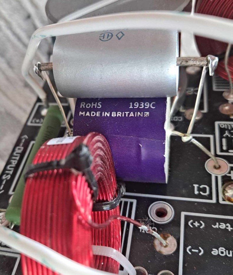

What do you guys think of a foil inductor in the L2 position? I want to upgrade the standard air core inductor with something nicer. There seems to be a variety of options. Let me know if any of you guys have experience with them
Mundorfs 16awg
Mundorf Pure Copper Paper foil
Alpha Core 14awg
Geortz 14awg
Janzten Wax foil 16awg
Janzten 16arg

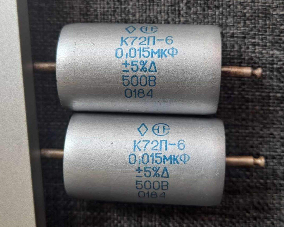

BTW, I finished my Elsinore's to the point that I can listen to them. They are opening up over time. I bypassed the 1.8uF tweeter Clarity CSA cap with a Russian teflon film foil cap that I had. The highs are quite nice on these speakers. So I am getting a bit of upgrad'itus...
The only thing remaining with the construction is the risers. Still waiting on parts for that. I am also thinking to try sorbothane between the pucks and the risers to isolate.
For those who are not familiar with this, it is not about bass extension or bass quantity. It is about balance and consistency through managing room modes.
Can't disagree with that!
Yes, you can certainly try that and L2 is the obvious one to try. I don't think we have had a report of somebody trying both. I admit being old-school and I have been using Jantzen air core here and L1 4mH (or 3mH in the ULD I seem to recall) I use P-Core. The Black PCB accommodates the air core well, an foil version with similar DC resistance is a fair bit bigger, as far as I have been able to tell. So it would be needed to wire it off the PCB.
I am going to give it a shot. It looks like there is a decent amount of space around L2. The wax and different resins in some of the foil inductors are supposed to reduce microphonics supposedly. Janzten seems like a good value. The infused inductors are not all that more expensive than standard ones.
Also, the Russian caps seem to be doing something really great to the sound. I feel as though I am getting a lot of detail. They are pretty inexpensive and not too difficult to attach with some extra wire lead onto the existing 1.8uF cap.
