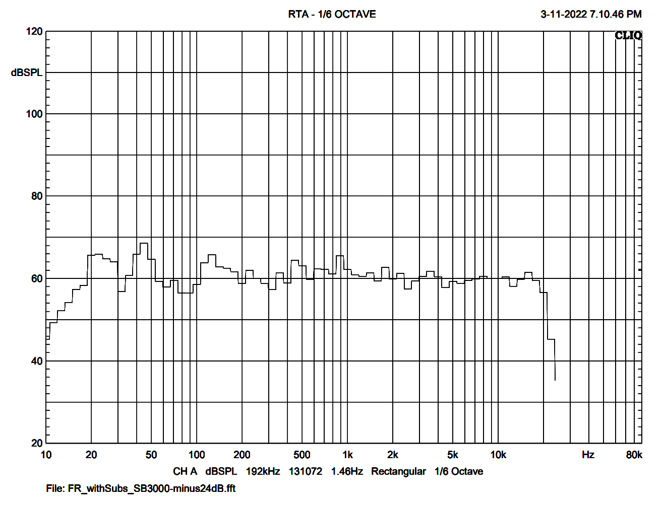

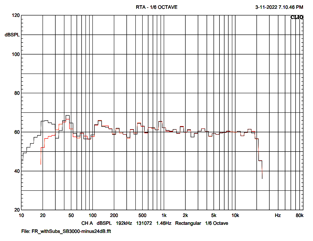

Basically I just use pink noise 1/6th Octave and microphone at the listening position. Below is an example of ULD Elsinores and twin SB-3000 subs nicely integrated. I do have a peak at 45Hz and 120Hz with a trough centered around 80Hz. These generally show up with other speakers as well. In this instance the subs are only really working below 30Hz.
With and without subs:
