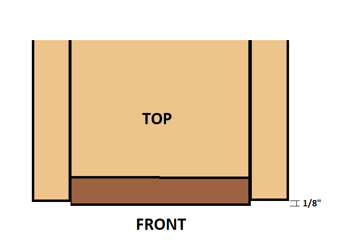

The sides are going to be Baltic birch and I was thinking of two things I could do to make the baffle more interesting. Looking at the attachment, I am thinking if set the side panels back say 3/16" or 1/8" that would be a nice little detail to separate the side panel end grain from the baffle with a little reveal. Do you think this would be too much edge diffraction? If so, I can nix the idea and just make things flush.

Mikerodrig27,
Joe stated earlier in the thread that he designed the Elsinores with a flat baffle to make it easy for DIY builders.
Our understanding is that chamfers/round overs/bevels on the sides of the baffle can help reduce the diffraction signature; again to be effective, they would need to be of a minimum size... possibly 1/2" chamfers don't help much, but probably they will not hurt. Bigger round over/chamfer might be better, but it should not make the effective baffle width narrower.
The way you are thinking of putting the baffle slightly recessed in relation to sides can make it look nice; also easy to fit the grills? 🙂 Many loudspeakers of the 70s and 80s had that aesthetic. But it is likely it will be a slight detriment to the diffraction - though the actual effect might not be very perceptible.

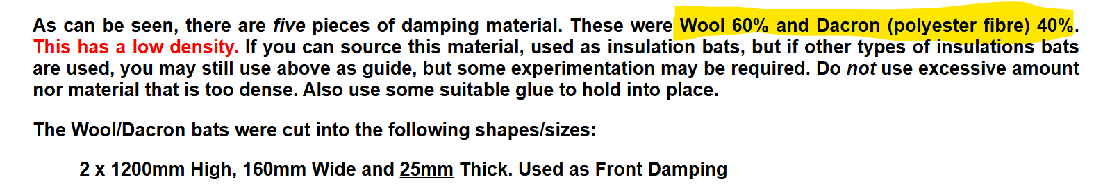

Another question for everybody in the USA. I am looking into the stuffing for the Elsinore's and would like to figure out where people are sourcing their stuffing from. I started looking around online with not much luck. I am getting ready to assemble the cabinets and would like to pre stuff a lot of them before closing them up.

Yes, that makes sense. And If/when he responds, I suspect there will be this reaction :headbash: and the thought "how many times do I have to tell these people to leave the baffle as is..." ha ha. Duly noted...
In the past, he has said that a small roundover on the edge is acceptable as a means to increase the aesthetic. Something like a 6mm if I remember correctly. In this case, I will not be using a roundover. I also saw his notes on the baffle width and how the crossover would have to change to accommodate a different baffle whicn brings a few compramises.
I will skip the detail I talked about in my previous post. Sound comes first. I want to experience the Elsinore's in all their glory.

Mikerodrig27:
I finished my Elsinores more than 6 years ago (time really does fly) and used a combination of 1" batting from Meniscus and 2" insulation (humanely made from recycled denim) called UltraTouch, which I purchased at my local Home Depot. Meniscus went out of business last year but UltraTouch still appears to be available -- indeed, I found several ads for 3.5" thick UltraTouch in a quick google search. You can undoubtedly find other thicknesses. Great stuff, highly recommended.
Scott
SRMcGee, I remember meniscus shutting down shop. From what I understand, the business was doing well but they were wanting to sell or just shut down shop as it was just time... They were a great company. I had received some really impressive customer service from them.
It looks like Joe also talks about low density pure poly batting as well. I see the UltraTouch material. Rockwool looks tempting but I suspect it is far too dense even though it has great absorption qualities. The density seems to be of the biggest concern. I feel like fiberglass would work but with this being a ported cabinet, I don't know if that is the best idea... lol. I don't mind having extra batting material as I am going to make some more acoustic panels soon as well.
